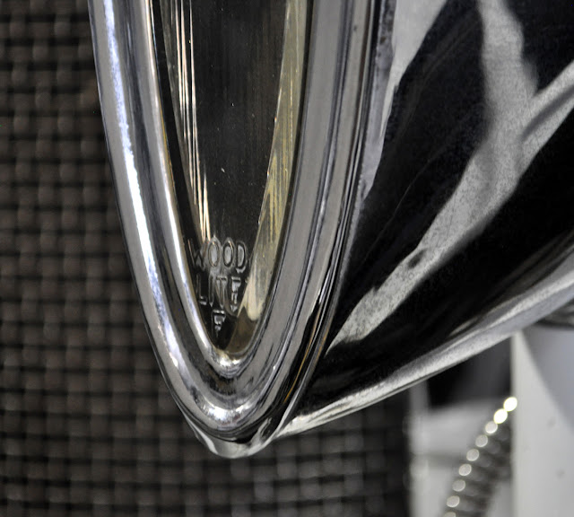

    Best I could find was this one with early Packard grill and E&Js, and not Woodlite headlamps. Dim and useless, but looking at them in a design perspective, the best looking headlight for classic cars
