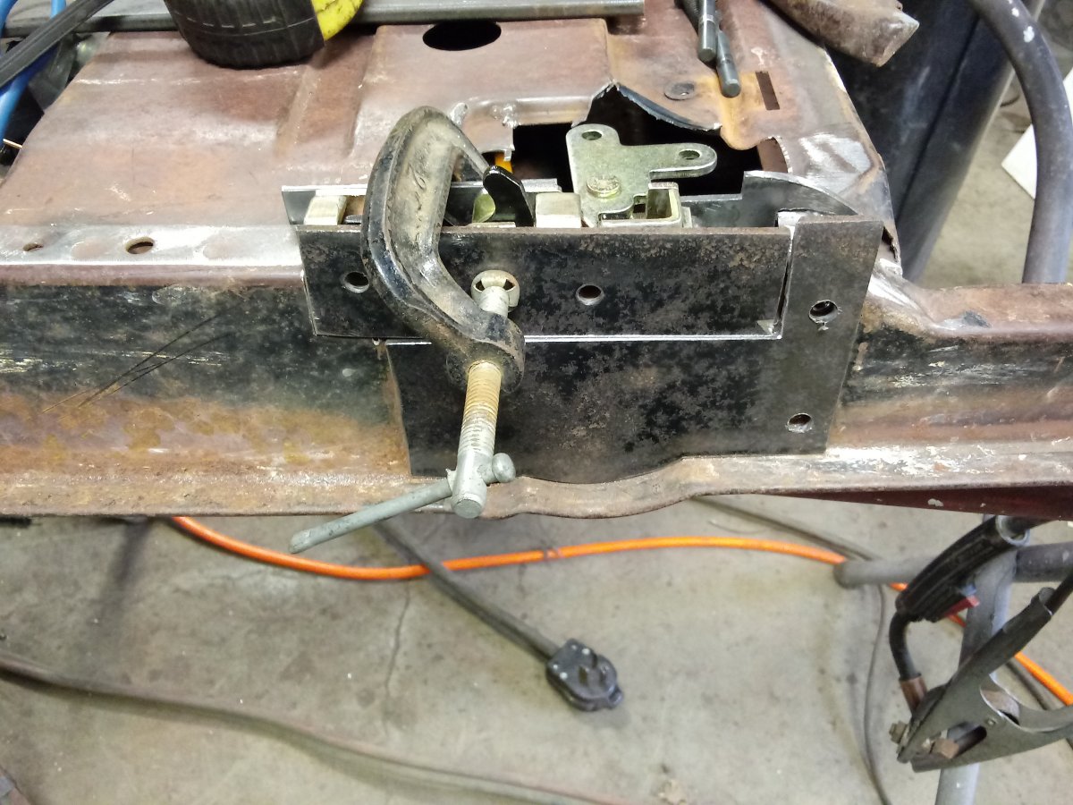

    So the first step was to remove enough of the inner door to get inside.
    I decided to build an inner plate that will actually weld to the door and I'll fill in the hole I created up to this plate.
    The latch will actually be sandwiched between 2 pieces, the inner plate and an outer.
    So I got the plate built and fit. I drilled out the threads in the latches as the bolts will now run thru the latch and screw into the 1/8" welded inner plate.
    fiftyv8 and 31Vicky with a hemi like this.

    The plate is made so that the latch will slide in and out of this plate and this was one of those design "fights". I couldn't get happy with a way to remove and replace the latch, should I need too, without total disassembly or cutting door open.
    So I cut the end of the door down even with the window track. The latch will actually sit on the window channel.
    This gave me a location for the latch both inside and out.
    tb33anda3rd and fiftyv8 like this.

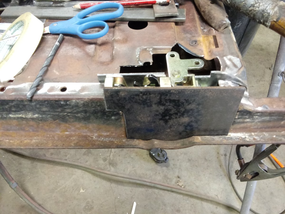

    Part 2:
    Ok game plan for inner plate seems to be working so on to part 2.
    Next I had to figure out how to create this sandwich design I wanted. Sandwich why? For strength. I wanted enough strength built into it for safety, protection, and to keep it from stress cracking.
    I decided to use the factory area were a plate is used. Difference is I'll make the plate bigger to mount thru the latch too.
    So I built an outside plate to sandwich it and this worked well except its angled in that mounting location and it tilted my latch and I can't have that!! So I cut a slab out of the side plate.
    Next step is to bolt the latch to the inner plate and outer slab I cut off, then I'll bolt the outer plate on the door, set latch in place and tack weld in position on the outer slab to outer plate and the inner plate to the door.

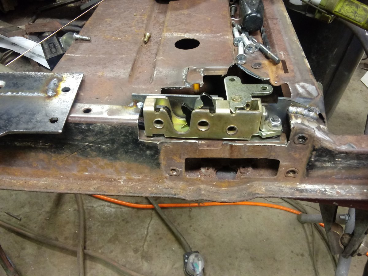

    Now I'm to this point in the last post.
    Understand that there will be a piece of metal over the top of the latch were the door peter engages. The latch will be totally hidden other than the slot for the door peter.
    So once done, to remove the latch assembly you will unscrew the 3 bolts thru the side plate and latch assembly then the other 3 bolts thru the rest of the side plate and remove that side plate.
    Pull door panel, unhook door handle and lock and the latch will slide out straight back out of the door.

  12. lostone
    Joined: Oct 13, 2013
    Posts: 2,879
    lostone
    from kansas
    I got a little further tonight, some more bo diddley, some buddy Holly and some cussing and I'm really happy with the way its going.
    2 things to note, 1- the latch extends 1/2" off of the door so its not too terrible in size. 2- initially I was going to stick the latch a little further back on the door. The idea was if I let the latch hang outside the door a little more that I could shorten the door peter and like stated above help alleviate getting caught on this.
    My problem with #2 and allowing it to stick out was the fact that I flush fit the doors so this adds an extra step for me. Door seals!! I need room for door seals and way to mount them. Soooo I moved the latch as flush with the door to allow plenty of room for door seals and mounts (think I have that figured out too).

    I got the holes drilled and the nuts welded onto the back side of the inner plate. At which point I bolted it all together and set it into place. It fit good so a couple tacks and disassembly to make sure the design is feasible and glad to say it is.
    I got the outer plate welded together, inner plate welded to door, bolts lining up and then after welding it didn't want to fit..... Crap ! Now what?! After some taking apart, putting together 2 or 3 times it dawned on me the weld on the back side of the plate was hitting the door. After grinding the weld lo and behold it fit again.
    Anyway below are the pics of how its coming together and coming apart.
