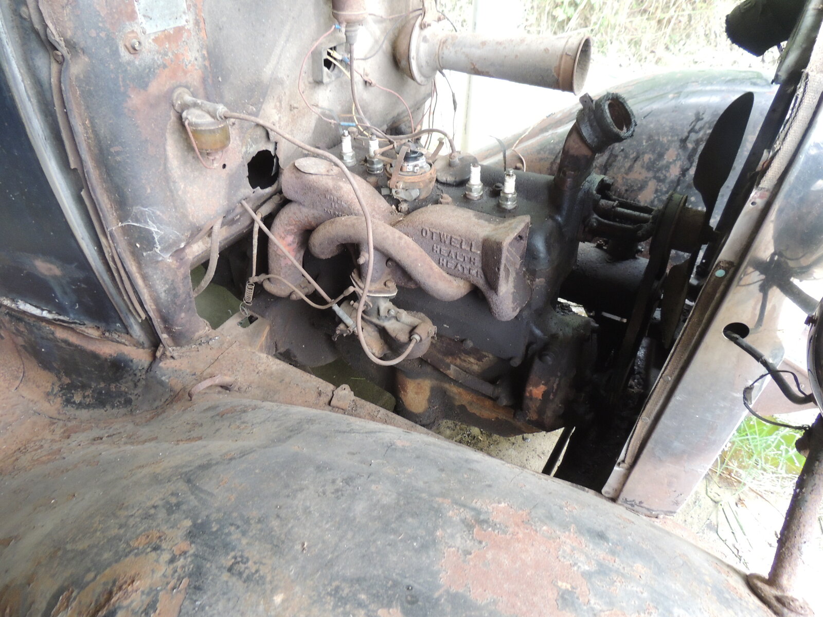

    I purchased a 1930 Model A 5 window coupe. My understanding is that the VIN # is on the engine block. The number on the block does not match the title and I suspect it might be a 1932 engine because it has an 18 at the start of the number and a star before and after the number. It also has an Otwell Health Heater.

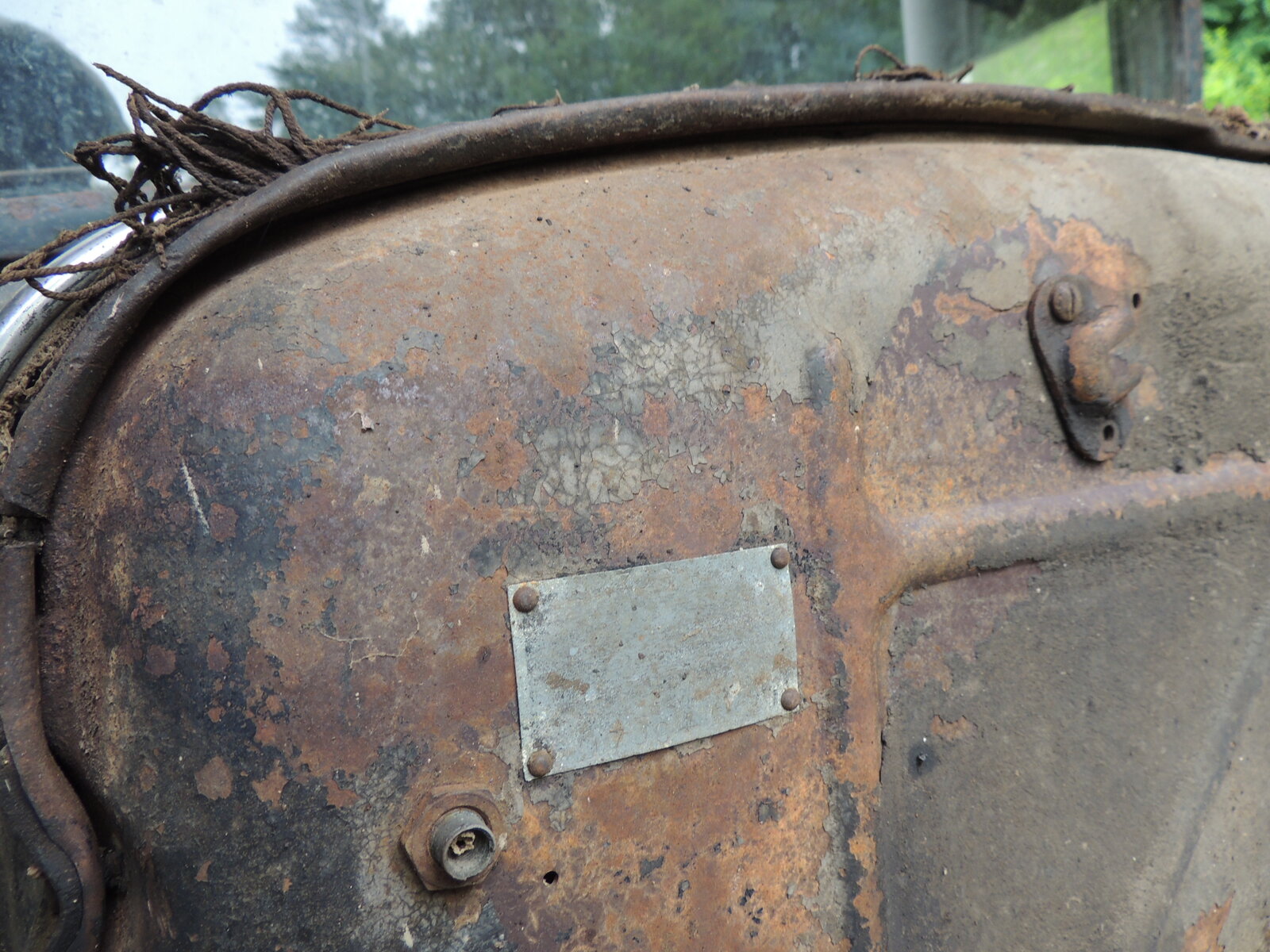

    Also there is an unreadable tag on the passenger side firewall . Does anyone know what it is or what its supposed to say? DSCN3850.JPG

    the firewall tag just lists the patent numbers, it's nothing to do with a vehicle ID number of any kind.

    The tag is a patent plate, it shows patents pertaining to the automobile.

    It is a Model A data plate. They are generic to all Model A's.

    I have read some conflicting information about other possible locations for ID numbers. Seems to be variations as to what was done and when at different manufacturing locations. I plan to resell the car body and chassis, so I don't want to get into removing a lot of rusty bolts. Does the Otwell Health Heater signify that the engine is from a later model?

    that looks like a model"A" engine to me, a `32 4cyl would have a fuel pump on that side of the engine block.
    A `32 v8 engine would have a # 18-*** on the transmission, nothing stamped on the engine block.
    That heater is an add on accessory

    The firewall looks to be 30 or early 31 as it does not have the indent for the fuel bowl that later 31 firewalls had.
    This being the firewall on the Vicky I had.
    The extra tag on it was the body number tag but wasn't the vehicle serial number.

    Can you post a picture of the engine number. All Model A engines had a star before and after the number. As for the 18, it should not be there. After February 18th, 1931 Ford changed the style of the 1, 6 and 9 numbers. If you provide the number, I can tell you the production date of the motor regardless if it's correct or not. The only exact way of identifying your frame is to lift the body.

    I plan to sell the body and chassis for "Parts" with a Bill of Sale. Its kind of a funny thing, this hobby we have chosen. Many people want an A coupe body, but they replace the engine with a later model and quite often, they replace the frame with one for a 32 Ford that is actually not a real OEM one. At that point, they have a body with no factory VIN and a chassis and engine also without the original factory VIN.
    On the other hand though, someone wanting to restore one or build a period perfect Hot Rod would probably want the matching numbers. It kind of depends on what someone is looking for. In my case, I already know that the engine in the car does not match the paperwork. Don't know if the frame matches or not. Here is a picture of the number that is stamped on the engine. My understanding is that ALL 1932 engines came with an 18 at the beginning of the engine number......and ALL had a "star" stamped before and after the number. I "think" I saw something somewhere saying that earlier motors may have had the stars as well. Again, my research on this is pretty spotty, so I don't know what I have enginewise.
    I believe the body is a 30 model though that may have been manufactured in May. The firewall only has the one data plate and doesn't have the indentation some later ones have.(Tks Mr48Chev) If you look closely at the picture, you can see the stars at each end of the number.

    The 18 you’re referring to isn’t related to 1932 model 18, it is the numbering showing 18th million 97944 engine built. So the engine was built in July 1929.

    1 million 897 thousand 944th engine built.

    Agreed, not a B, but rather a retrofitted '29 engine. No provision for a fuel pump, and a 4-bolt water pump (B would have 3).

    So its just co-incidental that this engine has an "18" in its serial number? And all Model A engines had the "Stars" even before the 32 and later engines ? Am I getting that right?

    Correct. Model A's had the star and this IS a July 1929 engine.

    I was too quick typing, as others noted it’s the 1 millionth 800 thousand not 18 millionth

    You have to remember that there were over 5 million Model A Fords built. It looks like your '30/'31 needed an engine at one time and a July '29 engine was installed. Your situation is not uncommon. I have owned several Model A's and a couple had the wrong engine for the model year. The '29 Business Coupe that I have now did not have the correct engine number, but it does now. Back in the '40s, you could go to any junkyard in the U.S. and pick up a decent running Model A for $20. You need to lift the body, if the frame number matches your title, then your go to go. If it does not match you are in a bind.
