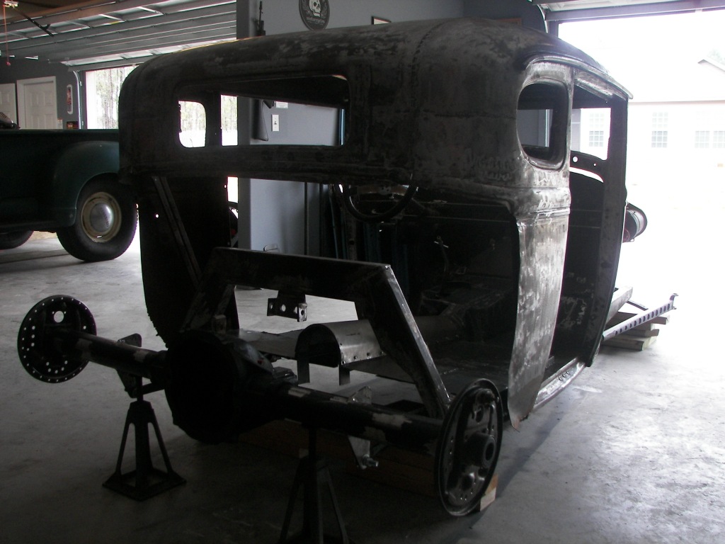

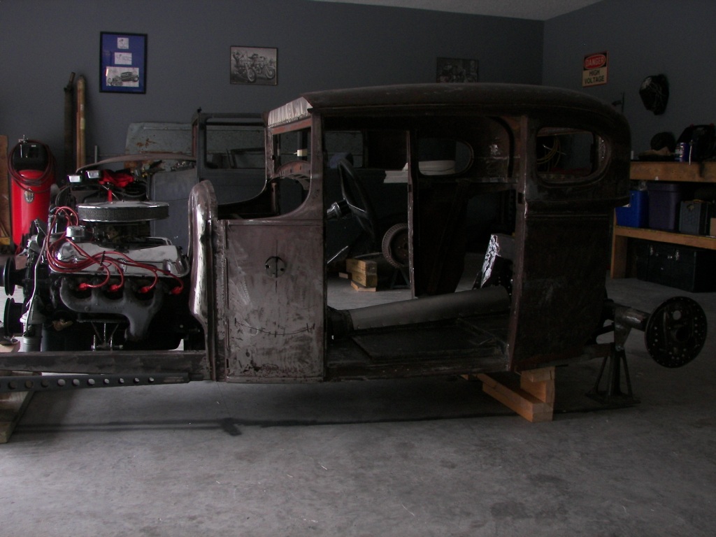

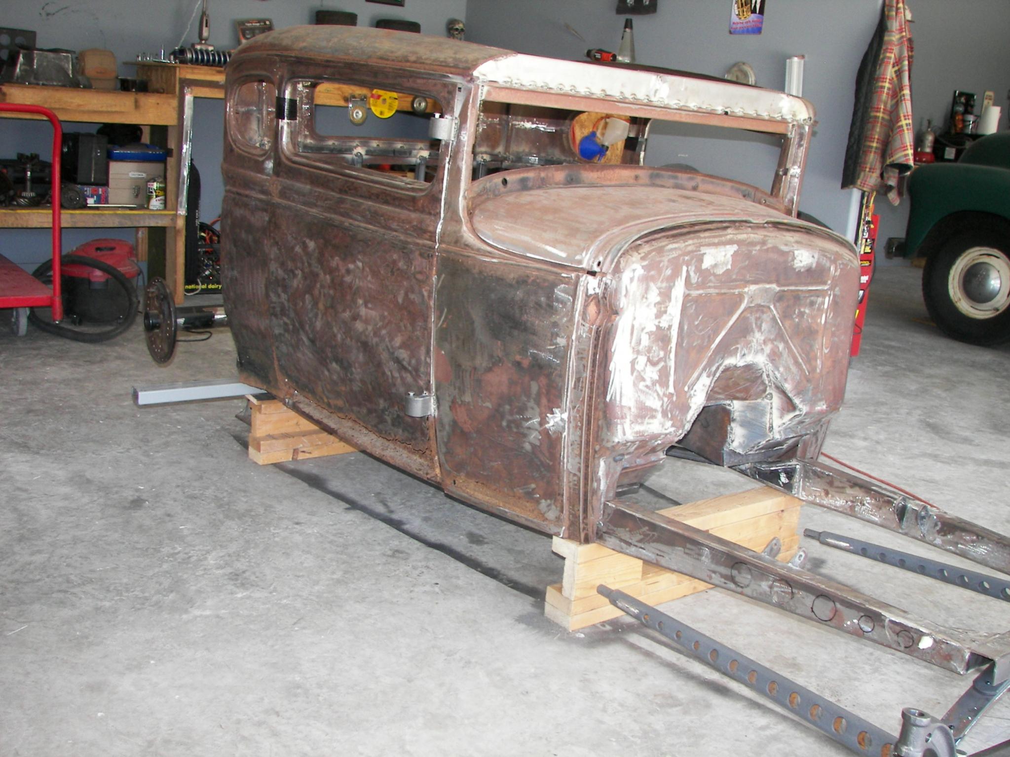

    I bought this body about 3 years ago and have slowly worked on it over that amount of time. Packing up and moving to Austin and then back to Georgia in the same year didnt help get the progress any farther along.
    I bought this car along with the 29 sedan in the back ground from the rufus ranch in brainerd, MN for a total of $1800.
    The rear end of the coupe was pretty much rotten off so I cut it off and sold it to a guy in Oregon and thanks to him, that gave me enough money to buy the wish bones, front and back and the rear differential. I chopped the top 7" and then bought 2 sticks of 2x4 tubing and channeled the car 2" so there was still some sort of room inside.
    I am not trying to remake or copy the PPE!!
    I took the tubing and pie cut 2 " in the front and welded it back together then cut the top of the frame off so that the part under the body is only 2 " that way I didnt have to cut the floor and braces out.
    I searched endlessly for a good deal on an engine and transmission and finally found a 1964 260ci ford engine out of a falcon with only 10,000 original miles on it and a top loader 4 speed for the great price of $1500.00
    It has a F-100 steering box set up for cowl steering. All of my wires, brake lines and fuel lines are inside the frames so there will be nothing showing. The battery will be under that dash and I am using a set of floor mounted pedals out of a dune buggy. I am running drum brakes at all 4 corners.
    I am now waiting on the funds to finish the back end of the body and get my front end set up and my tires and wheels.
    I am searching for a dropped and drilled axle and the usual 1937-41 spindles for cheaper than new.

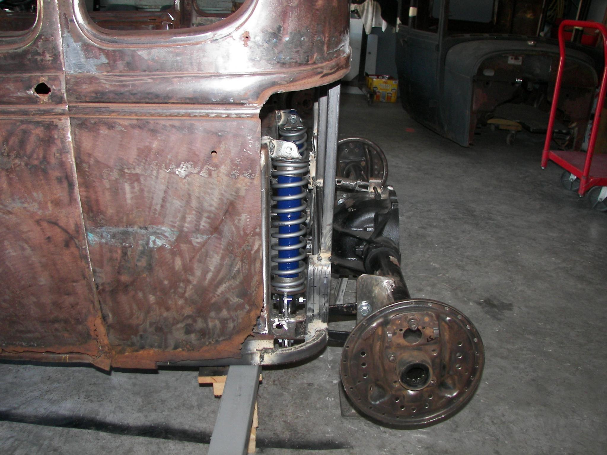

    So it has been a while since I last posted, well even worked on my coupe. I have been really busy with building a bike (posted a pic), life, the kids and everything else that goes with it all. I have since added my front axle, rear coil overs and put the doors on with new hinges. I also ran my fuel line, electrical and brake lines inside the frame and closed it all up so it will be clean. If they leak then it will go on the outside and I can say " it sounded like a good idea at the time":eek: Time to clean it all up and send the frame out to get smoothed up and primed. I am thinking about the Roth Blue metal flake for the frame and the body and the axle and rear end parts will be the Roth black metal flake.

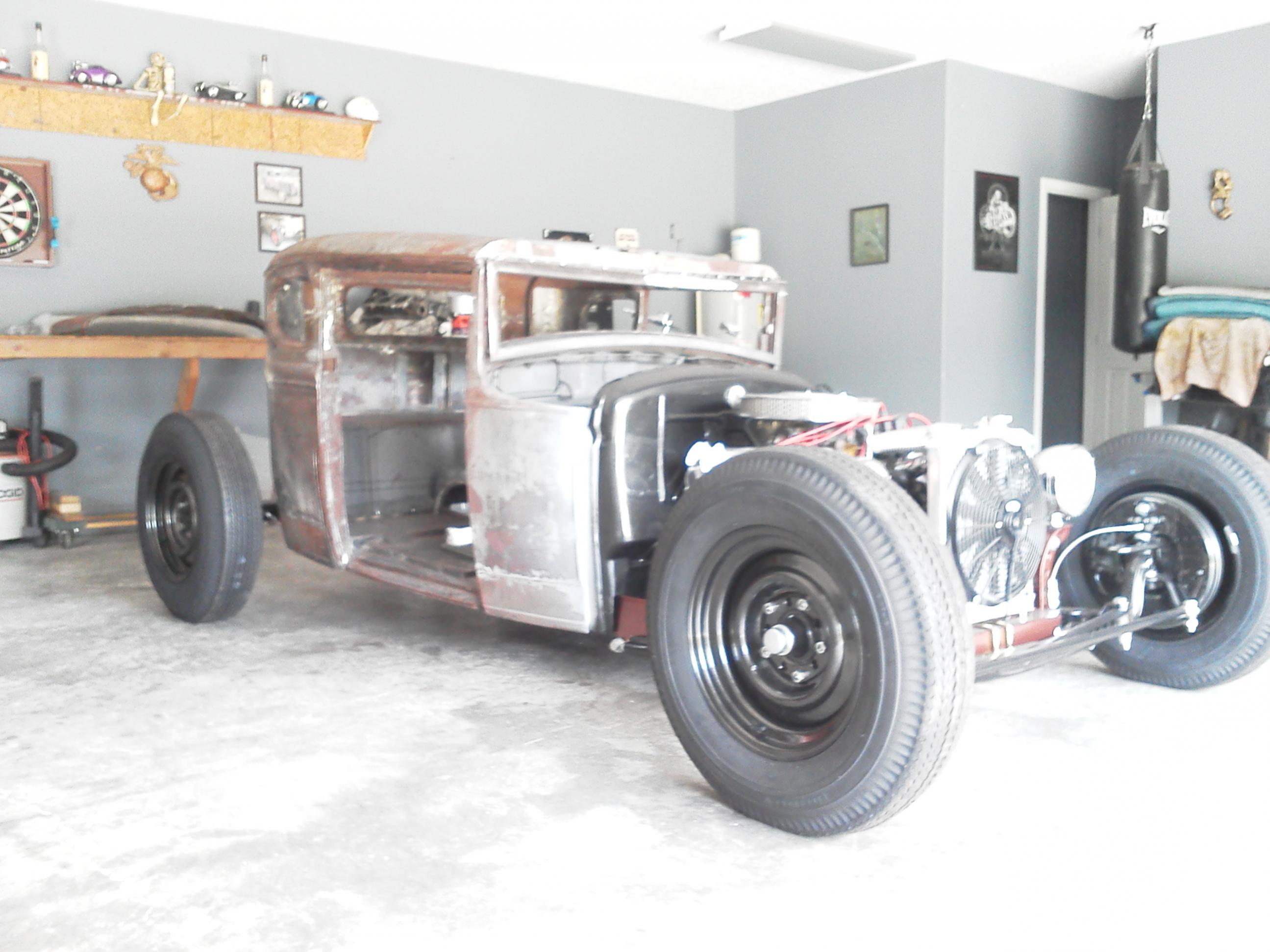

    Havent had much time to work on the coupe over the last year or so .... life, kids and deployments take a toll for time. I did take the last month or so and tried to knock out some issues. I got the back of the car wrapped, was going to use an old sedan but that didnt line up so I got some 16 ga. and went to town. I filled in the middle section with some louvered panels and wrapped the inside also. I put together a gas tank, got the grill shell and the radiator mounted. The wheels and tires are just for mock up and not mounted up front...waiting on funds to buy the spindles, hubs and brakes.
