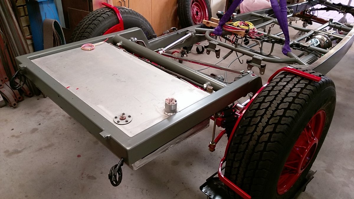

    I stuck a Geo Metro tank behind the seat of my '27. The first pic is where it sat at original mock-up. Second pic is after I lowered it 8". I could still lower it another 6" if I wanted to. Pretty easy really, 1" square tubing is all it took.
