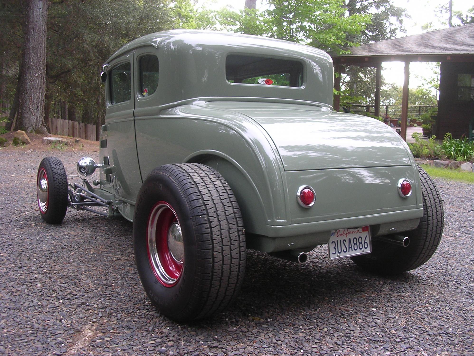

    I have had a few requests to build rear roll pans like the one pictured here. So Im going to get the air hammer going tomorrow and roll up some end plates. Planning on making 6 or so rear roll pans for 30/31 model A Fords. Im not sure how different the 28 thru 29's are so im just saying they will fit the 30 31's nicely. If your interested in one let me know and I can fill ya in on the details. They are all built out of 18 ga. hand formed sheet metal and primer ed. Bead lines are an option as some like them smooth. They bolt up through the top of the roll pan through lip on the rear lower body sub frame. Holes will need to be drilled to match your existing holes or I can drill the pan and you can drill your sub frame. Thanks M.T.
    A few pics I received the other day from 48fordnut that I sent him a while ago. No Bondo has been added yet.

    Nice pan Metaltwister how far down does that hang? I may be interested in one.
  12. Metaltwister
    Joined: Jul 10, 2007
    Posts: 873
    Metaltwister
    I can make it hang down any length but 4.5 to 6" look the best I think. Haven't done any much more than that yet? :eek: If your full fendered from the lower back edge of the body to where it touches the inside edge of the finder slope is about 5 inches. That is what I have found looks the best. Fender-less could be whatever in length.

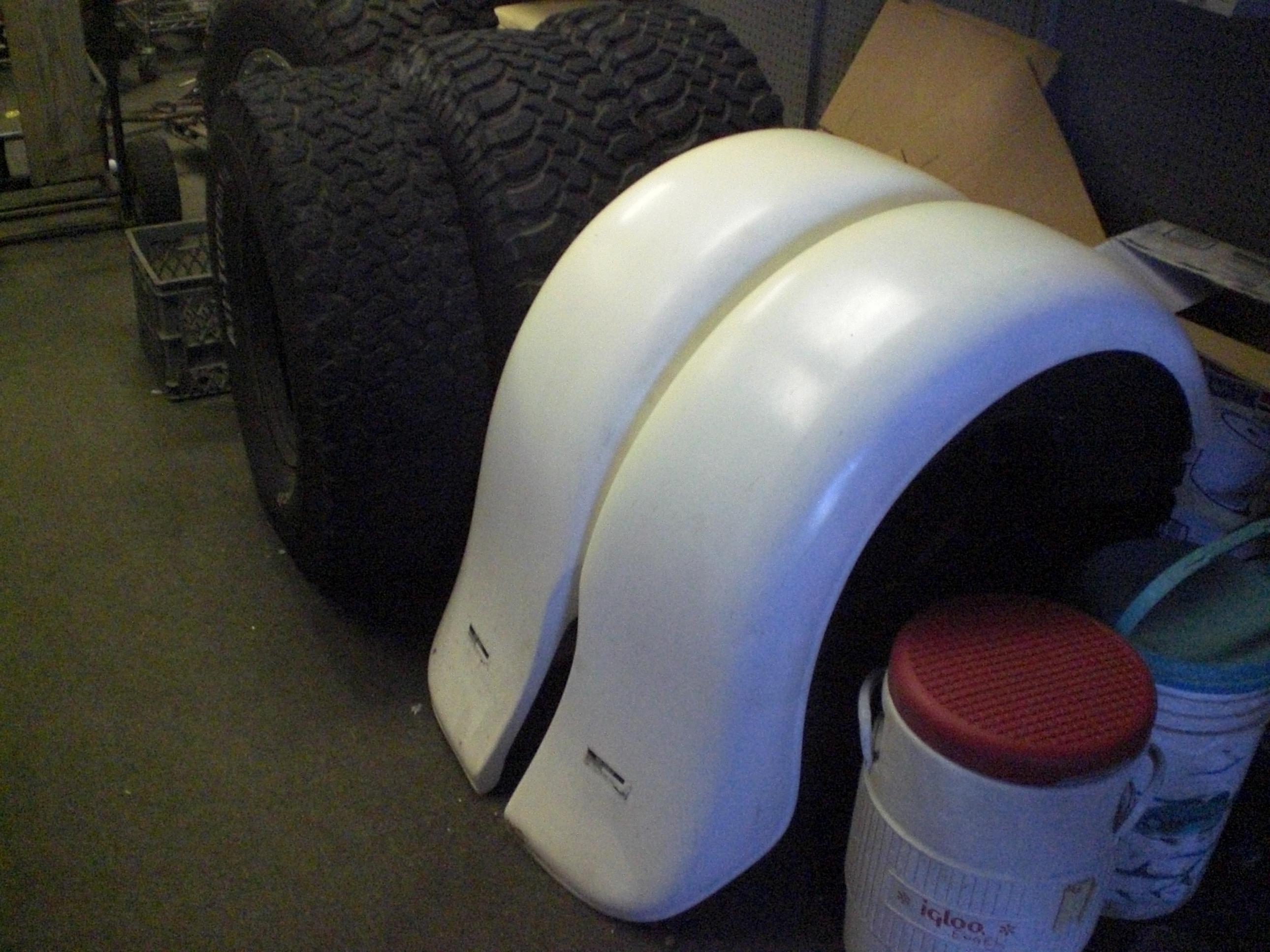

    Its the only sharp edge on the whole car and and being all the way across the back its a bit distracting to me. Humm, Guessing you should add some new full length fenders first then see how far down the new body roll would look best. I just happen to have a brand new set of 33-34 Chevy fiberglass fenders 3" wider than stock Id like to find a good home for. :rolleyes: they still have the stickers on them! :D
    Edited... Sorry Jim I didn't mean it to come out that way! :eek:
