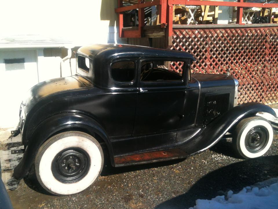

    I was thinking about this. one week i like the look of A's with fenders and a month later not so much. has anyone ever trimmed back there front fender and running board flanges. made the running board brackets unbolt from the frame? I really dont want to unbolt and move body around to change the look of things, just a thought. any input?

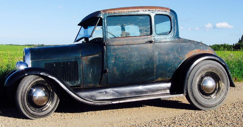

    How about something like this? An in between look with bobbed fenders that can be easily removed?

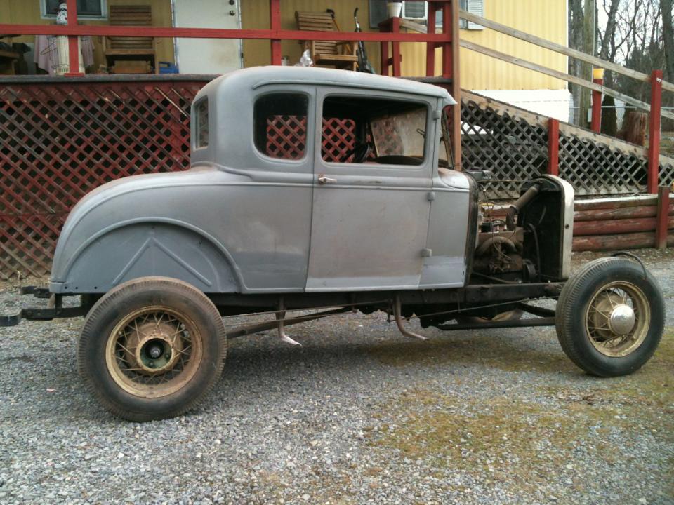

    did it... slotted aprons... bolted on running board brackets. 13 bolts per side. comes off in one unit.

    car will drop 3 more inches when funds are available. it takes 10 minutes per side to remove.
