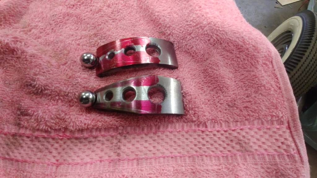

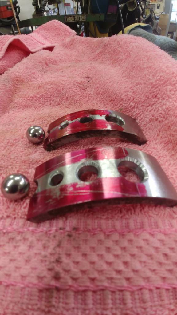

    Started with a 5" dia. Schedule 80 pipe.
    Sliced a section out. Found a couple of 1/2" dia. ball bearing.
    Just got them back from the Plater today. 0424201625.jpeg 0424201628.jpeg 0608202005.jpeg

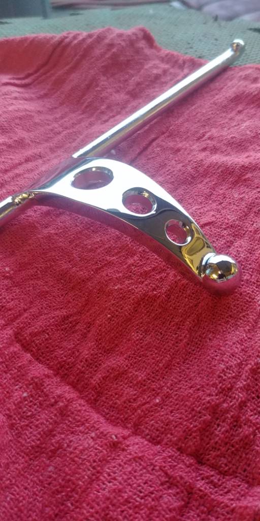

    Cost me $100 for the pair.

    Inside handles that lift.

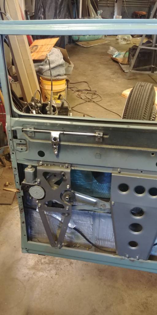

    Obviously need to finish, but this an installed shot.
    I know...I know! Sacrilege electric windows!
    Guts out of some Toyota, very thin motors with balls.
    Used slider door contacts out of Dodge Caravan.
    I'm in my shame corner now. Sorry guys
