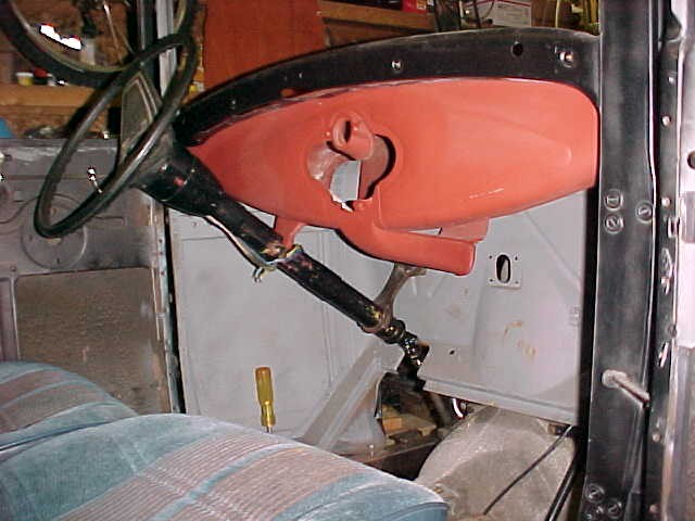

    I cut much of the bottom out of the tank on my '30 -- but why cut it all out? See the photo.....
    By the way, the lower steering tube mount attached to the firewall is a late '31 Model A column drop.

    This is a pic of a late 31 column drop(they attached to the top lip of the tank instead of the bottom) next to another one that I modified to fit a 28-29 tank.Ford made this change in 31 due to fuel leak problems .

    Damn,there's a lot goin on under there:D
