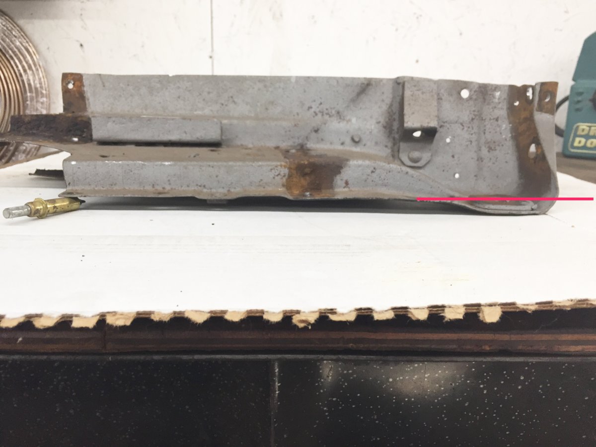

    IMG_1941.JPG Did a quick search on here and didn't see anything on the subject. I thought I remembered seeing it done on here , Rolf maybe? Has anyone flattened out the cowl feet on a 30-31 Model A on deuce rails to give the front of the cowl a slight mini channel? I think it also helps with the gap you get when you put a model A on a 32 frame. If I flatten it where I have the red line drawn in the pic the bottom of the body will slightly hang over the frame.
  2. Are your rails pinched? If not you may have to pie cut the firewall to gain the width to be able to set the body down over the rail. Usually 1/2 inch or so but it helps get rid of the shadow line along the body as you look toward the rear wheels.

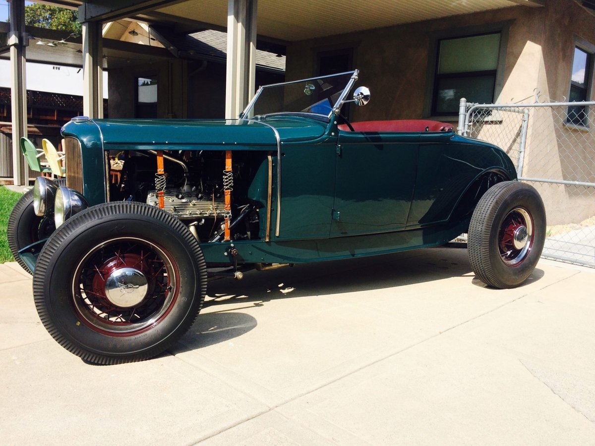

  3. Here is a 31 that @Flop did a while back that shows the pie cut
    mgtstumpy and kidcampbell71 like this.

    Flop
    That’s what you ya have to do to get the body to sit down flat.

    31Apickup
    I did mine straight across as you show, worked perfect. I can post pictures tonight

    Mini channel, not mini channel, frame pinch whatever. I'm not going to get in a pissing match about what it's called. I just want to know the best way to go about it.

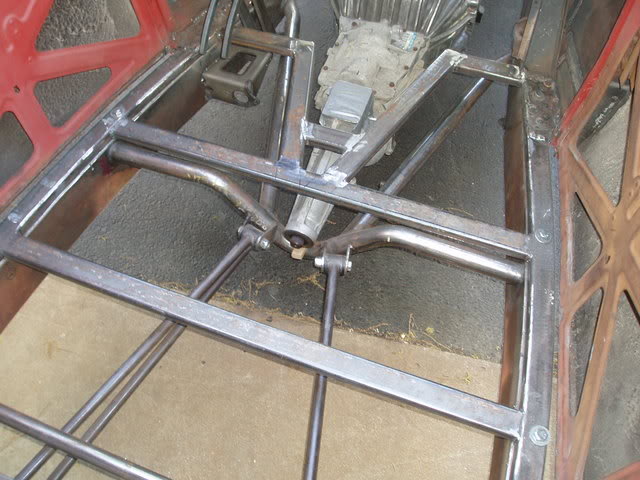

    The way you show it in your picture is how I'm doing mine, from research on the HAMB most guys do it that way, that's the easy part. The hard part, for me anyway, is modifying the rear sub-rails to flow with the frame and tie it all back into the body. I refuse to purchase high dollar, fancy sub-rail kits, instead, I'm fabbing my own parts out of heavy gage sheet metal using common everyday hand tools, just the way everybody did it before weld in or bolt on parts existed. I think have some saved threads at home on the tablet regarding your question as well as mounting an A body on 32 rails, if you want I can post the links later today, there is some good info there.
    blackjack likes this.
  13. My car (A Vicky) has a 3/4 inch mini channel that goes from the cowl to the back of the body. I reinforced the body and removed all of the original wood subrails. Then I built 1x2 square tubing subrails using the frame as a jig, lowered the body over the frame/new subrail assembly and welded the body to the new subrails. I'm not looking for kudos, I'm just trying to help the OP.

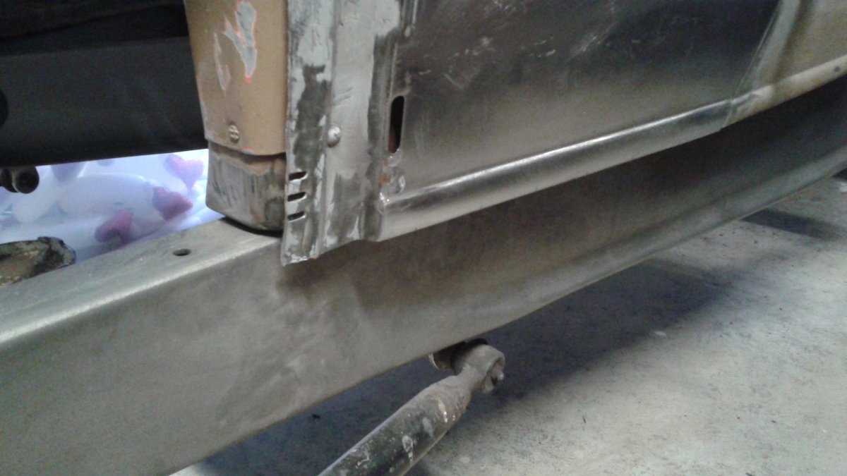

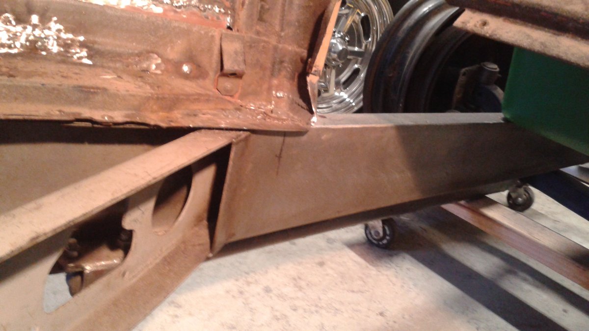

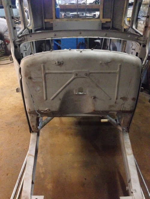

    Here's mine, upper picture is the inside cut and welded flat, the second is from the outside. 1-Cowl bolt.jpg 1-Cowl channel.jpg

    I also made my own rear subrails. Used 14ga, bent it between some heavy angle and a big hammer, then alot of cutting, shaping and welding.
