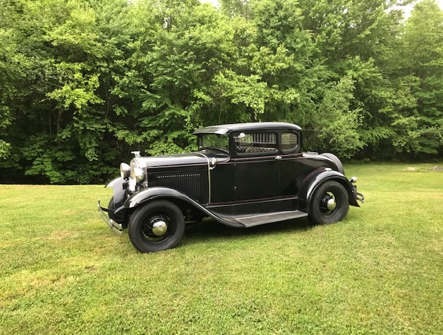

    Have bought a really nice Model A coupe that is pretty much stock but with some nice upgrades likes 35 wheels, 6.1 head, OD tranny, Model B carb, cab and dizzy. Hopefully get it shipped out me in Japan next month with my 33. Plan is to leave it mechanically as is and just enjoy having a simple car.
    Im toying with the idea, although a long way from being certain about it, of perhaps going to a highboy with it. Its a really nice looking car and it would be hard for me to do that if at all but if I was I'd like to buy what I need now and have it come over with the car. Just in case of a rainy day or long winter.

  2. I wouldn't change a thing. It looks gorgeous .
    VANDENPLAS, Dino 64, Cleat and 3 others like this.
  3. ^^^ What he said
    VANDENPLAS likes this.

    Drive it!! Yes on the lowering a little. Maybe bigs and littles.

    Yep big and littles and drive it. Looks nice

    I'm just throwing things at the wall to see if they stick, if it were mine I leave the fenders, lower it front and rear, remove the spare tire, add a dropped headlight bar, remove the quail radiator cap. add some big and little tires and call it done. HRP
    Disallow the step plate.
    What ever you do it looks like you found a nice car. HRP

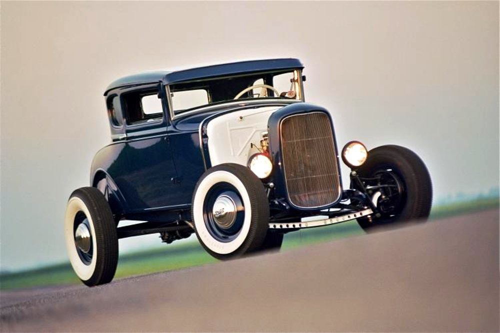

    You're right on the flack.:) Think I would have added an "IMO" to that statement. A lot of bad ass highboy A's on here with A frames. Not bashing anyone for stating an opinion but also not agreeing with your blanket statement. Don't disagree that a 32 frame doesn't look good, it looks great but it's not the only option. This isn't Pete's first rodeo, I'm positive he knows what he wants. Just a few spindly rides below....;)

    As per the pics above, unless you take a few inches out of the roof a hiboy coupe looks out of proportion. Leave the fenders on, that is a great looking coupe.
