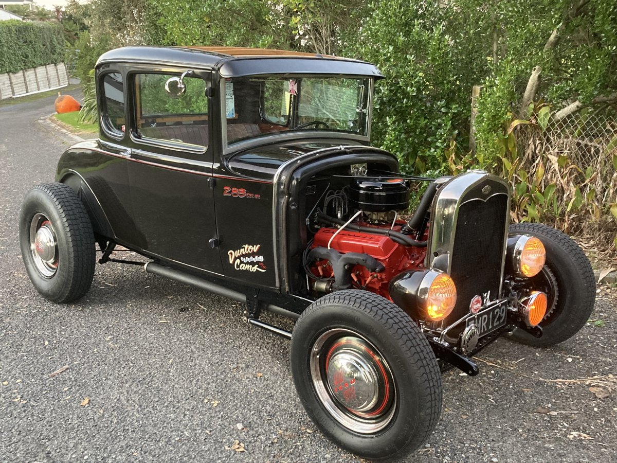

    Haven't posted here for awhile ,been busy on other projects,
    There's a few random pics of the car,
    I've only got a few more jobs to do to finish the car
    Upholster Door an kick panels
    Fit fabric insert top to roof
    Buff up paint
    Some body pinstripes and some subtle 60s style signage
    The car has now passed the certification process to be driven on the New Zealand Roads,the process involves rigorous checking of fabrication,suspension modifications,brake and steering mods etc,
    My cert plate is now attached to the car,and all I need is a "warrant of fitness",
    the hoops and jumps we have to go through is quite stringent,but it could be worse .

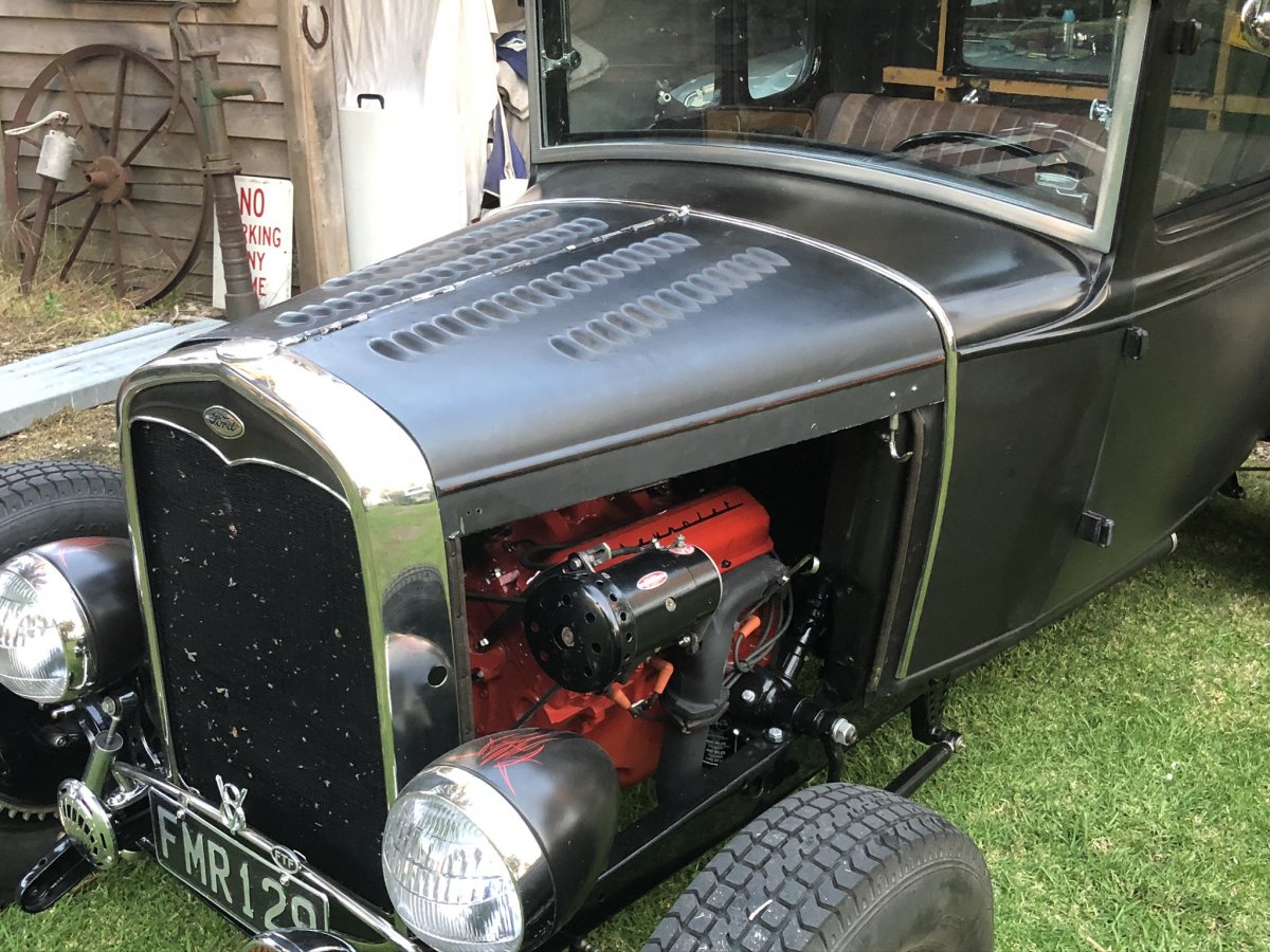

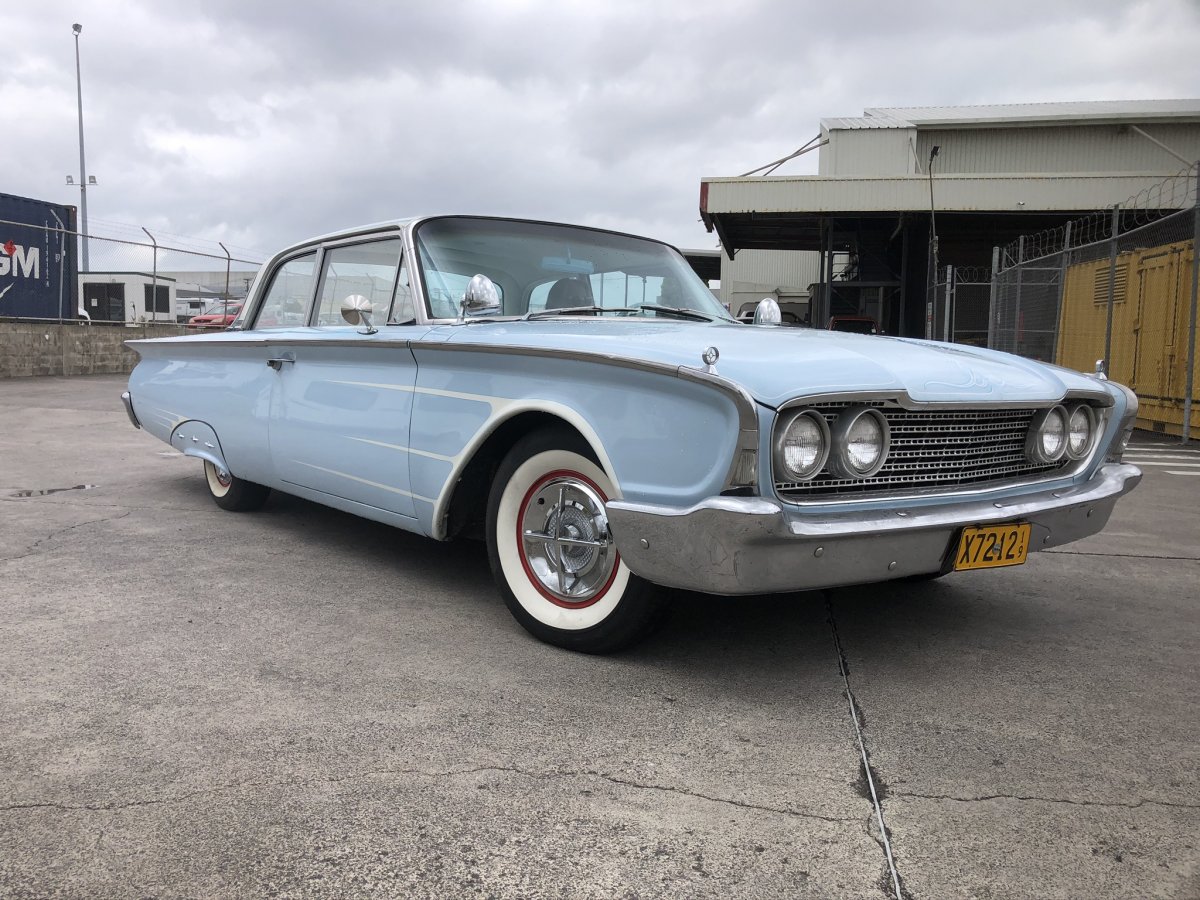

    Got the louvred hood on and secured,used the latches that hold the lower hood side panels down,they work a treat at the rear of the hood to firewall IMG_8683.jpg

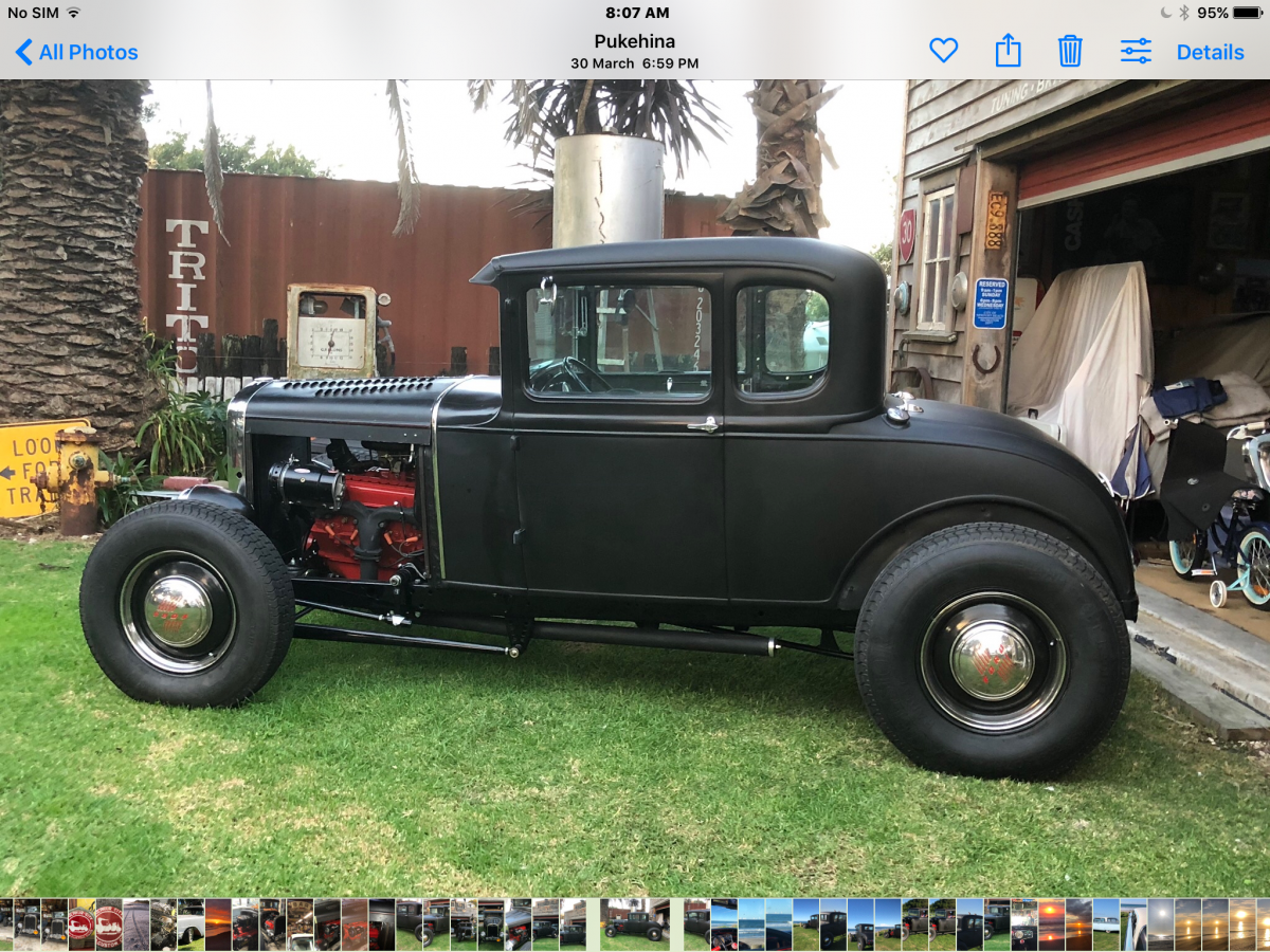

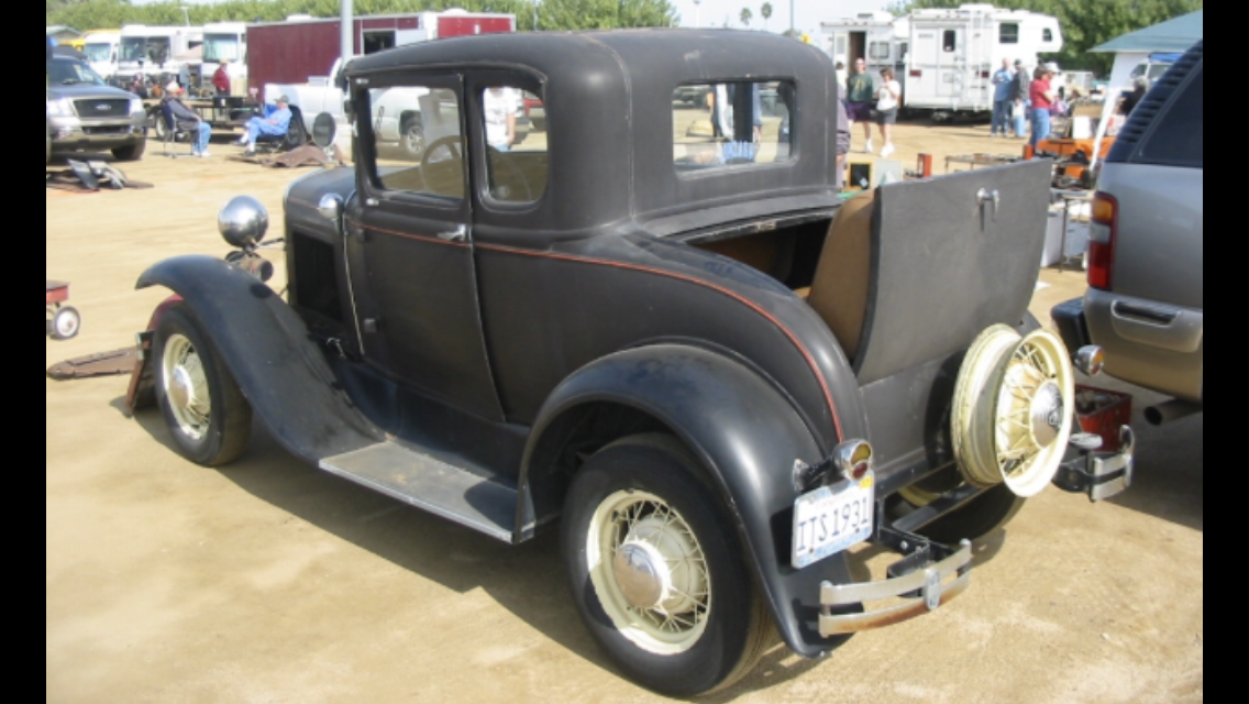

    This pic is of the car when it was brought in USA,at a swapmeet prior to shipping to NZ IMG_7941.PNG

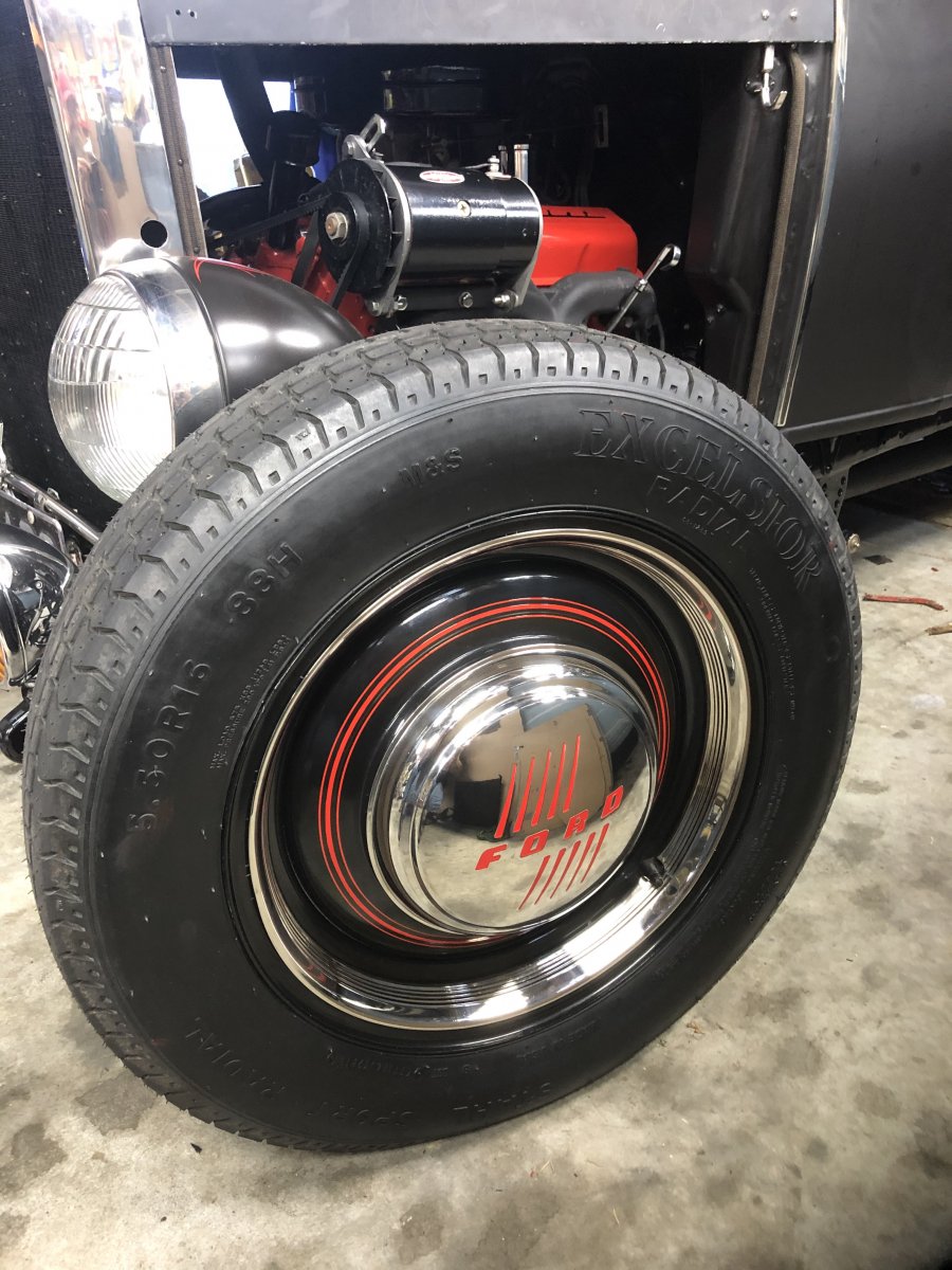

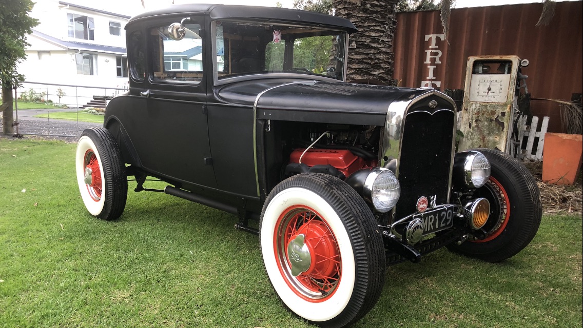

    I kept the 35 wire wheel wheels off the car when I brought it,,I had a set of Firestone whitewall crossplys,7:50/16 and 6:00/16 in the garage as well,
    It was a lazy day yesterday so bolted em on to see how it changed the appearance,,
    Trouble is now I kinda like both styles,
    Maybe run the WW's on one side an the black walls on the other side of the car,,,just kidding,
    Anyways it's now given me a couple of options,,
    Next job after lockdown is to make up some cardboard door and kickpanels,and get a them covered with the same leather deal as the seat, IMG_9725.jpg

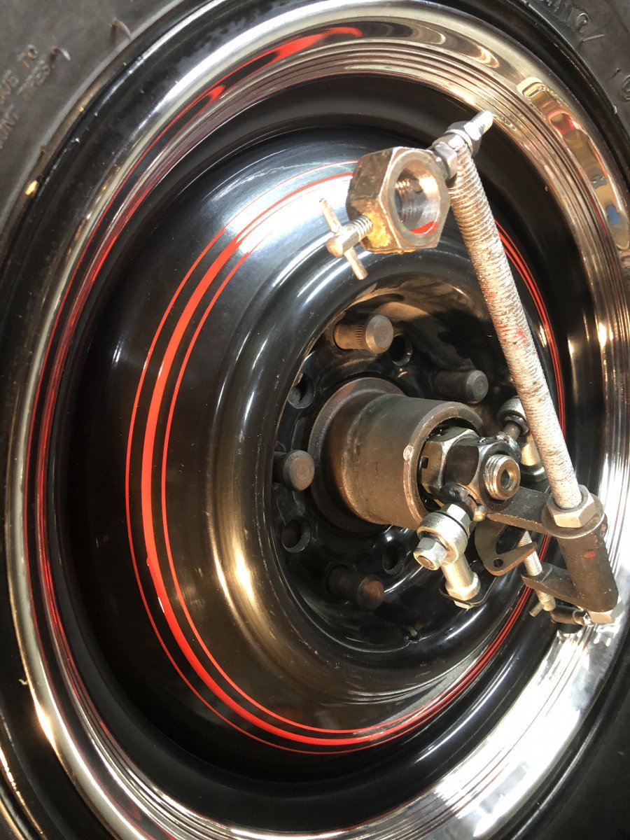

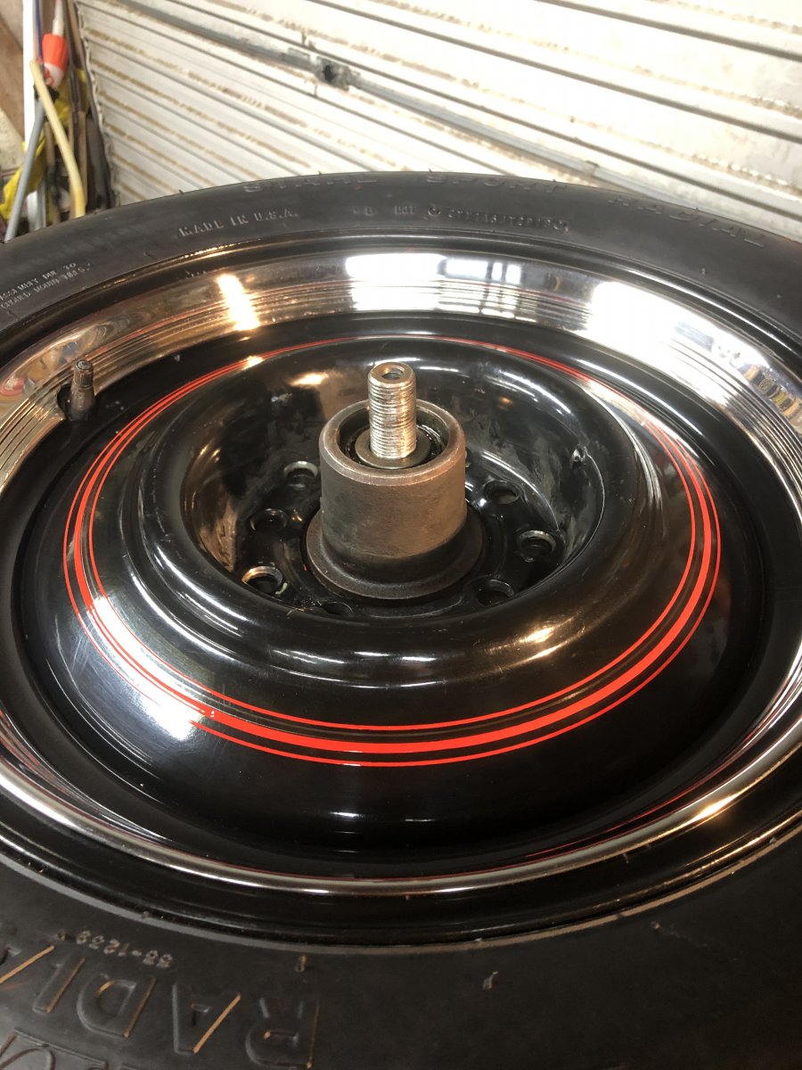

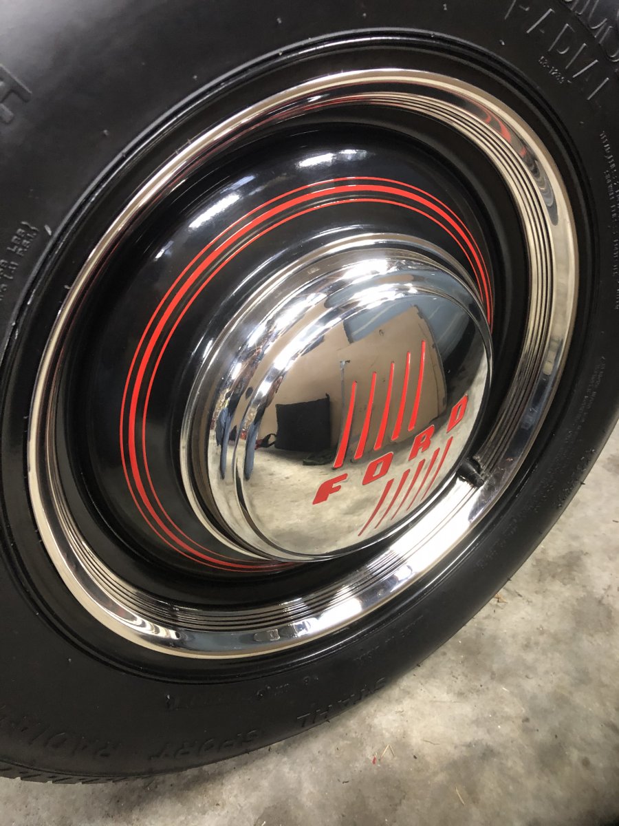

    We have had a few rainy days here,,,a bit of spare time in the shop,,

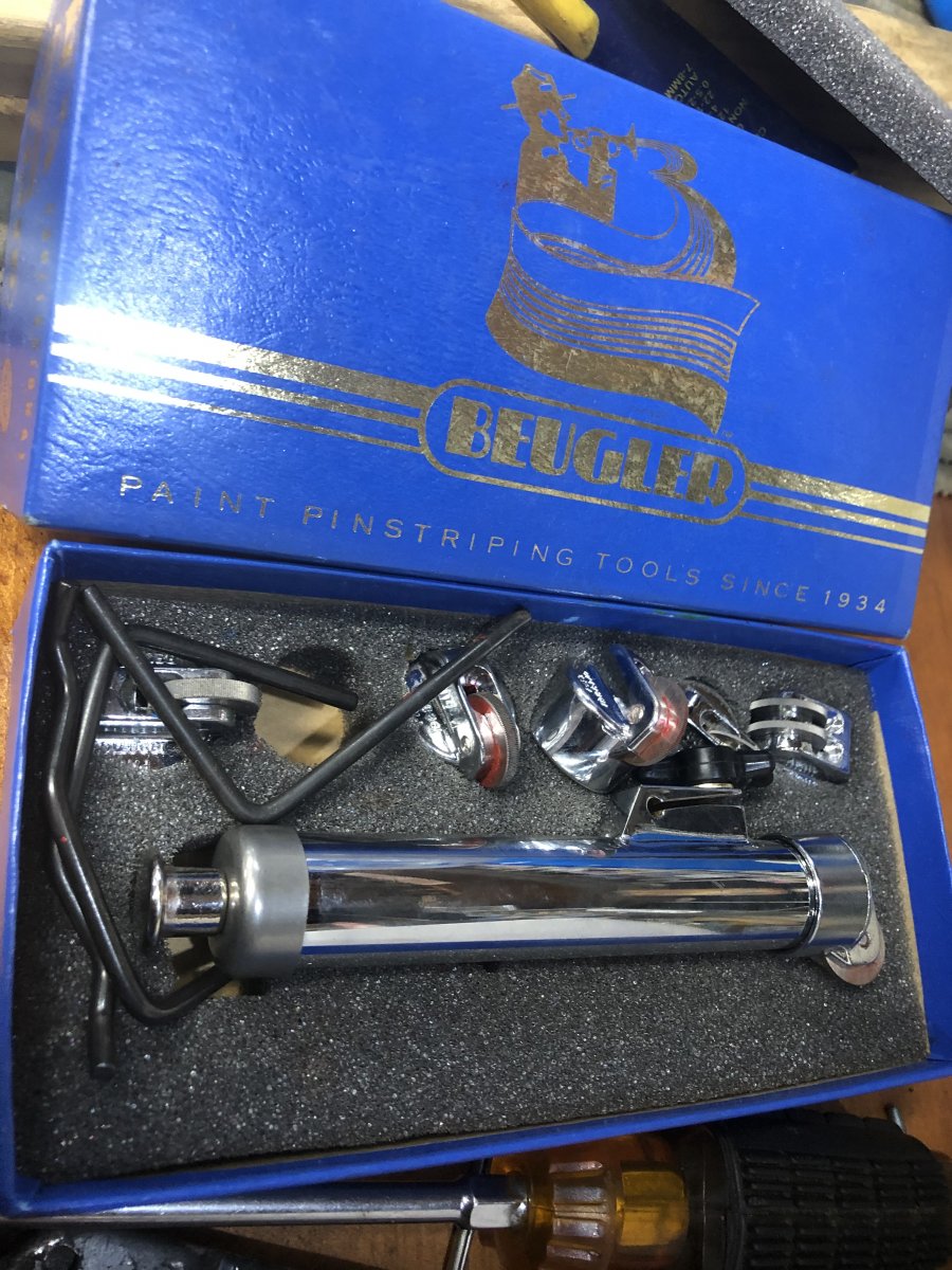

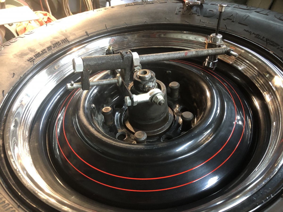

    so I thought I would have a go at pinstriping my wheel rims,
    I had a Beugler pinstriping wheel kit,so made a adjustable tool holder ,spun up a stub axle that could be held in the vice,,used a 37 hub and bearings,redrilled hub to suit 5 on 5 1/2 stud pattern, D44578A2-08B0-4E15-88F3-E9654366CE32.jpeg
    it took a few test runs to get it running and paint flowing how I wanted BE8AFA94-8C50-4A56-BB23-E90EBB8CD53E.jpeg
    Applied the two thin stripes first
    Then fitted the widest wheel and centred it up between the other lines, AF6E72D1-9A50-4DFE-BB94-7B6F8AD6584A.jpeg
    came out ok ,I guess you can’t beat hand and brush applied pinstriping ,,,
    but for some one with a shaky hand ,no pinstriping skills what so ever,,, this was a good project in Respect of building the tool required and getting it to work, D01C9992-DB4C-4550-B0B3-29FC7F6497AC.jpeg
    Pretty happy with the end result 3B46AAD4-98FF-4E95-B76D-3103E730E13D.jpeg DA8F899B-5C38-4F26-B5ED-95199888EBD3.jpeg

    Thank you for the picture of the Beugler striping tool. I bought one years ago and misplaced it somewhere. Now I know that I should look for a blue box.

    They are a great tool if you are not competant and a steady hand,I admire guys who can pinstripe with brushes, it is a real art and it’s not something you can do without plenty of practice,,, bit like learning to play the drums

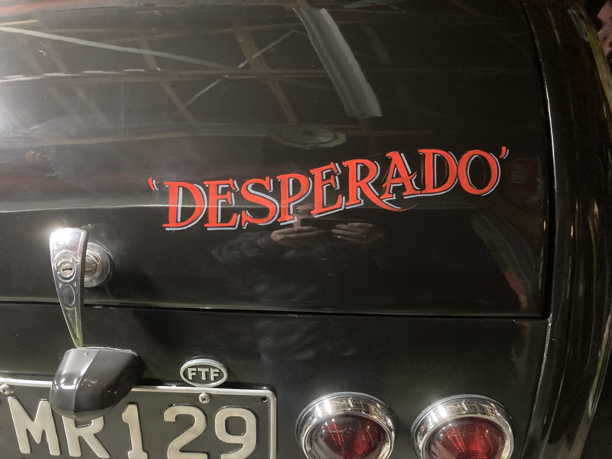

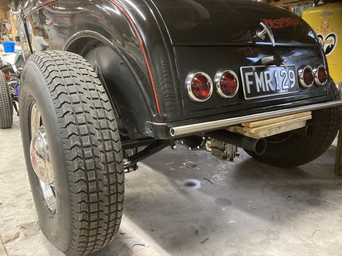

    CFF14A3B-10DD-4078-878A-DD0D2426196C.jpeg Trunk has cars name brushed on “ DESPERADO “and belt line pinstripe

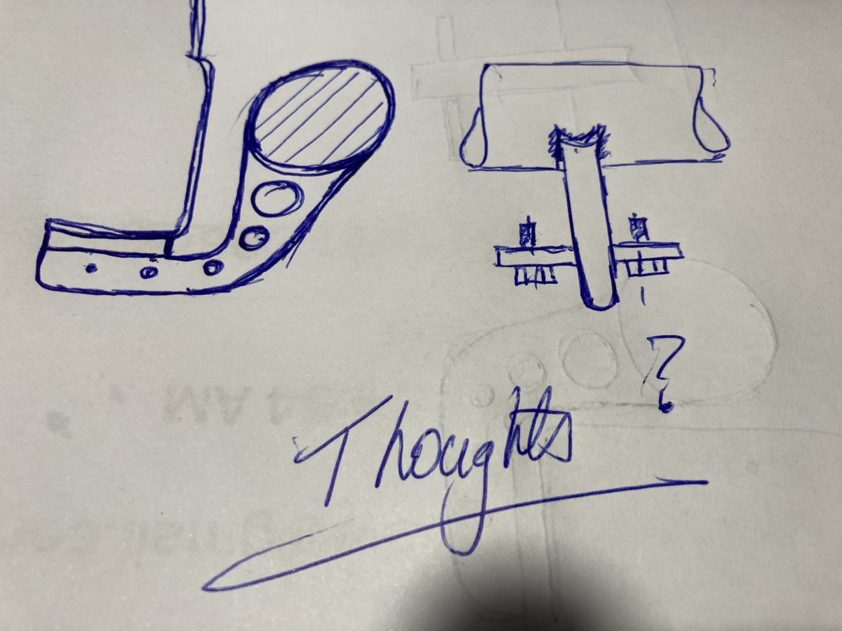

    Next step is a rear bumper nerf bar,, 1”Diameter stainless tube 337AEB35-86F4-4725-BC86-54A6939F91A2.jpeg
    shaped to follow the curve of outer corners,a friend lobster cut an shaped to suit 39B251C1-23FD-481E-AFFE-D9A44B9C6656.png
    Sketching of bumper bracket I will fab out of 1/2” stainless plate D6F5CA7A-6B5C-4464-8564-8D702C56F9E7.jpeg

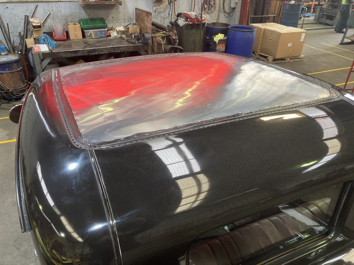

    Instead of using chicken mesh onto of the roof bows I rolled a alloy panel,
    I had this printed on the inside roof panel,we added a plane ,an shifted the Indian an flathead closer to the centre,panel is 32x32” 27025E0B-27D2-44C6-888C-515368944188.jpeg
    An here is the panel looking up from the inside ,with the roof bows an interior light 12C8598A-589C-4404-A9BC-842CC4D83603.jpeg

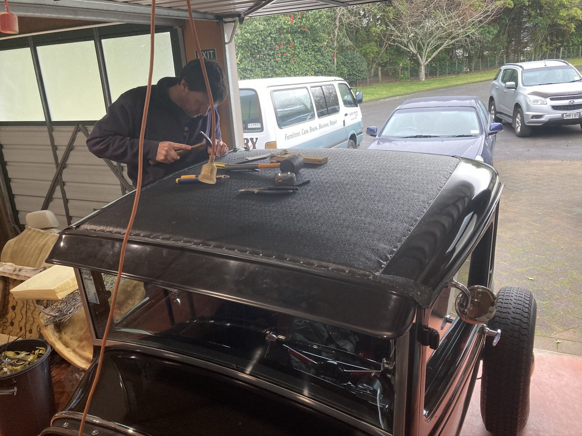

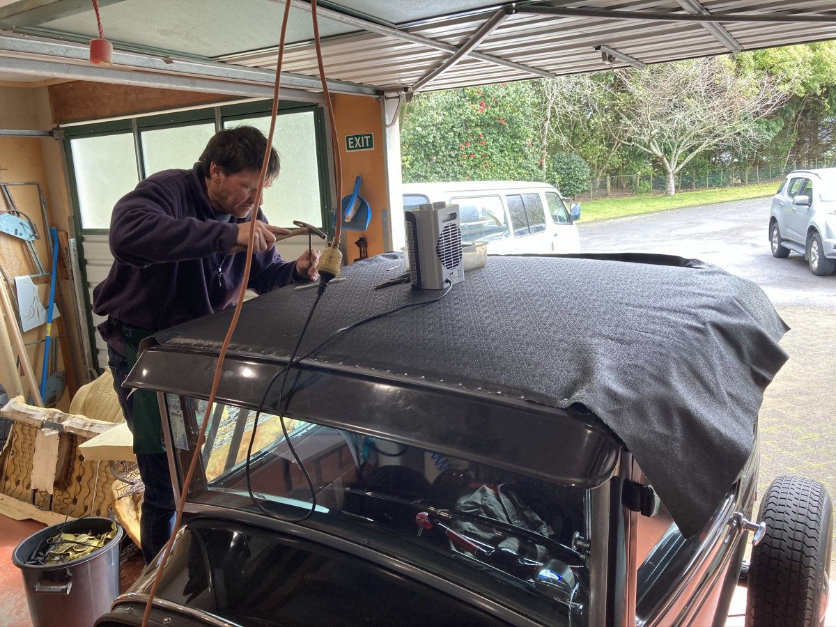

    Roof panel rolled a shaped and tacked down Instead of chicken mesh,
    Then used a foam pad similar to wetsuit material 32CDCA17-9315-45F7-84B4-0CC848C540C0.jpeg
    Material being fitted by our club president and in house upholstery guru ,Kevin Saunders F09A746D-CAF1-42F9-805B-6D5B31FD8421.jpeg
    Homeward bound ,no more wet interior

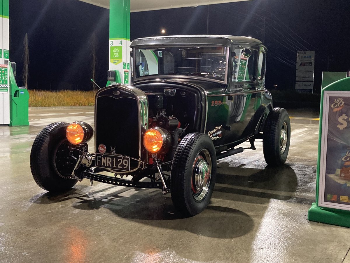

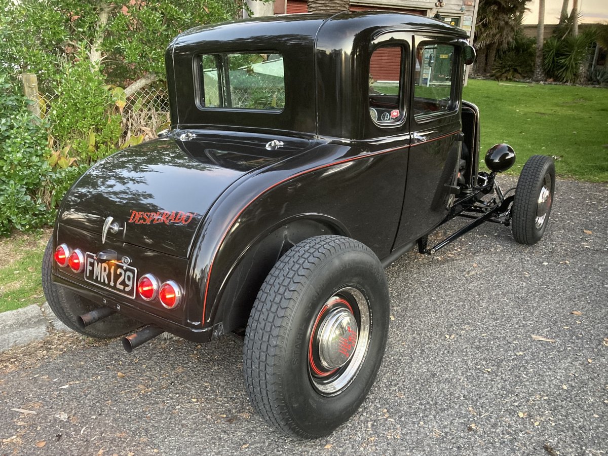

    And cruising the weekend with Sulphur City Rod And Custom Club mates,,,from my place (east coast) over to Raglan (west coast ) an back home,, round about 400 of Smiling miles 07702588-15D1-491C-BEFB-7ED575FECB65.jpeg
