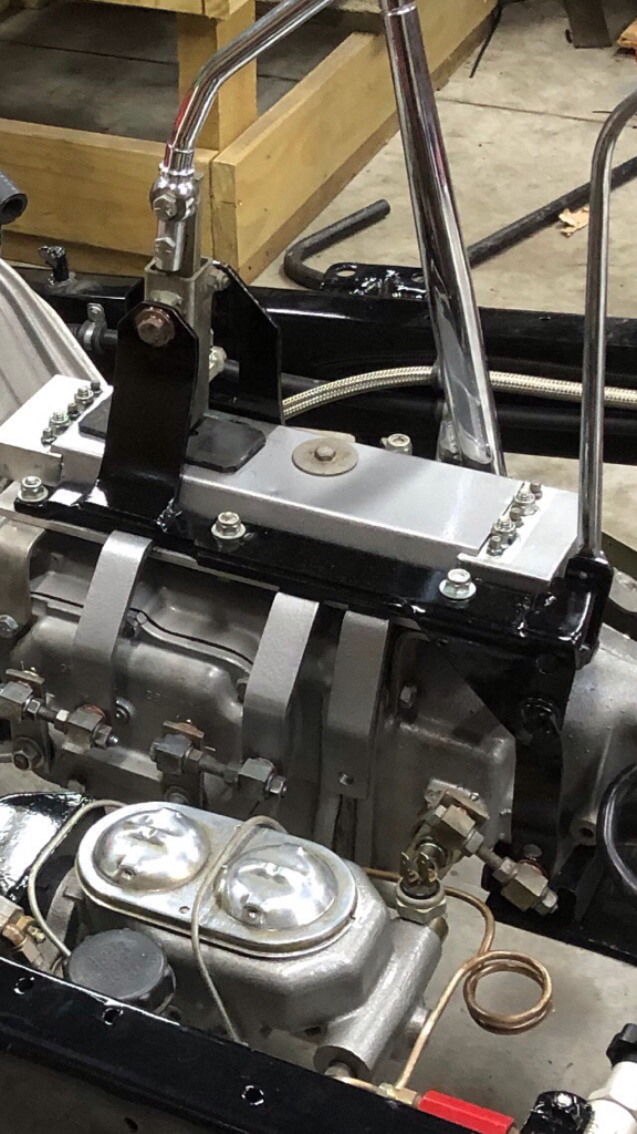

    That certainly is a interesting shifter. A lot of work went into it. I would be interested in knowing how well it works and happy you are with it once you have a few miles with it. Where did the idea come from ?

    Hi Vic,I have the same shifter on my 37 Tudor,runs sbc/Muncie ,,an it works fine,,, only problem I've had was occasionally it would hang up when taking it from reverse back to neutral,,,,so I made an additional shifter lever for reverse, as you can see by the extra gear stick,my good friend Bob Anderson RIP always ran a seperate reverse gearstick on the manual hotrods he built, just something different,,, the position of the main stick put it very close to were an original stick would be say on a model A,other wise the other option being a impala shifter bolted to the tail shaft housing puts the gearstick right back into the bench seat,, if you look a few posts back you will find the advert for the shifter,,,I don't know if they are still made

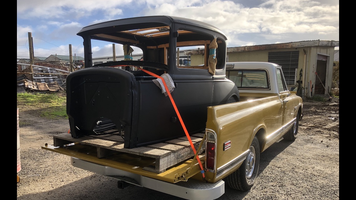

    So today I went to the paint shop to check progress,,,and they were in the process of painting the body IMG_5943.jpg IMG_5940.jpg IMG_5953.jpg IMG_5955.jpg
    The pics above are the final colour,in the light of day the paint is really dark dark gray/brown,I'm pretty happy with the outcome so far,,, we are going to give the paint a slight buff,,just want a little shine,but not to much,
    So I will head to town tomorrow with the pickup ,and bring the body home ,,,,
    Will post a few pics in the next few days

    Was easy to get out of bed this morning,time to go get the body from the paint shop,,, IMG_5985.jpg and unloaded into the garage ,first job tomorrow will be installing sound deadning in the doors and Inside body panels, IMG_5981.jpg

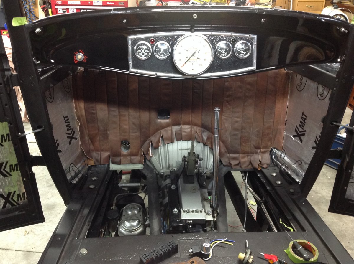

    Starting to fit up the behind dash stuff, an lifted the body on t the chassis ,,,over the weekend I will shim the body mounts to align the doors,I've fitted all the door latches, catches,rubber bumpers an window regulators,also start wiring jobs,wiring dash gauges with a plug ,an starting to mount the regulator,fuse holder,relay boxes,,, still away to go but buzzing on progrss,,, IMG_6043.jpg
    Part A meeting Part B,,, IMG_6090.jpg Will start shimming body this weekend, IMG_6095.jpg

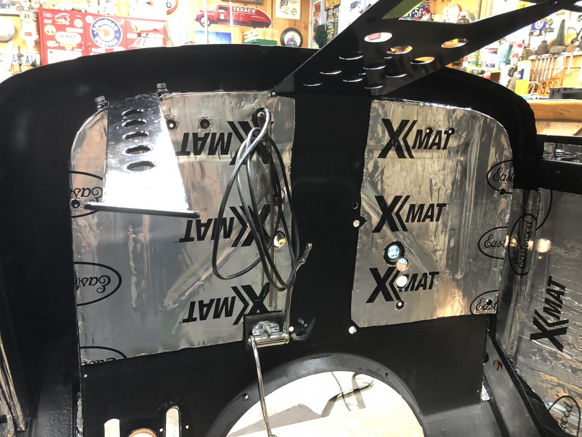

    Finally got the firewall pad in place , pleats are 1 3/4"spacing ,now to secure it ,then wiring,cables, temp capillary,oil tubing etc can be put thru the various holes,,,,,pretty happy and starting to see light at the end of the tunnel IMG_6249.jpg IMG_0113.JPG IMG_0111.JPG

    Morning - not sure but you might want to check out yer Eastwood insulation - have read where when it gets hot the - rubber ? melts and causes a mess - read some time back on the H.A.M.B. Where others were upset with using an Eastwood insulation

    Will check it out, anyone got any thoughts on this,,, shows it can be used on the firewall,an it is for heat resistantance,

    Just went under search and typed in Eastwood insulation and found under topics article you might want to read
