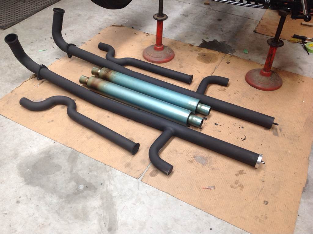

    ImageUploadedByH.A.M.B.1420883514.915819.jpg ImageUploadedByH.A.M.B.1420883572.725892.jpg
    Hi guys,
    Been busy at work, but progress is still happening on the A,got the exhaust system done today,will post more pics over the next few days,

    like the style your car is going and especially the exhaust!

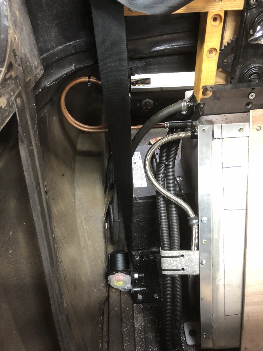

    IMG_0455.jpg Hi Guys,
    Back into the A,,have been busy working on our Chev C10 Pickup, painted and panelled and makeover,also working on a 37 ford tudor,bringing that up to NZ certification standard for low volume vehicles,

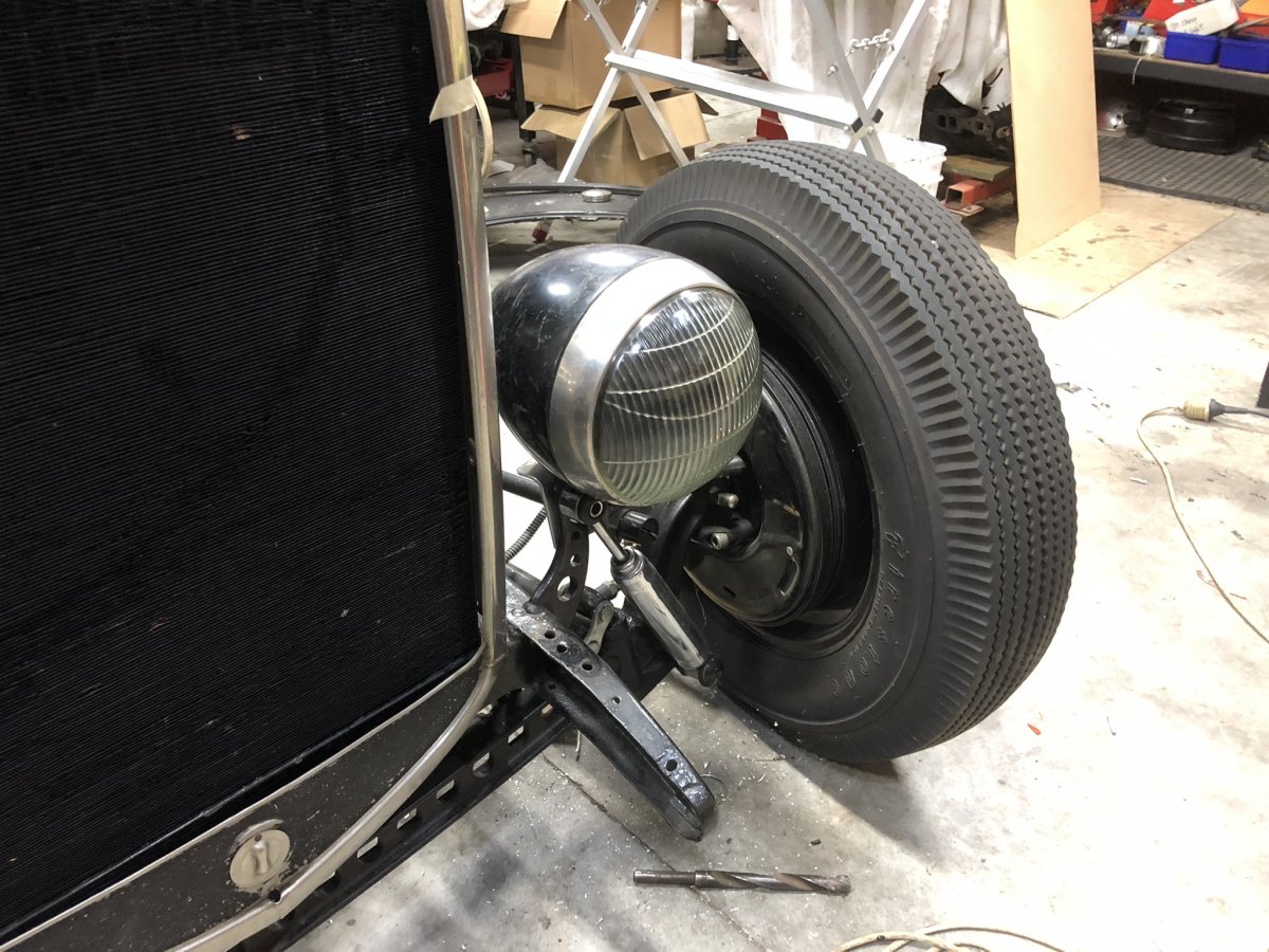

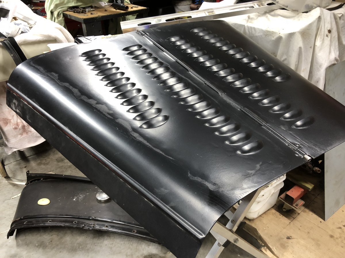

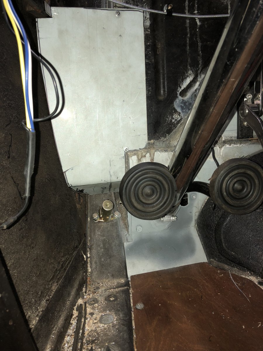

    Now back into the A,,,,will post up pics of progress over the last few months IMG_1260.jpg fuel lines an breather line and battery cables IMG_1263.jpg rear firewall partition between fuel tank and seat,,, IMG_0451.jpg hood louvred punched IMG_0395.jpg dipswitch and firewall panel IMG_0438.jpg 36 ford headlights mocked up,

  12. KustomKreeps
    Joined: Jan 7, 2016
    Posts: 325
    KustomKreeps
    who did the louvers?
  13. whitewallwilly
    Joined: Apr 2, 2012
    Posts: 205
    whitewallwilly
    Dave the louver man Graham

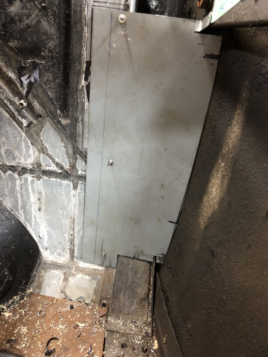

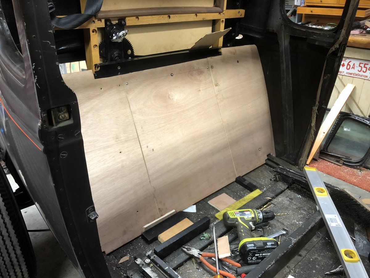

  16. Nice Build, Love the 36 lights ... I'm about to install a 36 dash with 40 gauges into the A coupe formerly owned by member Christom ! ... I would love to have saved the original tank but it is leaking like the proverbial sieve so in keeping with his 'using as many original Ford parts ' with a slight twist and the fact that it needs to be RHD (As it was originally built here) to be 'Legal' a few other mods will be required but the coupe will to all intents and purpose Look the same outwardly. Interested to know if your 'firewall partition' is compliant with the LVVTA code of compliance as I thought it would have to be steel ! (or have I misread the code) regards Chris (30AV8)

    Hi Mate,,
    I've checked with my certifier ,the info I got was that a wooden panel is okay,,this quite heavy duty ply,,,,,,it is very well secured and braced,,,when it's installed at final assembly it will be fully sealed around the perimeter and joins,,

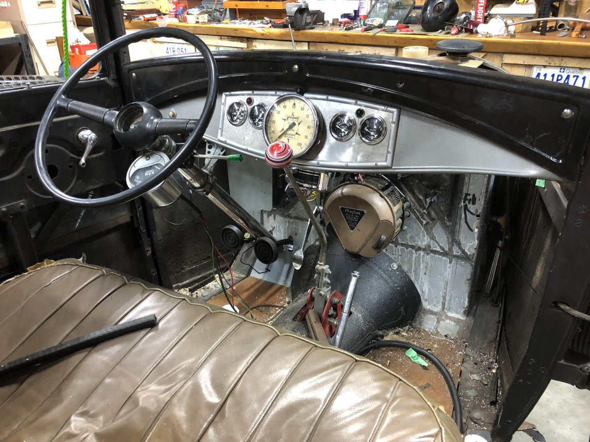

    enjoying the build,subscribed.tell me whats[​IMG] the heater out of?.is that a triumph badge on it? .

    is that a smiths type heater? thanks

    Heater is out of a Pom bomb(made in Great Britain),its a perfect fit an very simple,easy to mount and the water inlet an outlet pipes line up nicely just above the r/h rocker cover and the intake manifold,

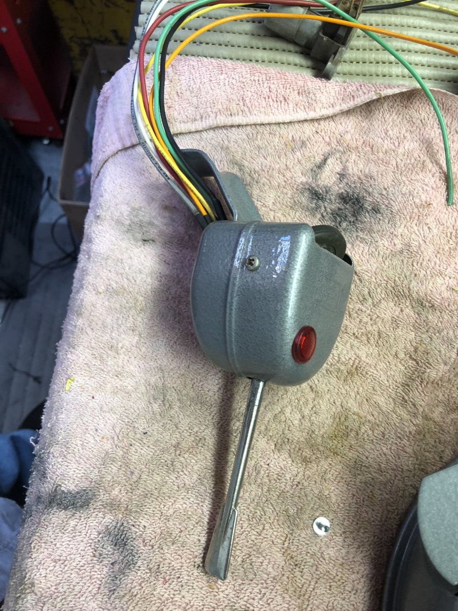

    With our weather warming up as we head into our spring,spending more time in the shop,have now finished the 37,, all legal for NZ roads,Time to move back onto the Model A, IMG_3570.jpg All the patch panels done,filled in the tail light holes ,and re did them to run four 50 Pontiac lights across the ass,,mounted 37 trunk handle,,and a no plate light I had lying around,cut 1" off the mount end and ditched the no plate bracket that was attached to it IMG_3530.jpg IMG_3548.jpg Retired the flasher unit,and powder coated the housing IMG_3511.jpg finally got my dash insert finished,,tried all sorts of crinkle paint to get the old style effect,I ended up powder coating ( no black available) it,then painting over that in the black(rattle can) ,,pretty happy with how it turned out,,
