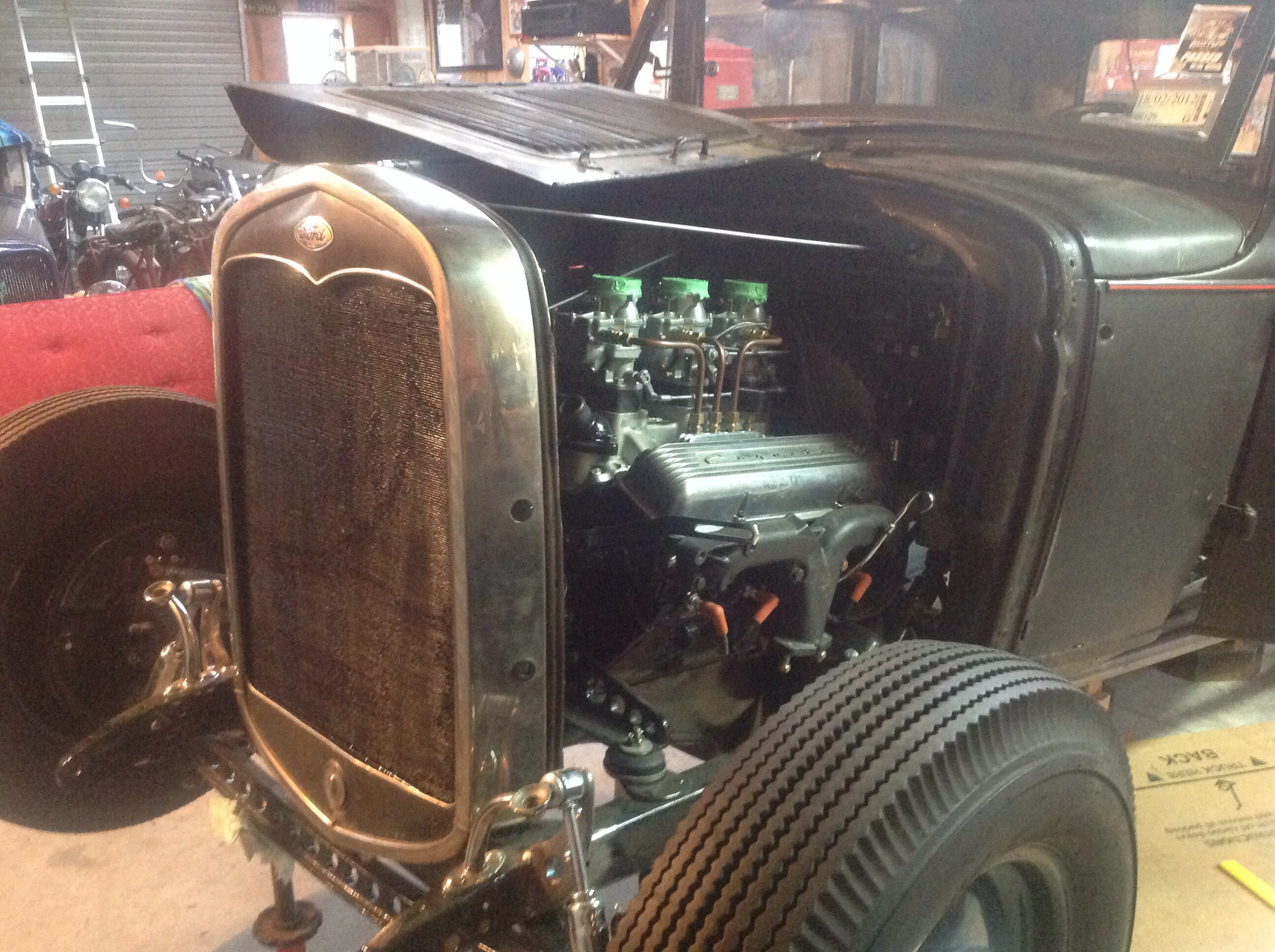

    Where did you get those scoops for the carbs? Car looks great

    Picked them up at the swap meet at the Bakersfield hotrod reunion couple years ago,I looked at all the online catalogue scoops and air cleaners avaliable ,didn't spin my wheels ,
    I believe they were made to be used on boats as spark arrestors,I may be wrong,if anyone knows if this is correct or not please comment

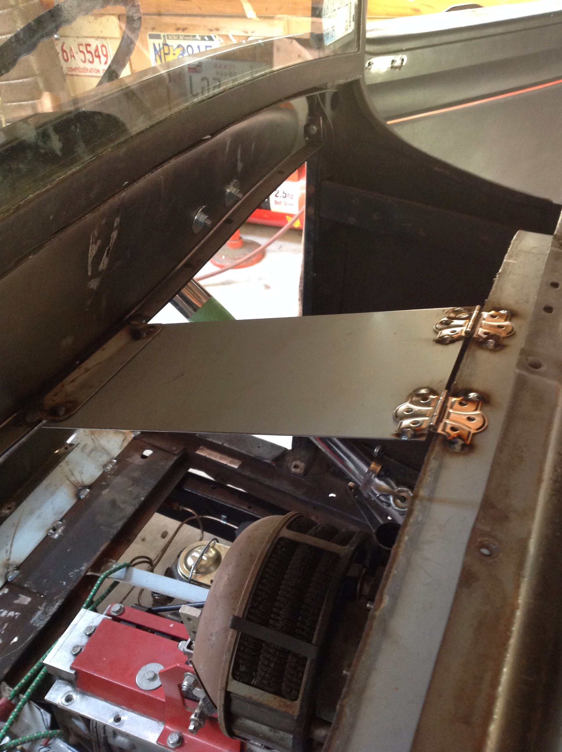

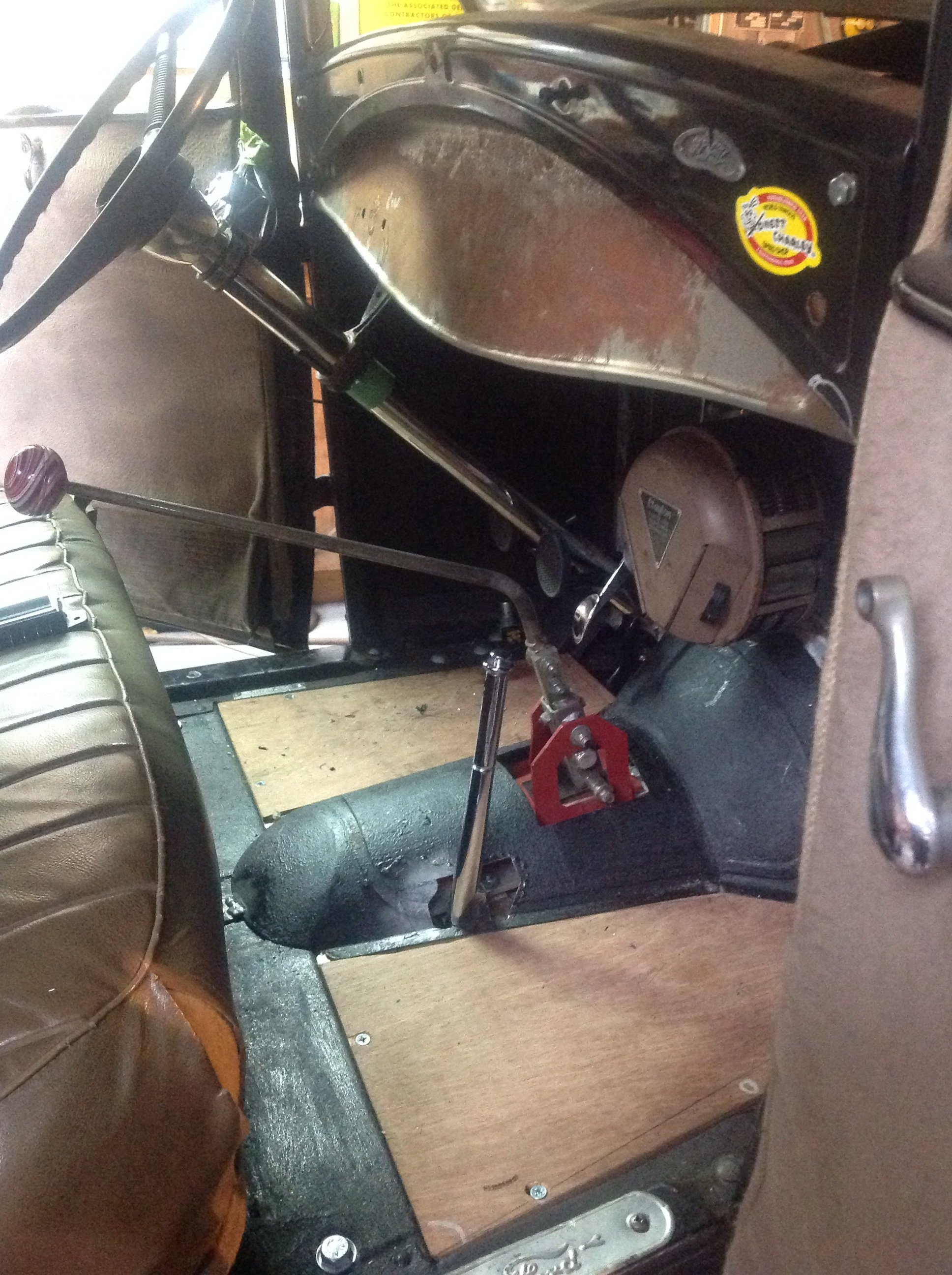

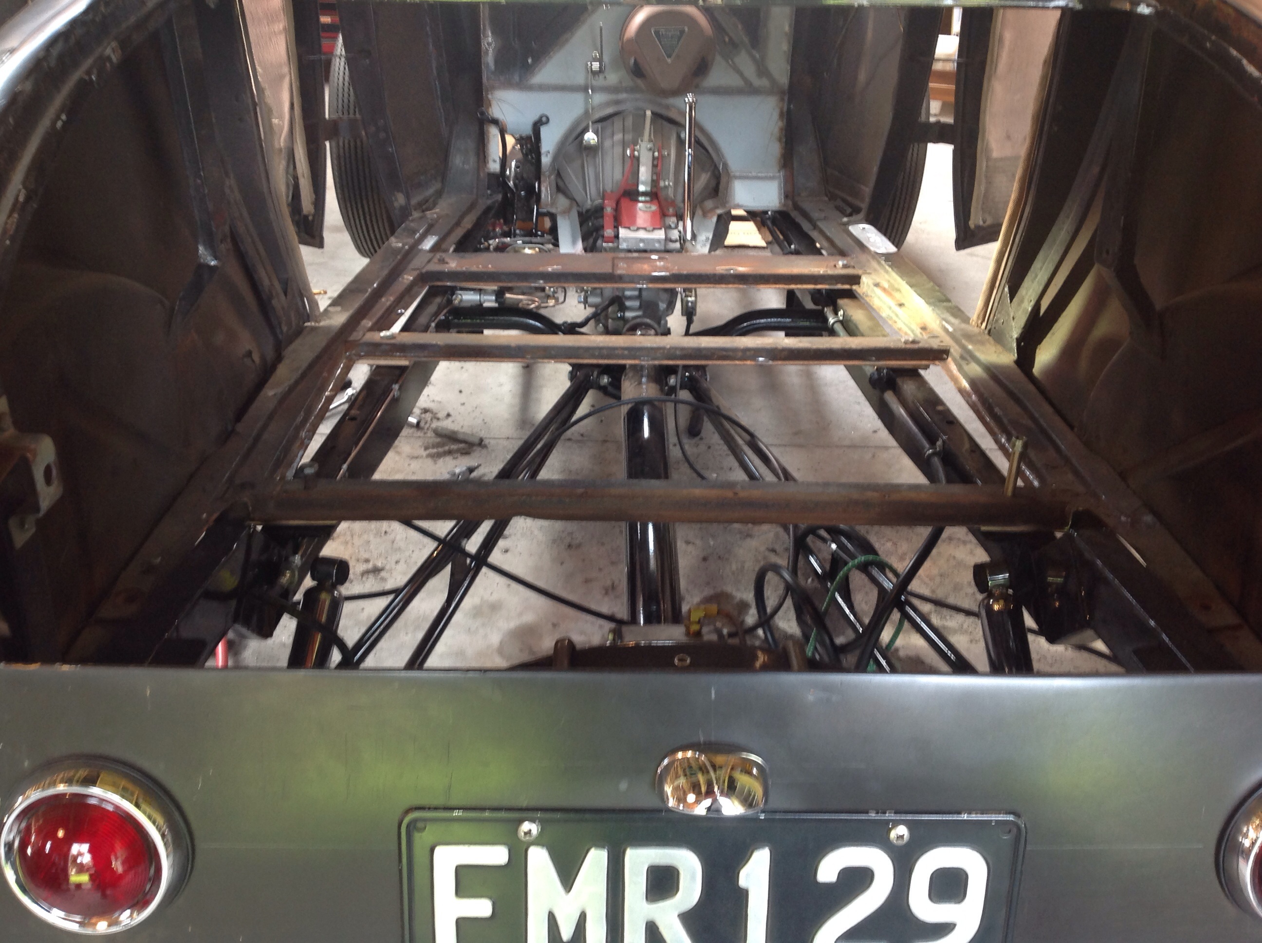

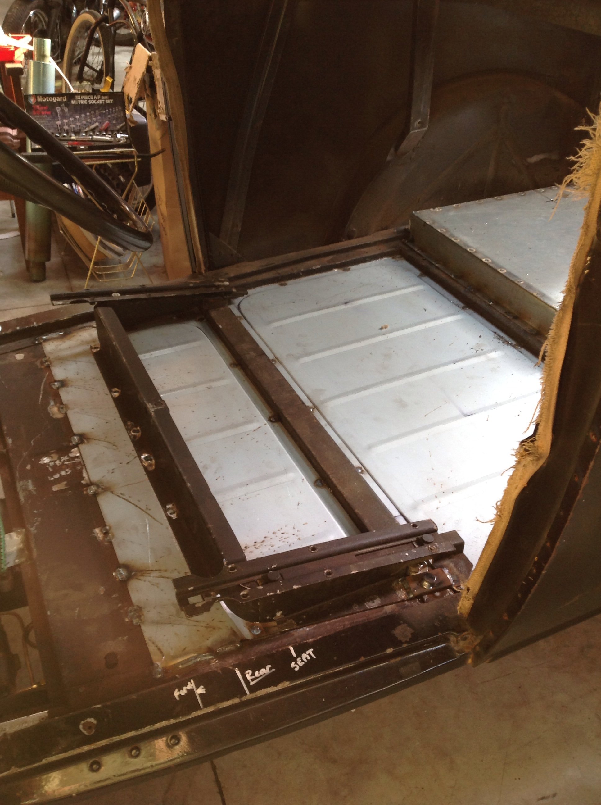

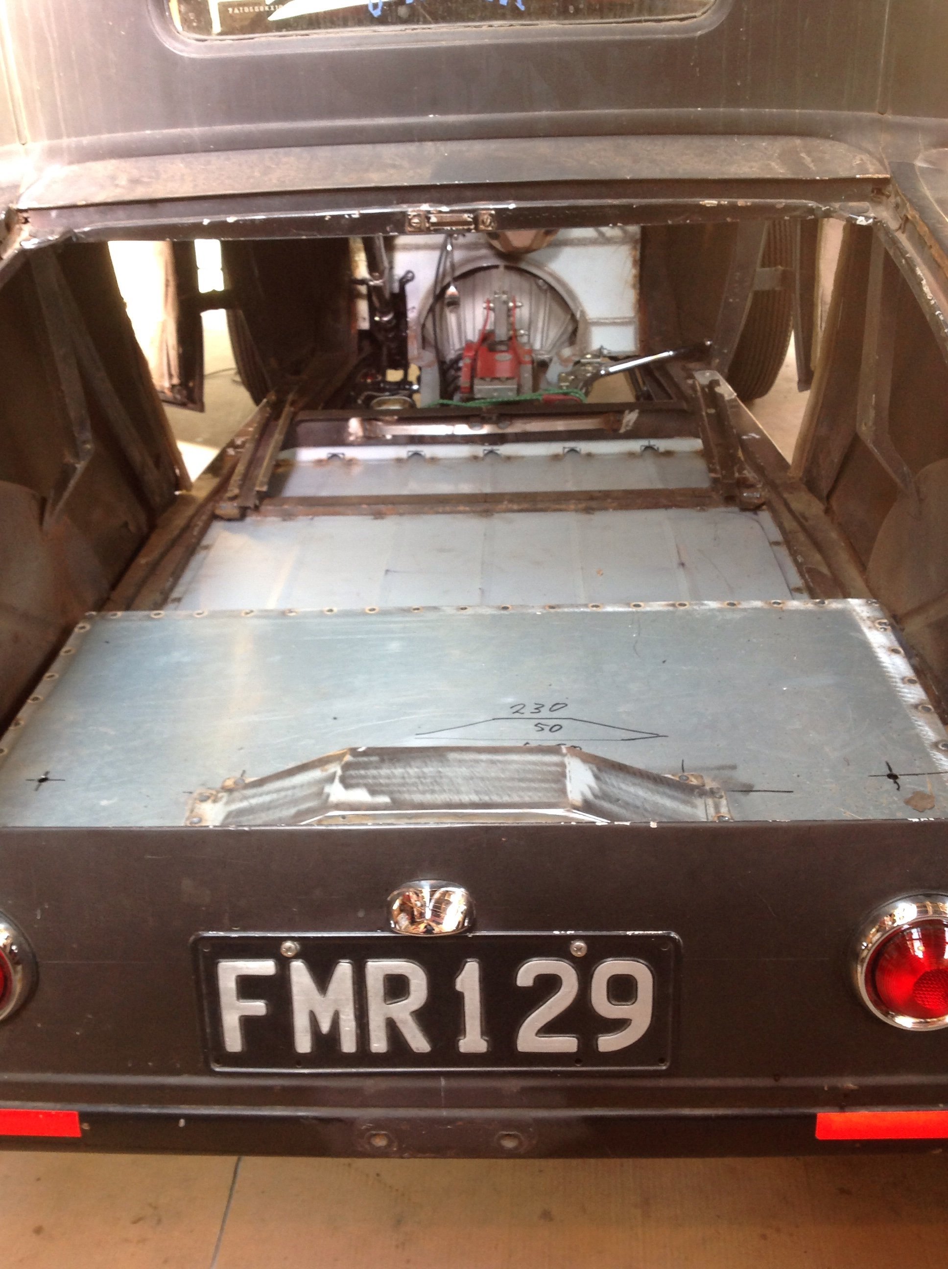

    Got all the floor panels out,ready for new ones last week,again my good mate Surtz helped us out ,he has all the gear at his shop for doing this,so I loaded the car up and droped it to him, image.jpg I'm using the origanil seat and seat base,I have shifted the seat base back about 4",and bolted it thru the floor,it has a screw adjuster knob that allows about 4" of travel ,perfect!! image.jpg Surtz Got the floor pretty much all done an dusted,the body is now back on and tightened down,
    all the wood packers have been set up to shim the body to chassis gaps, image.jpg
    The front and rear shock mounts have also been welded on ,steer column drop sorted and made a hinged bracket from the firewall to dash so as to fit the regulator,coil etcetera ,so if I need to I can undo couple bolts and have easy access , image.jpg back in the shop today,got a list as long as my arm to get thru,damm list seems to get longer every day

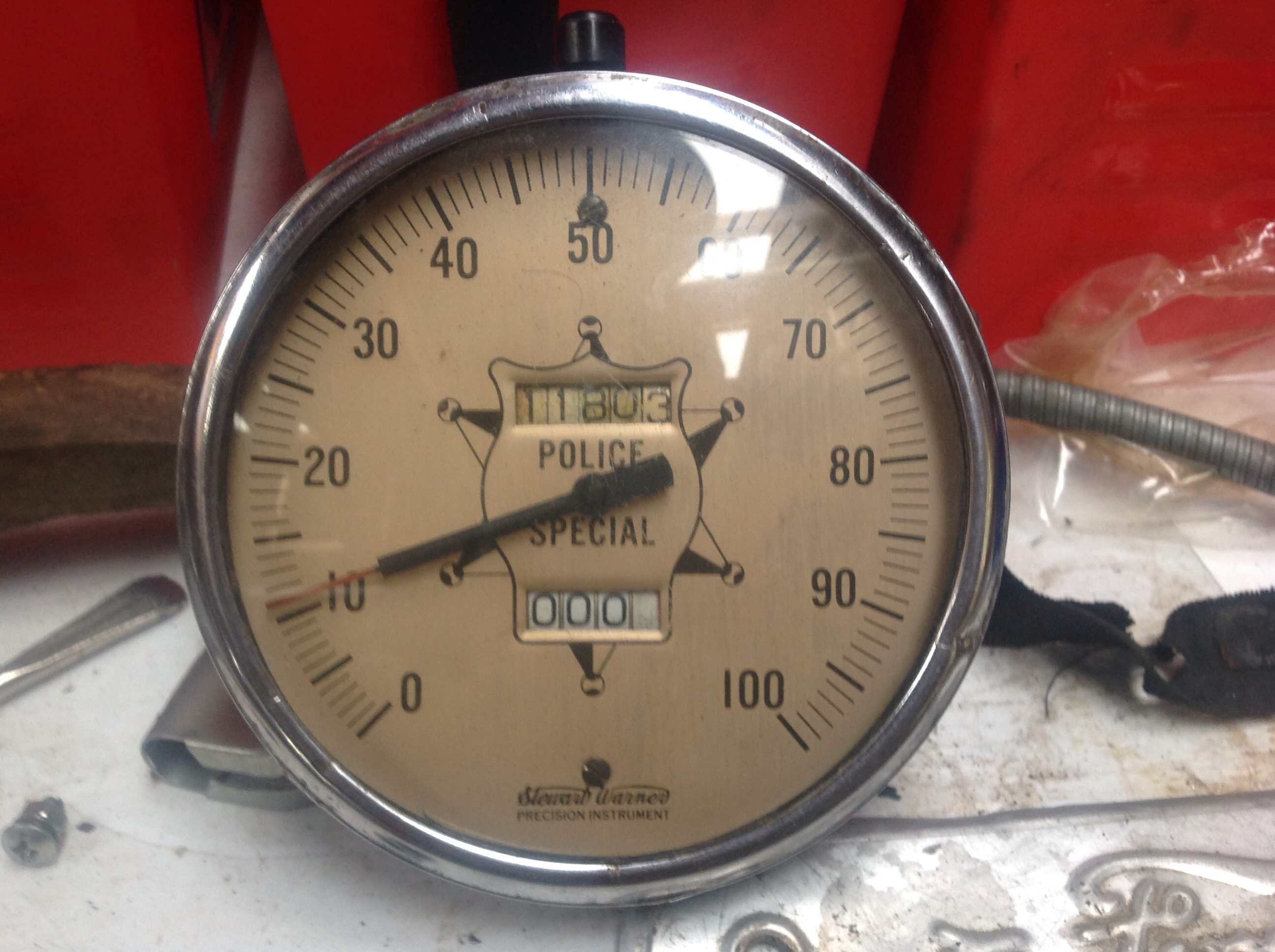

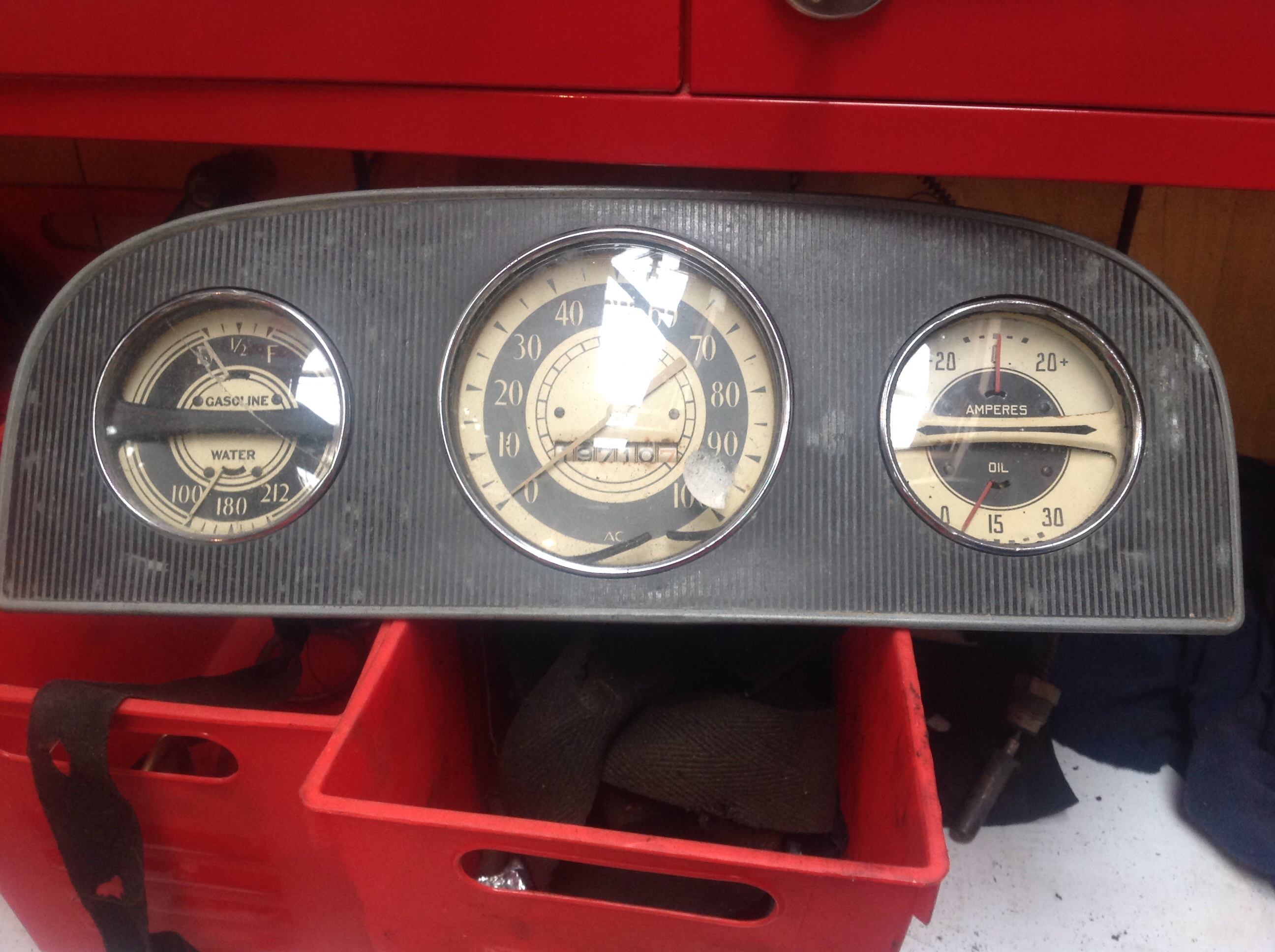

    Been ticking away at that list ,managed to score some cool gauges ,the gauges below are aparantly from a 34 Buick ??, I'm thinking bout using the outer gauges ,not the speedo, but using the police special speedo in the pic 2 down,any advice or hints in hooking em up would be appreciated,speedo drive is mechanical from the Muncie ,how do I work out speedo gearbox drive gear ratio ,I know the plastic gears are multi colour, I'm running 1 to 1 in top with 750.16 rear tires, image.jpg image.jpg Going to mount the 5" speedo in centre of dash,and the two other gage sets,water/gas and amp/oil pressure either side of the speedo,I'm probably going to mount them with no gauge surround ,just straight into the dash,

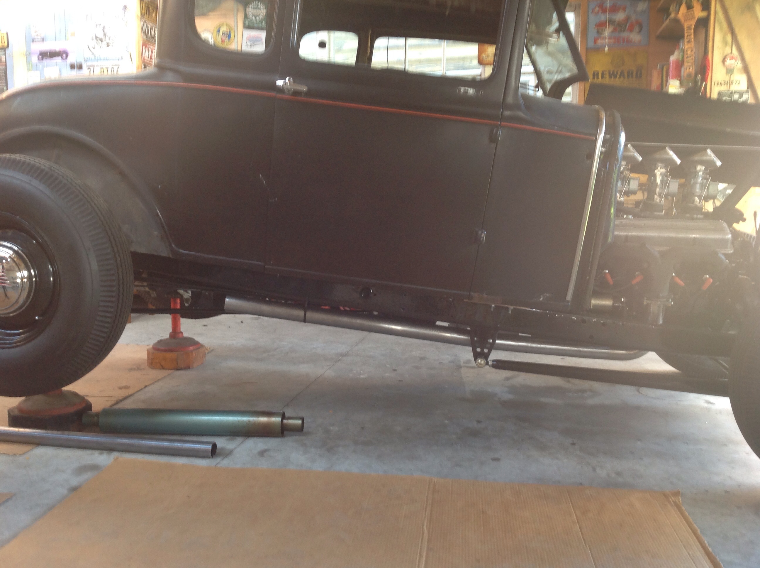

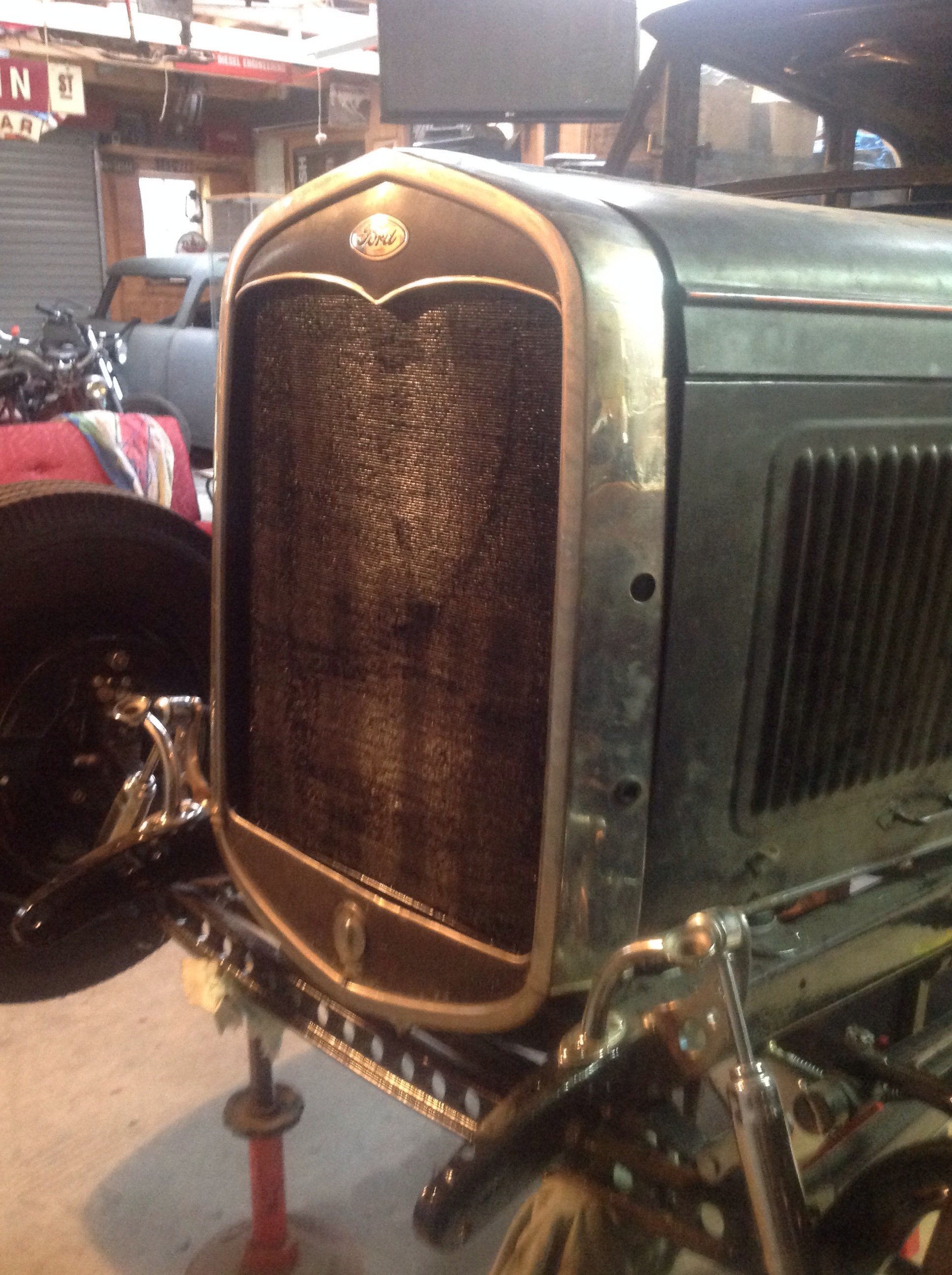

    also got the floor boards done ,they just need a vanish or stain image.jpg got the radiator all mounted and just sorting bonnet and side panel clearances so I can run with or without bonnet etc, image.jpg image.jpg next job is the exhaust ,kinda like this style in pic below,with straight pipes with caps on ,dumping out in front of the rear wheels ,but with mufflers mounted up either side of the driveshaft ,between the ladder bars and the driveshaft,and exiting out over the top of the diff to the rear pan

    typical police speedo------ it's already doing 10mph standing still ;);)

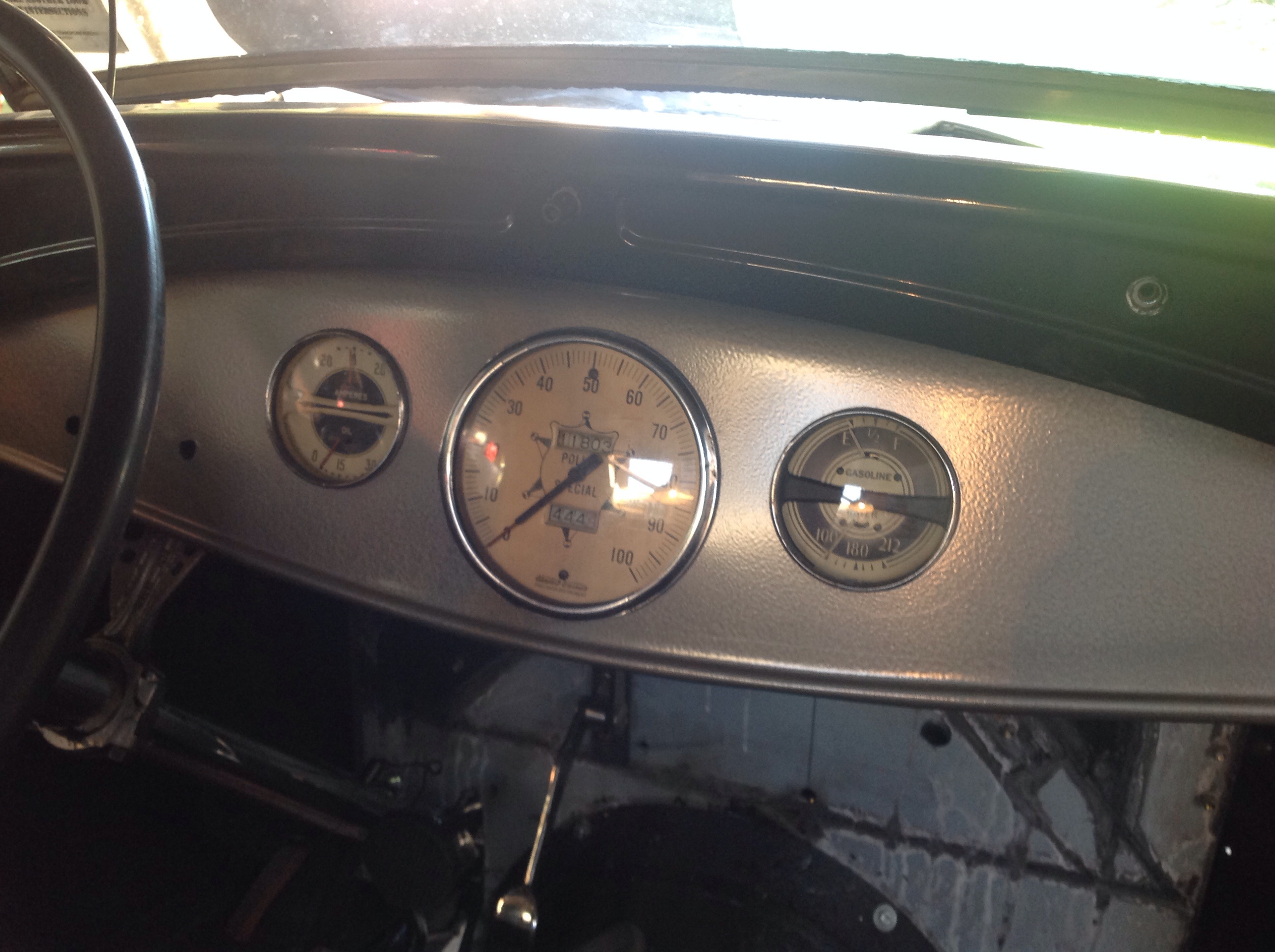

    got the gauges mounted in the dash,used the local guy here with one of them new fangled water jet cutters to cut three holes for the gauges, what a hell of a piece of gear , so accurate didn't even need to take a file outa the tool box, image.jpg made up the exhausts,used 2.5" tubing,I didn't want to go the lakes header deal,I really liked the alternative which I had seen on the rolling bones cars, image.jpg I've still got to route a pipe of up under the body an thru a muffler to exit out the back,that's this weeks job, image.jpg also got all the brakes bleed ,no leaks at this stage and a good pedal ,spent a heap of time on some of those small pain in the arse jobs,fuel filter/pump mounting ,running fuel lines,generator mounted,,radaitor hoses ,bonnet and cowl alignment ,etc
