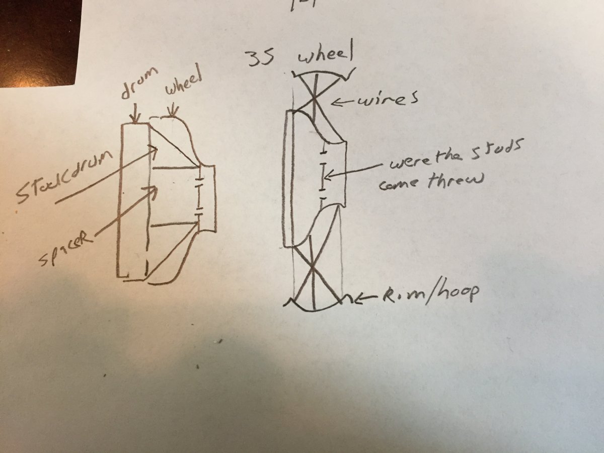

    I'll draw a picture .

    IMG_7047.JPG Ok so I tend to over complicate things but this is what the spacer is for A/B/C are all widths so you can see the cone width of a stock drum B is the same as the spacer width on the flat drum.
    IMG_7048.JPG These wheels are 4 inches wide with two inches of back spacing. The matting surface is the very center section where the studs come threw.
    NOT the back of the center of the wheel that is probably just a hair smaller than your new drum if not about the same size.
    On the left you can see how the cone or spacer goes inside the wheel so you can bolt the small center section firmly. That back section that's not going over the drum doesn't go over the drum, and should not be pushing up against it when bolted on.
    I know, kinda weird.
    So if you've already found the wheel doesn't go over the drum you've already done half the work. Put the wheel up against the drum, add a fraction of an inch on each side to back the wheel off from touching the drum and that's your width with the "spacers" which actually only move the wheel out that fraction of an inch

  20. Thanks Tim, the drawings help

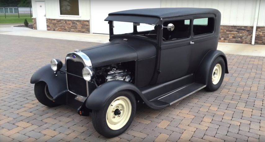

  25. Tim
    Joined: Mar 2, 2001
    Posts: 17,214
    Tim
    from KCMO
    IMG_7059.JPG And that's how it looks. A touch wide but completely acceptable so the narrower rear should be about perfect

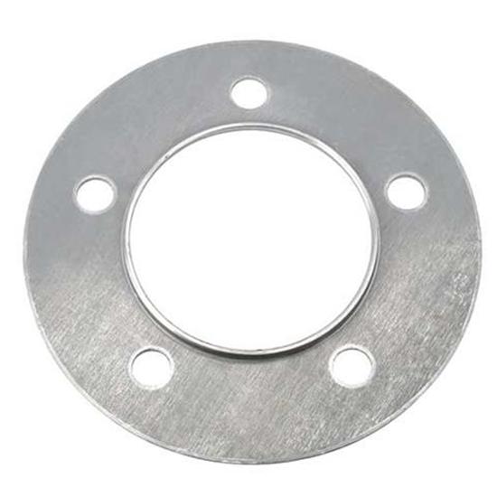

  28. Be aware; unless you machine a custom spacer, you will still need a "wire wheel support ring" to properly mount a '35 wire.
