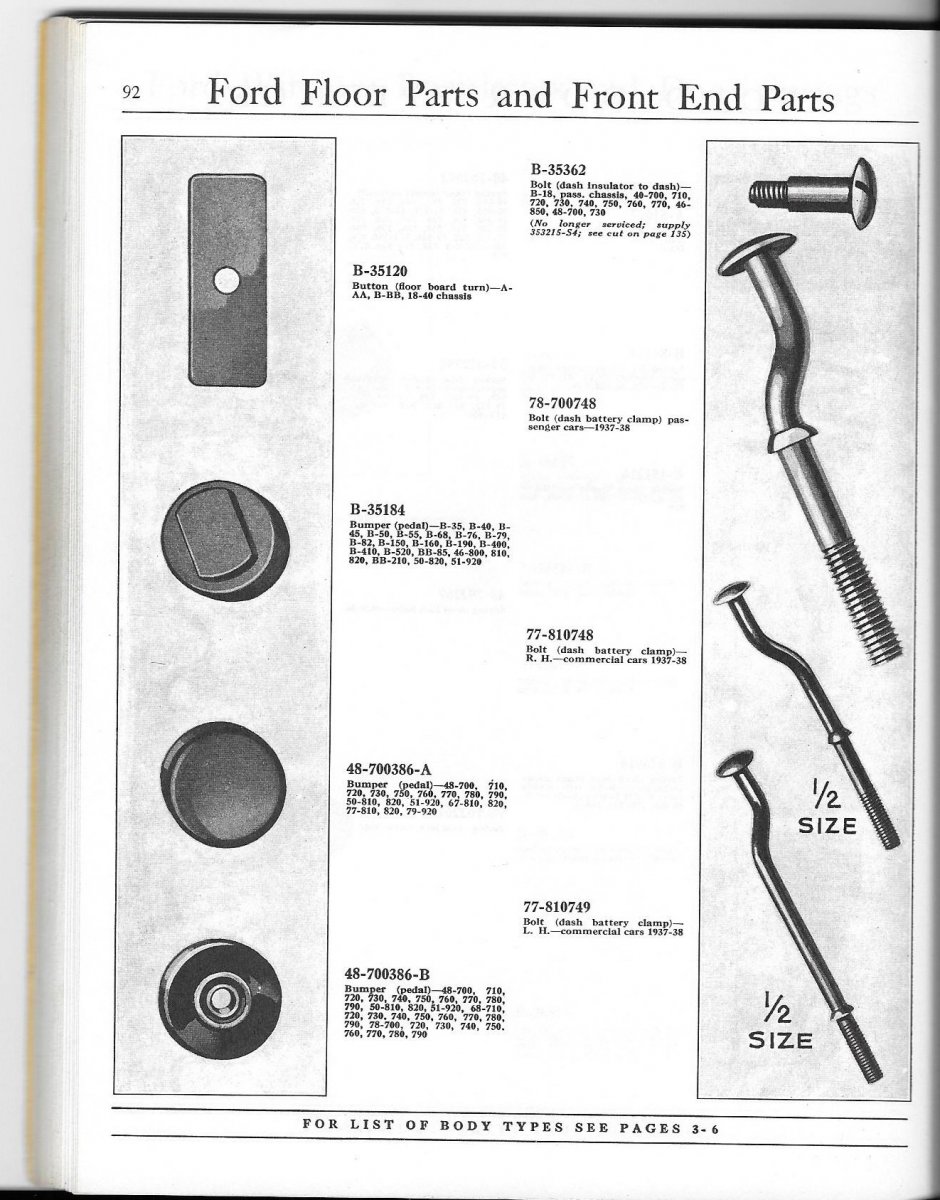

    Looks like p/n 78-700748, bolt, battery clamp, 1937-1938 . I found it in the Automotive Hardware and Trimming Supplies, 1928-1938 Ford small parts book.
    It is actually described as bolt (dash battery clamp) because Ford described firewalls as the "dash" for some reason.

    A-5155 is listed as "bolt, battery support" 1928-31. List at Ford is four cents each, or 100 for $3.00, so don't let'em rip you off.
