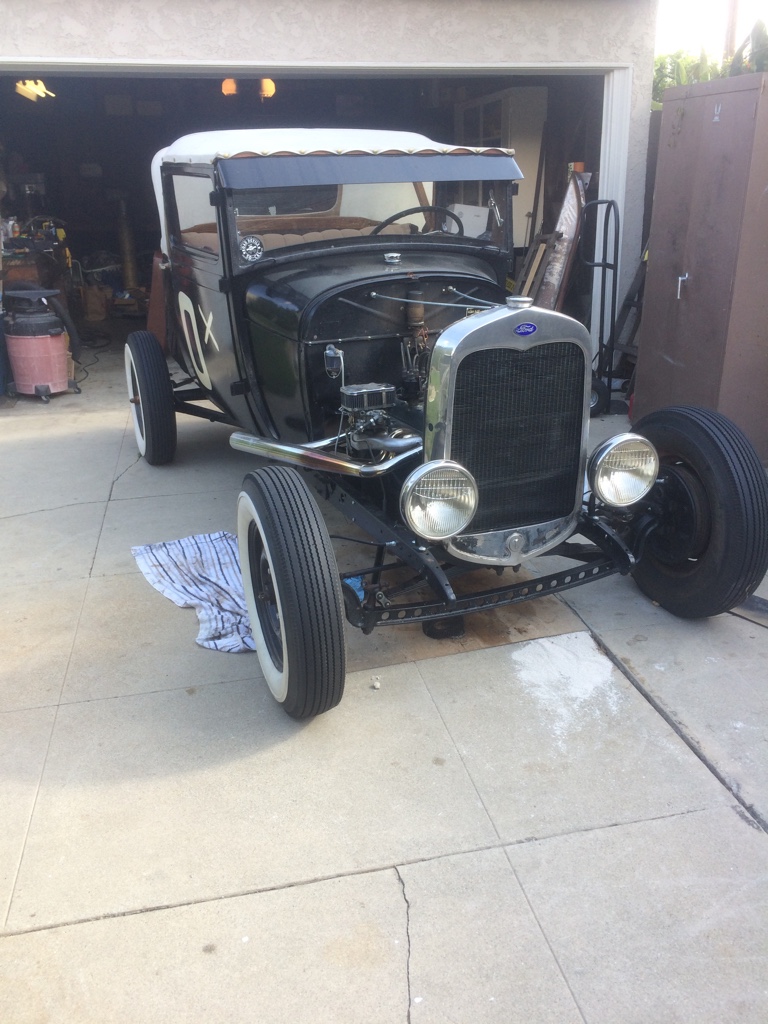

    She's back together and running! Grill shell on as well, still looking for a 28/29 radiator.

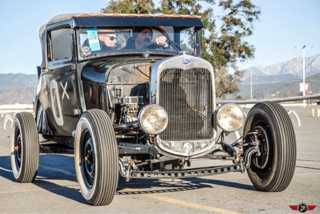

    Been a while since I've posted, been having too much fun!
    [​IMG][​IMG]

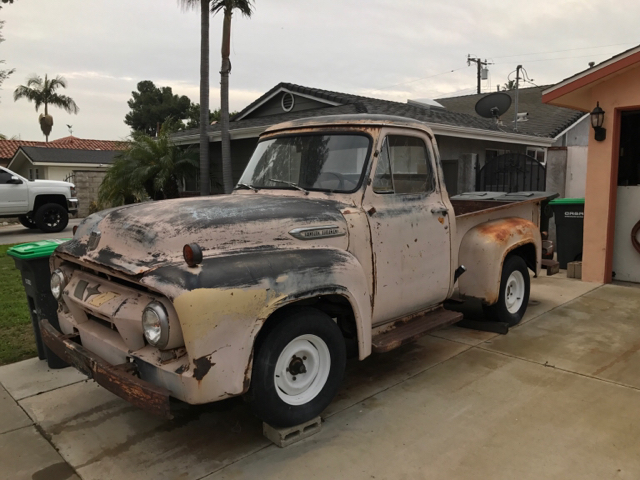

    Annnnd I bought a new project! 54 F100! Build thread on that to begin soon!
    cactus1, waxhead and ROCKER77 like this.

    Looks like you have been loving your car. What are your plans for the truck?

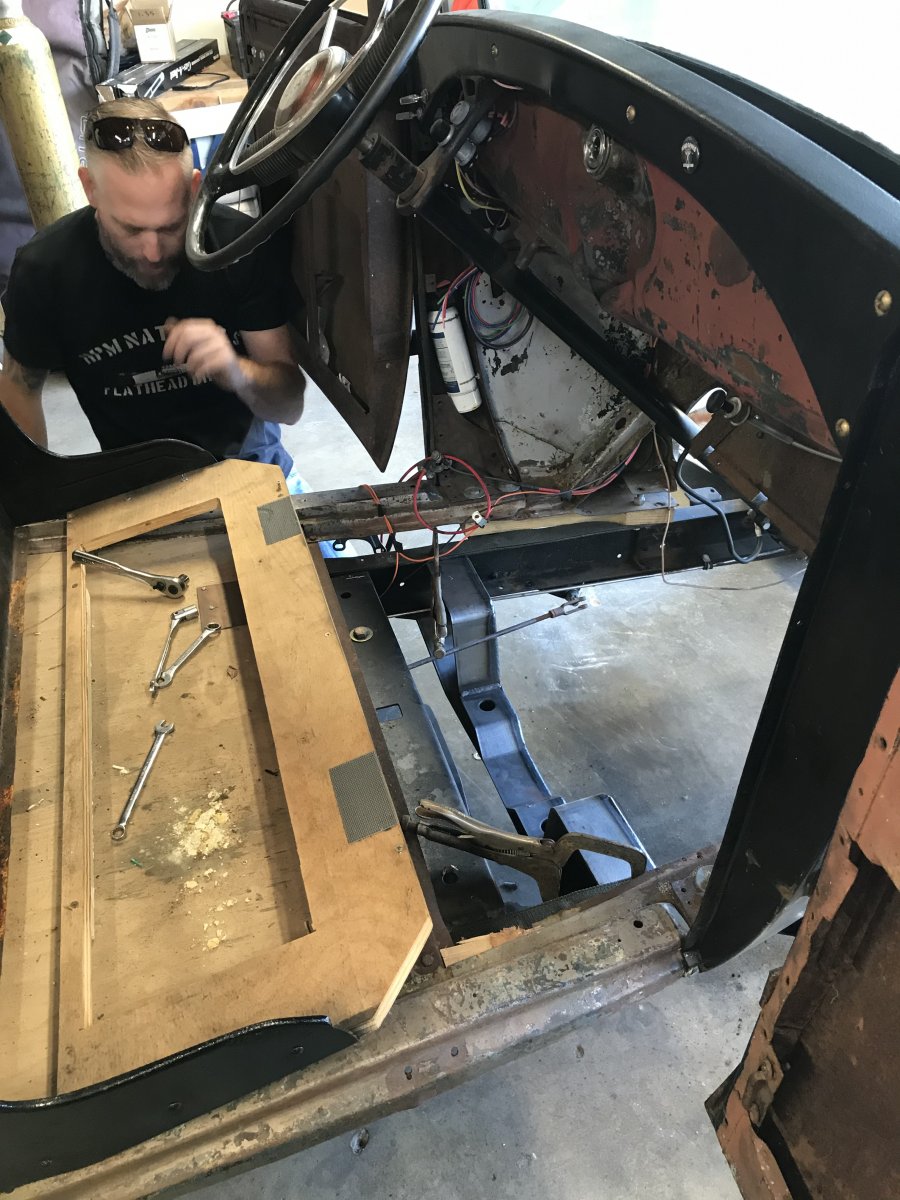

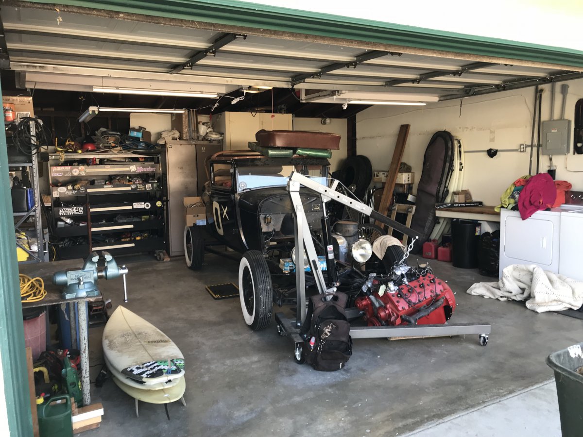

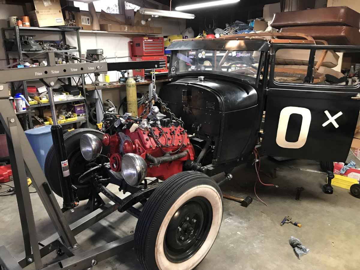

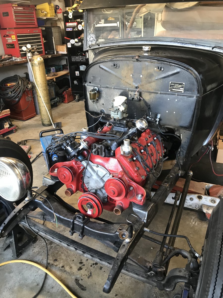

    Got the crossmember in, transmission buttoned up, and almost got the motor in. Ran out of time this weekend but will make more progress this week/weekend. Joe Leroux came over to give me hand as well. IMG_2087.JPG IMG_3797.JPG IMG_4070.JPG IMG_4392.JPG IMG_5835.JPG IMG_5959.JPG IMG_5964.jpg IMG_5965.jpg IMG_5968.jpg IMG_5969.jpg IMG_5970.jpg IMG_5973.jpg

    Got the motor mounts in, carb on and a few other things. I welded a plate from the outside of the motor mount onto the outside of the frame. Probably still needs a couple more little triangulated gussets but it is at least sitting where it needs to be. I ordered up an electronic ignition and I'm contemplating getting a PowerGen or just rewinding the field coils in the generator so it is negative ground. I'd then need a voltage regulator. Next up is to correct the caster on the front axle and get the steering all dialed.
