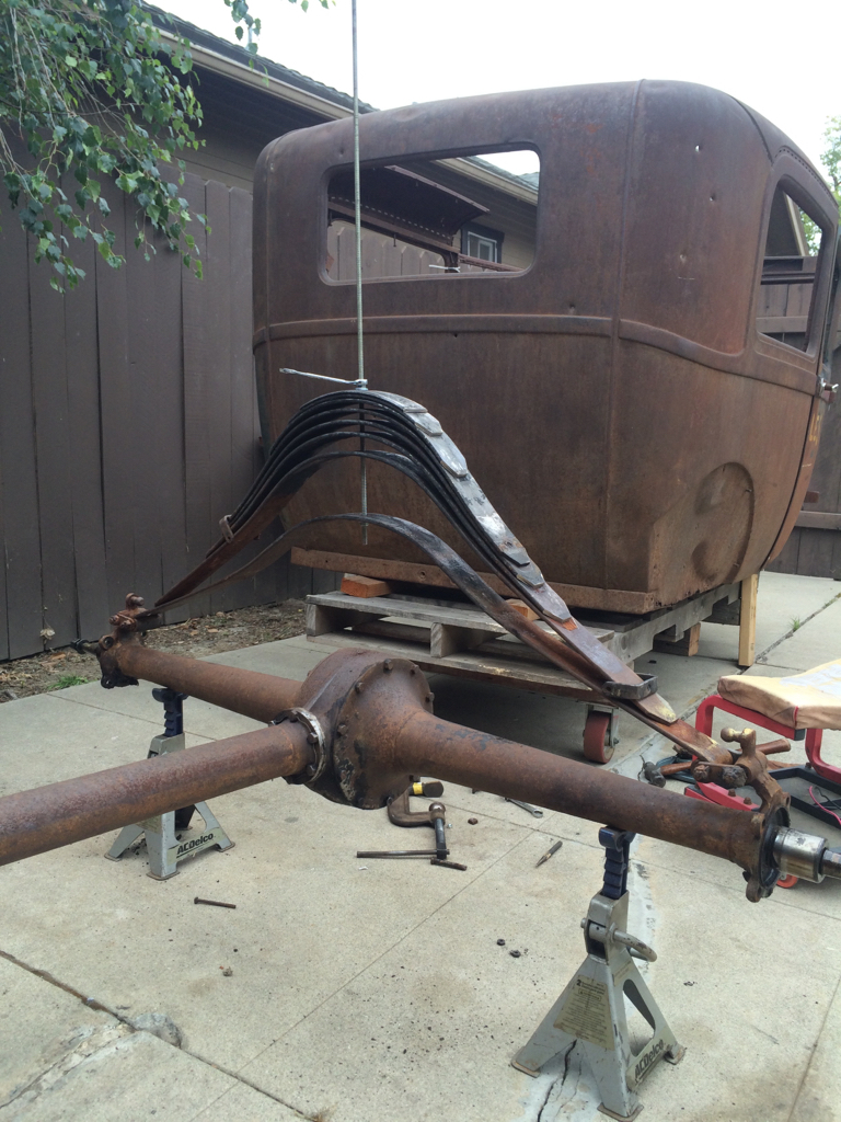

  4. I use 8" old made in USA ones so 5" might work. If you want to you can also wrap a chain around it for add security. Only picture I have of the spring semi apart.
  5. kevinwalshe
    Joined: Apr 22, 2010
    Posts: 428
    kevinwalshe
    I figured I would post this since I didn't see any pictures a spring being taken apart. Not too bad, just had to be patient and careful. ImageUploadedByH.A.M.B.1433097441.271617.jpg
    This is the spring with no load on it. You need strong 8" clamps to keep a safety blanket in case the 5/16" all thread lets go.
    These are toast. Time to order new ones or find some NOS.
    ImageUploadedByH.A.M.B.1433097615.908094.jpg ImageUploadedByH.A.M.B.1433097633.625593.jpg

  8. höllenteufel
    Joined: Jul 16, 2014
    Posts: 65
    höllenteufel
    Worked out good, as I see. I built myself a tool to do this when the body is still on it. Pulled the body up, put my own tool on it. The I pulled out the centerbolt and just opened the nuts on the tools slowly till the spring was completely without tension. Worked pretty good. You can see it in the pics.
    I put an 8 leaf Model T spring in it and removed the third leaf. The first leaf I replaced with the original Model A leaf to use it as a spacer in the crossmember, cause the T spring is smaller.

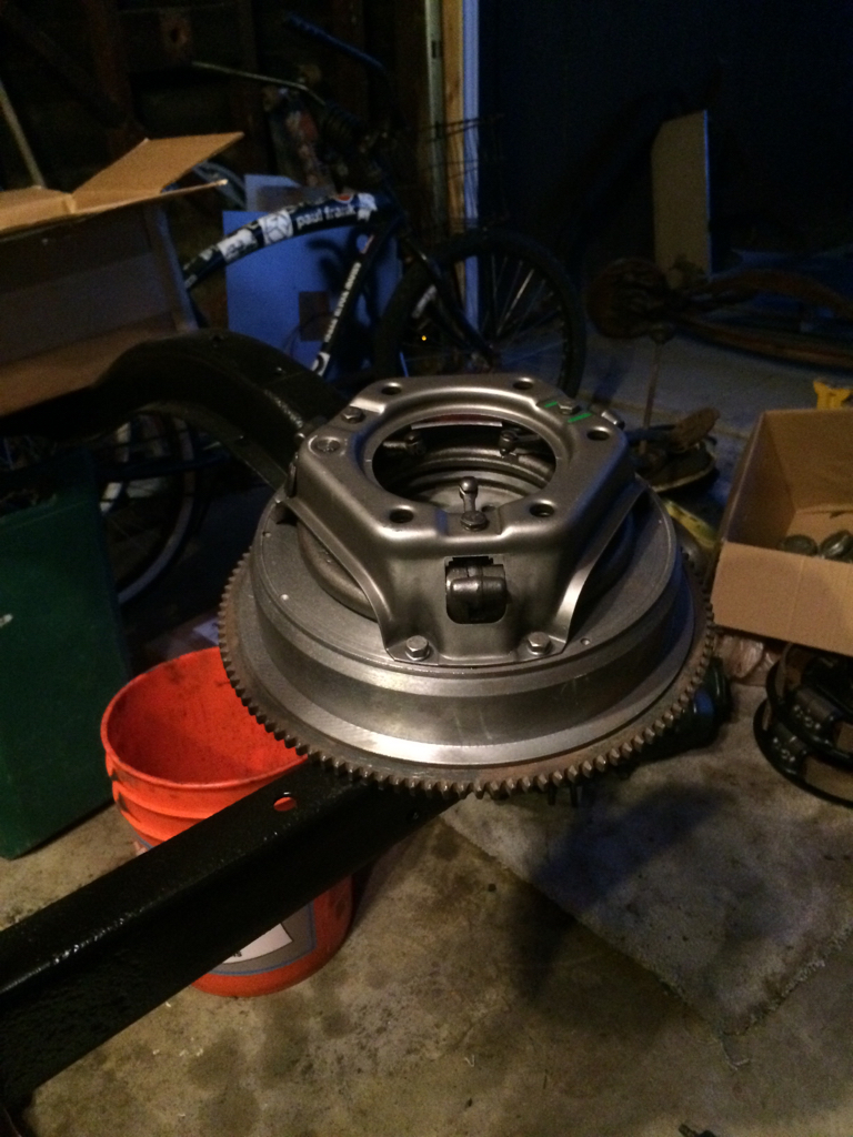

    Finally!!! After getting the run around with the machinist and balance shop, I finally have my flywheel back 20 lbs lighter, and balanced with the 9" V8 clutch. Ready to get this old banger reassembled!
    Before...
    After...

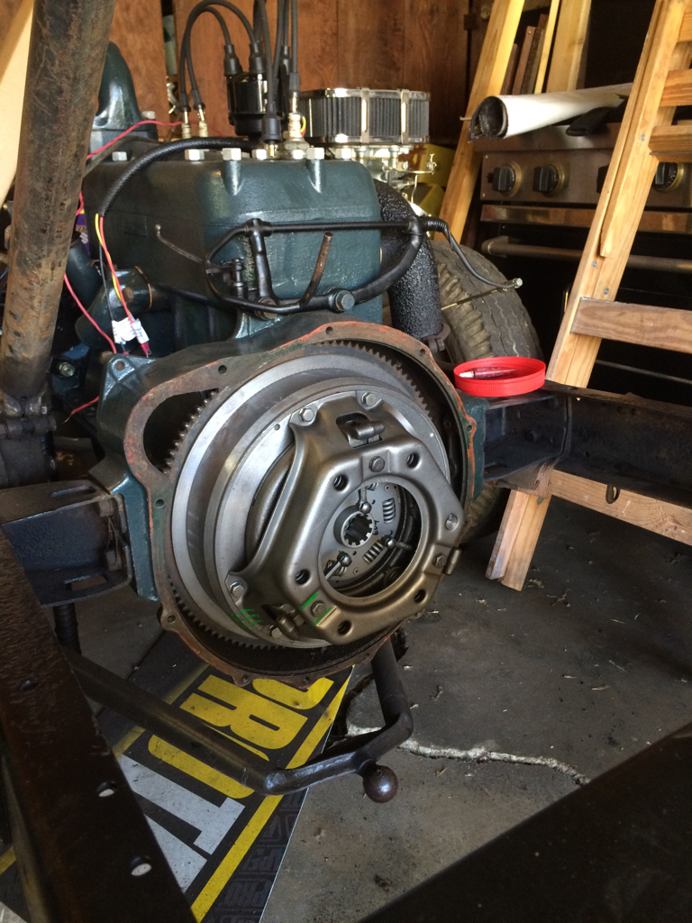

    Flywheel bolted up and safety wired.
    9" V8 clutch bolted up.
    About to lift this heavy sumbitch into place...
    Yep. Looks about right.
    That's probably it for today. Might get a second wind but my garage is like an oven at the moment.

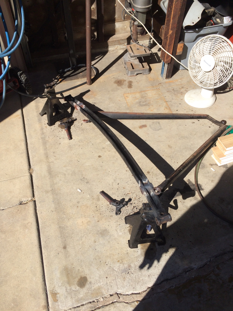

    kevinwalshe
    Read a good thread written by @NealinCA about how to remove the spring perches. Heat them up and give em hell. ImageUploadedByH.A.M.B.1443306872.754963.jpg
    ImageUploadedByH.A.M.B.1443306898.352762.jpg ImageUploadedByH.A.M.B.1443306916.153553.jpg ImageUploadedByH.A.M.B.1443306931.306225.jpg
    volvobrynk and ROCKER77 like this.

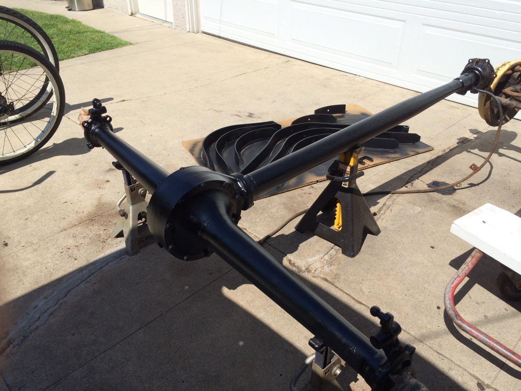

  27. kevinwalshe
    Posts: 428
    kevinwalshe
    Cleaned and painted the wishbone, this time very thoroughly and started assembly of the dropped axle. I have to clean all the gunk off the spindles and tie rod in the morning. I'm waiting on the new shackles to arrive. ImageUploadedByH.A.M.B.1444540656.634781.jpg
