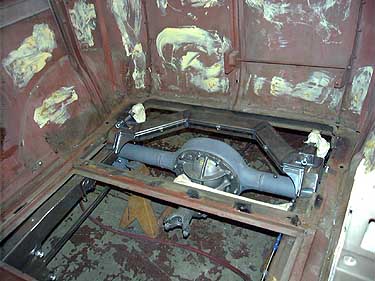

    My frame is kicked up 3" and is narrowed as well. This keeps it inside the sub-rails. Picture was taken 15 years ago, so it's not the best.

    here's what I did. cut the subrail at the rear hump and lowered the body till it sat on the brookville flat top frame. used a piece of bar bent to fit the hump. used body pad on the whole frame top. 9.JPG DSC00358.JPG I like the way it came out.

    some more pics of the trunk area.

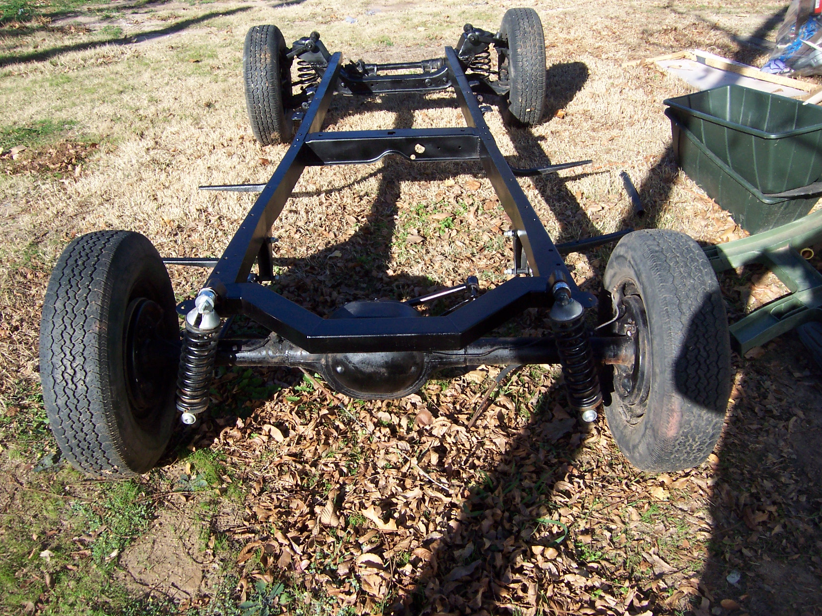

    EBAY1 044.JPG EBAY1 044.JPG EBAY1 045.JPG EBAY1 045.JPG EBAY1 045.JPG EBAY1 046.JPG EBAY1 046.JPG EBAY1 045.JPG EBAY1 045.JPG EBAY1 046.JPG This one is a little different. I did not pinch the back rails to fit the crossmember I bought. Added some metal to it. Everything boxed, welded and ground smooth. It is not finished as can be seen. Maverick rear and Mustang II front.
