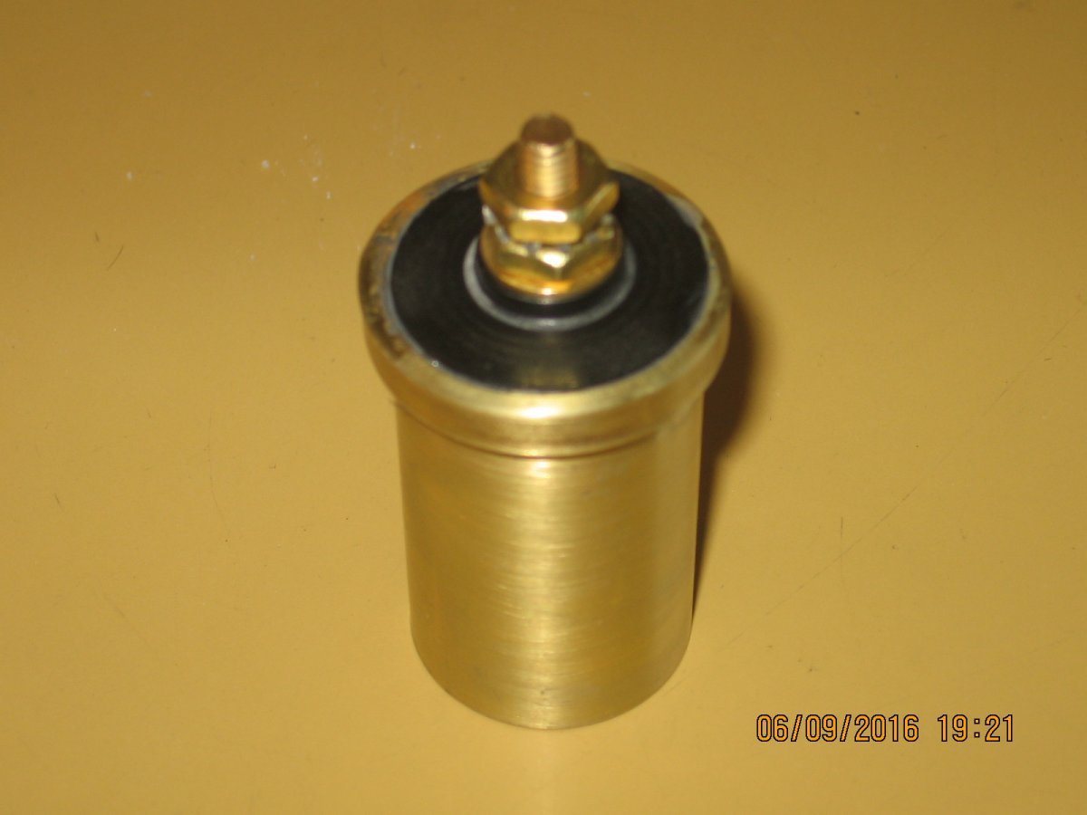

    If you can't find good condensers, do what I do : Make your own! IMG_0738.JPG IMG_0977.JPG
    I can make you some, too.

    I've seen those condensers!! look cool. it's not that we can't get the parts anymore, it's that condensers=capacitors and the problem there is that there has been a big problem getting high quality capacitors like they used to make.
  21. tubman
    Joined: May 16, 2007
    Posts: 6,956
    tubman
    Just to be clear, we are building these condensers using modern Film Capacitors rated for "Severe Duty". These units are designed and built to function properly and survive under adverse conditions. This means older conventional ignition systems with generators and solid core plug wires and the attendant spurious voltage spikes. We have had these units in field test for two years. Early on, we had a couple of failures that allowed us to gain the knowledge required to improve this product to a very high level of reliability. I have been running these on my own vehicles during this time. We currently have available a .22 mfd unit that is suitable in most conventional ignition systems. We have also developed a .33 mfd unit to be used in early Ford distributors. I get $50 for the .22 mfd units and $65 for the .33 pieces. The reason for this price disparity is the much higher cost of the .33 mfd capacitor that will fit into our packaging and still meet our stringent requirements.
    Anyone having any interest in these units can PM me here.
