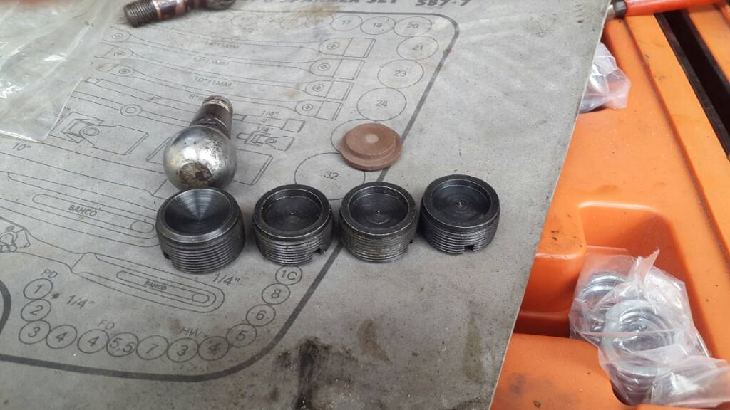

    Hi.
    Have purchased a teflon repair kit for the tie rod links for 32 ford. [​IMG]
    The nut on the left is different than the other 3. Am i missing something?.
    I cant find an exploded view of the assembly, and doubt it was put together correctly originally.
    Also. Is the ball link the same between steering arm and tie rod.
    Best regards
    Kim mortensen.
    Sent from my SM-G850F using The H.A.M.B. mobile app

    Does the Green Book diagram help any?

    Yes actually! But still cant figure out the different nuts.

    That plug looks like and old style no insert plug. More like is what is on my 48 Chev than what the Ford green book diagram shows.

    Ok. Hazzled with the ball joints today, as i could do one side. I found that the ball was badly warn, so a new one is needed. However i notised from the setup that depending on how much i tighten the link adjusting screw, i change the toe in setting. And that goes for both sides. If i tighten the nut i do toe out, this cant be a right setup.
