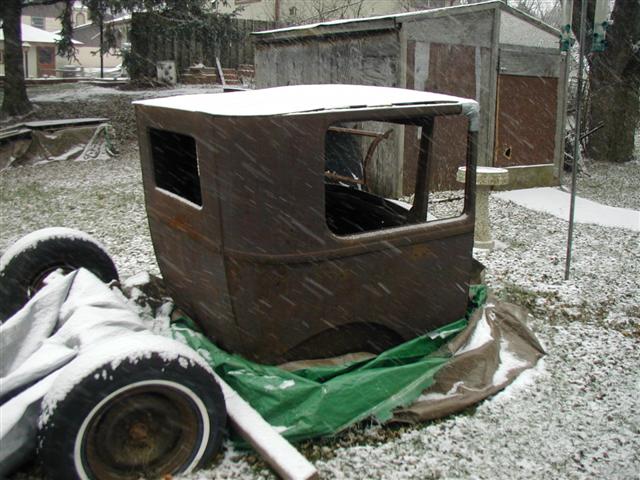

    So if I say something like it was in the barn at my uncles farm, its all good? Not sure anyone would believe me if I say it was at my house when I bought it...I live in the city.
    Does it matter if the car with the VIN is complete? It is mostly all there but has no interior, the engine isn't complete...etc...
    here is a picture:
