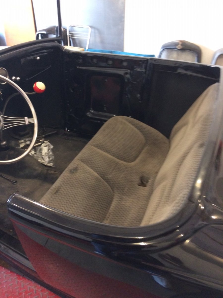

    I put a 99 Caravan middle seat in my 31 roadster and it fit great. I used some cheap tracks from Speedway and set the back so it will go under the rear panel part ways at the rear and it goes 7 inches forward. If I scoot it back, at 6' 2" I can't quite reach the pedals so if you set the seat right, you can have plenty of leg room.

    wow that really turned out well.--Thanks---Jim
