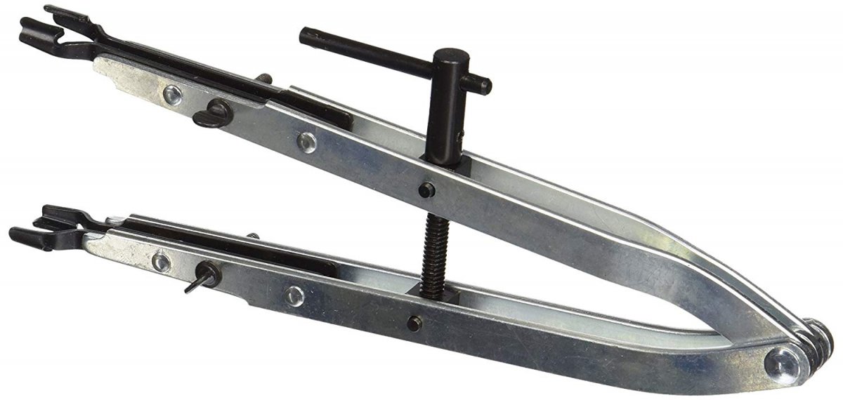

  20. Lloyd's paint & glass
    Joined: Nov 16, 2019
    Posts: 10,440
  21. PhilA
    Joined: Sep 6, 2018
    Posts: 2,104
    PhilA
    1. Hydro Tech
    Yeah, that's the type that would work.
    Phil
    mrspeedyt, chryslerfan55 and loudbang like this.
