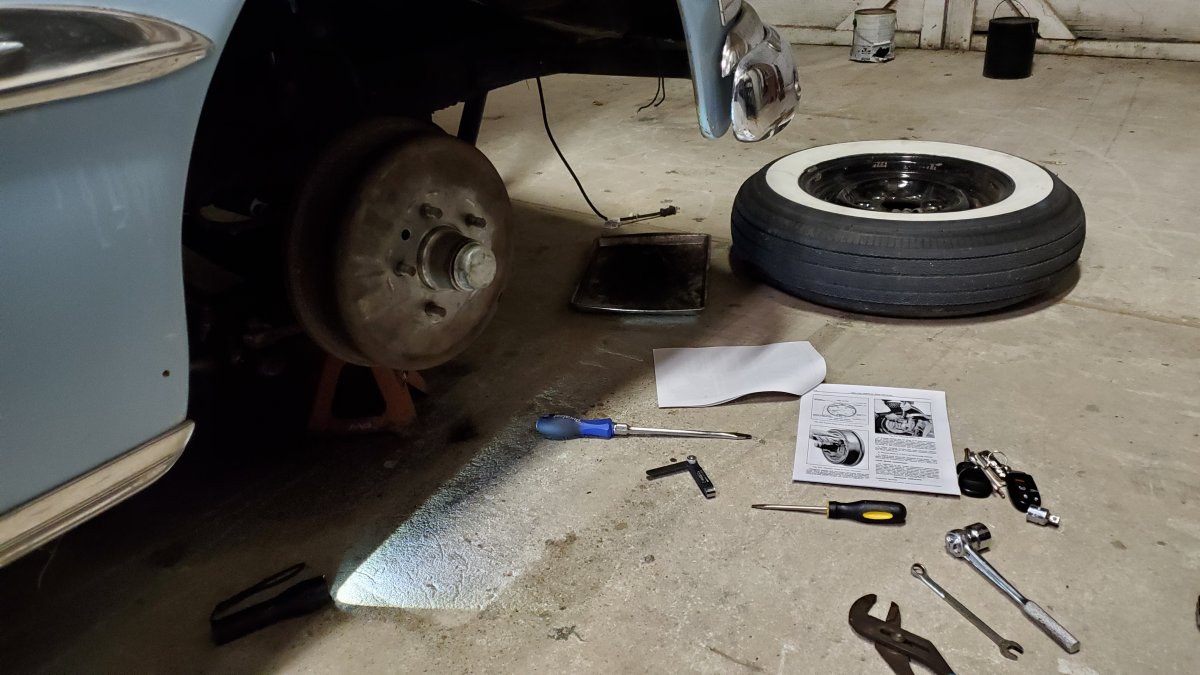

  3. PhilA
    Joined: Sep 6, 2018
    Posts: 2,066
    PhilA
    1. Hydro Tech
    First car I've had with manual drums all round, so I'm still working on gathering tools. All the rest of my cars I've never had to routinely adjust (all self adjusting) and taking them apart a screwdriver was what I'd use.
    Phil

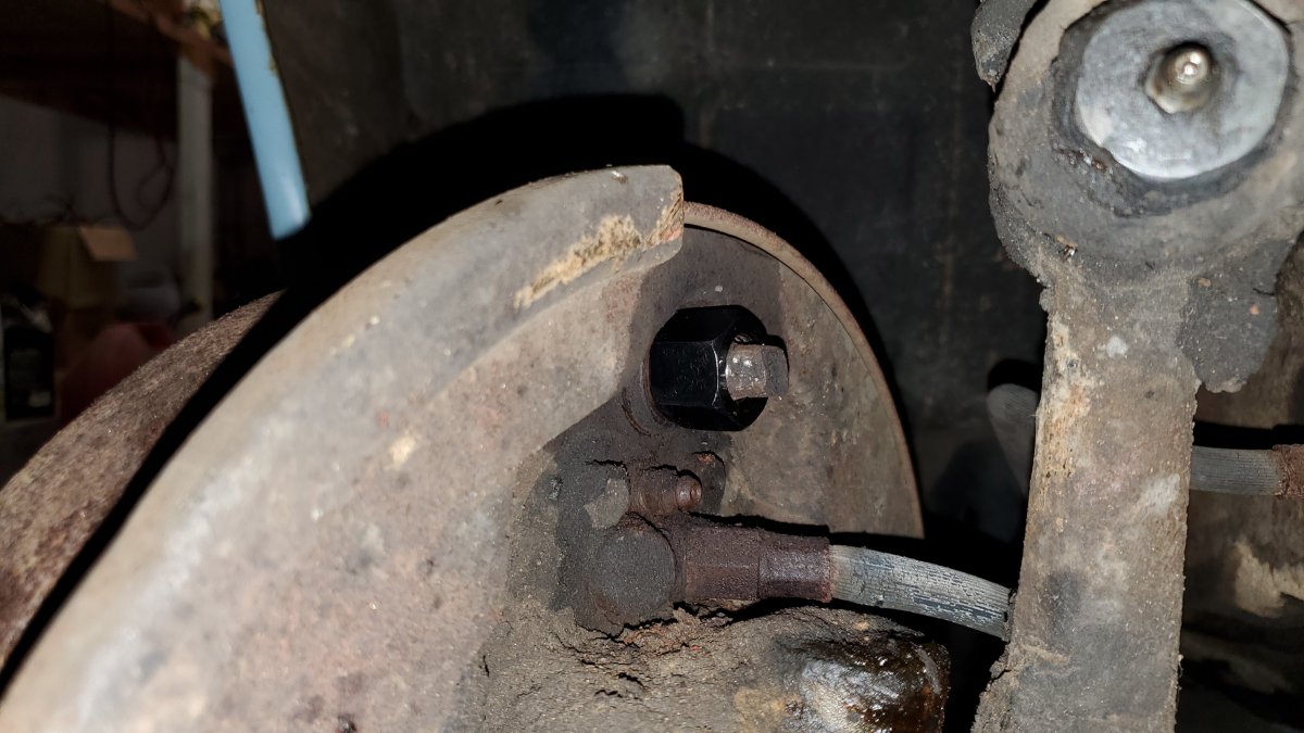

  7. PhilA
    Joined: Sep 6, 2018
    Posts: 2,066
    PhilA
    1. Hydro Tech
    Refitted the anchor locknut. It looks out of place. Worry not about the wetness, that was releasing oil trying to get the thing undone.
    Leading shoe touching, trailing shoe 0.015"
    Tightened up, that'll do
    Ordered a rotor arm, it's gotta be tracking off the back of this one- checking with strobe light shows 8 and 1 sparking simultaneously- they are opposite each other on the cap and that's about the only way that can happen. I pulled #1 wire out of the wiring bundle and set it aside so it's not jumping across wires (turned the lights out and looked for arcing).
    It'll run, eventually. I have a source for a twin-points setup that fits this distributor, which should help, given how busted up this one is.
    Phil

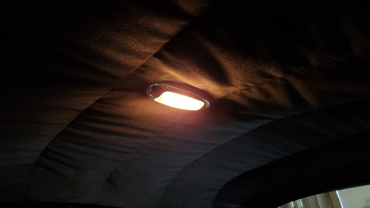

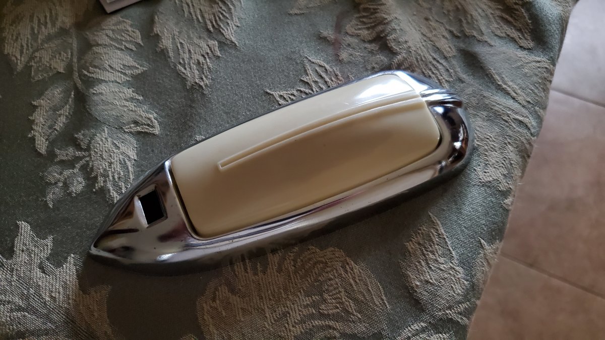

    1. Hydro Tech
    Well, today has had a perk.
    This arrived in the mail courtesy of another HAMB'er. Interior light bezel and lens!
    I couldn't resist going reconnect the battery and putting it in place at lunch.
    Looks sharp. Apart from the carpet on the back shelf below the window, that finishes tidying up the interior.
    Thank you!

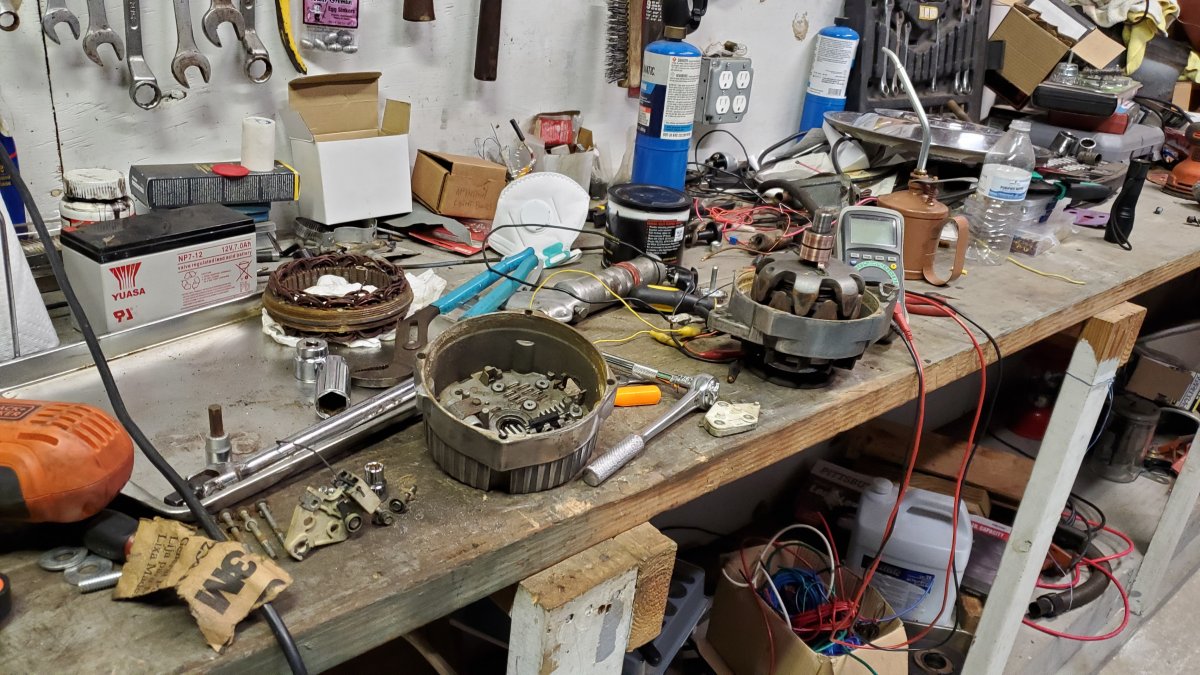

  28. PhilA
    Joined: Sep 6, 2018
    Posts: 2,066
    PhilA
    1. Hydro Tech
    Rotor arm arrived. Fitted that, no real improvement, as expected. Cranking over with the air filter removed the choke wobbles and snaps. The valves aren't doing everything they should for sure.
    Removed the old diode trio from the alternator and fitted the new one.
    Spun it over to 1500 rpm and nada. Regulator pack gonna be bad then. Cleaned up the slip rings, the regulator pack popped open which is a bad sign. I guess someone connected it all up backwards or shorted it out at some point.
    I'll get another regulator. If that falls I'll see about getting another 10SI. Gonna keep with this model because I know it fits and I now have spares...
    Phil
