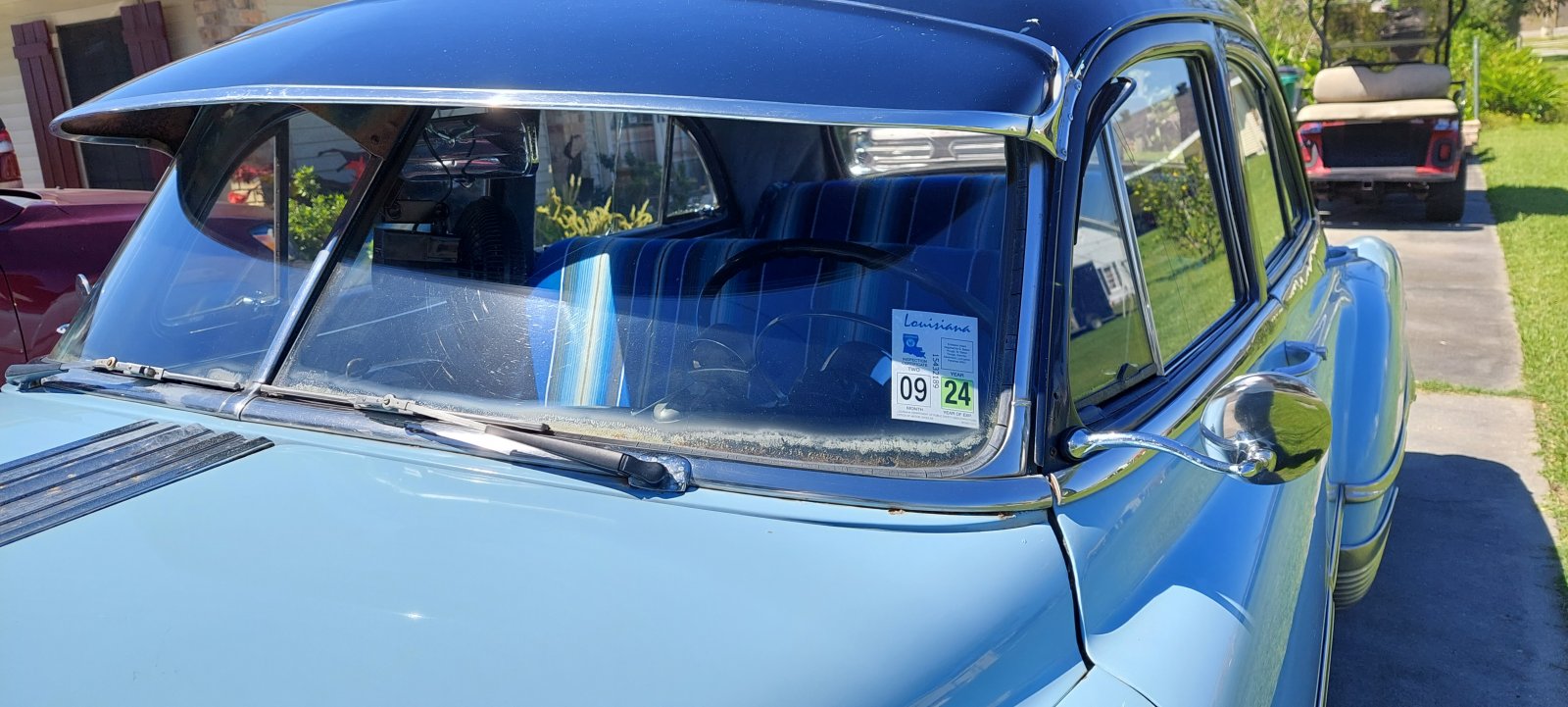

    Haven't really been doing much but driving the car lately. Did look at the screen defog because the passenger side wasn't working. Turns out the trim was bent and it was blocking the air. Bent the trim back, got air.
    And yes, down here, in a 95 degree rainstorm you do need to put the heater on full and cook yourself to be able to see outside...

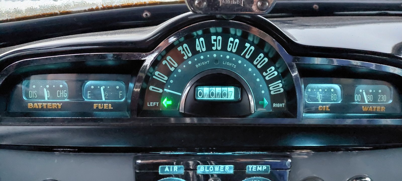

    Tonight I was amused. At the end of the street I rolled over 070707 on the odometer.
    Oil change up soon. Been working mostly on the OT project.
  3. Your light bulb condoms sure improve the gauge lighting.... I like it!

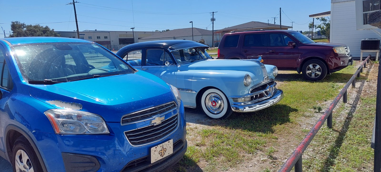

    Just went to the store, walking back through the parking lot I had to smile.
    A blob of color in a sea of monochromatic porridge.
    Phil

  9. What is it about the dashboards and gauges on the old cars? I've always wondered why people change them out and put aftermarket gauges or (**GASP**) digital gauges. There was so much chrome on them, the lettering and numerals of the gauges and their layout, the shape of the dash--it all seemed perfect. Maybe even magical. Those were the days!
    Great car @PhilA! I've enjoyed following along on your thread! E
  10. PhilA
    Joined: Sep 6, 2018
    Posts: 2,066
    PhilA
    1. Hydro Tech
    These gauges are pre-permanent magnet devices. So, they're balanced with one coil across battery and another at right angles which is modulated by the sending unit.
    Issue 1, the temperature sensor is a small range device by today's standards, modern ones having teens of thousands of ohms cold and a few thousand hot. This one was about a thousand cold and several tens hot. They were unreliable.
    Issue two, the fuel gauge works "upside-down", across a very small range of value. Full tank the father reads full from about 5 Ohms. Empty, it reads from about 30 Ohms. Modern senders work usually in the range of several hundred Ohms empty, fifty or so full. It's easy to short the sender out and burn it out on these.
    Issue three, 35-0-35 amp ammeter.
    Once those three gauges are inoperable, they're often junked because it's too much hard work to make them work right.
    I like the way they look so repaired them. Don't know many Chiftains with fully working dashboards...!

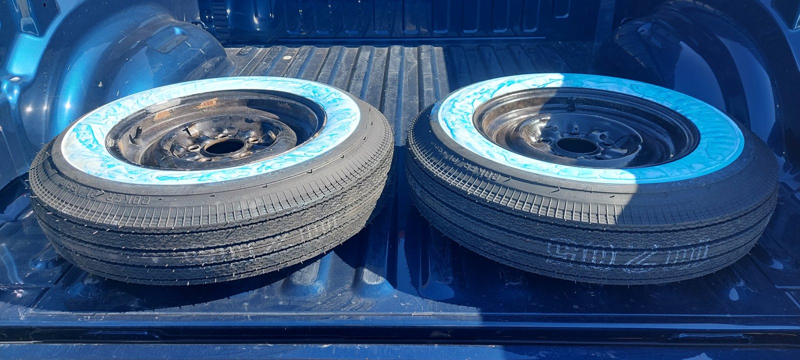

    Took two wheels and the tires to a local shop tonight.
    They called to say I should take one rim back and clean it as the bead edge was rusty and they weren't confident it would seal without being cleaned.
    Scrubbed it down with the old Cheek-Poker 4000 and brought it back. A lot of what looked like rust was actually chunks of the tire stuck to the rim.
    Hopefully tomorrow I get those back. They gave me $20 off because I brought them the wheels without them having to pull them off the car and find space in their workshop.
    Giving the tires a more critical look, the alignment isn't actually that bad, just the tire pressure was a bit low on the front. The shoulders have worn almost evenly. The front tires were a bit worn when I got them, so with a few more pounds in the new ones should last.
    Still need a front end rebuild and a full realignment, though.

    Two new whitewall tires, now with 100% more tread!
    Bolted on and scrubbed up pretty.
    To top it off a brand new safety inspection sticker. That'll work.
