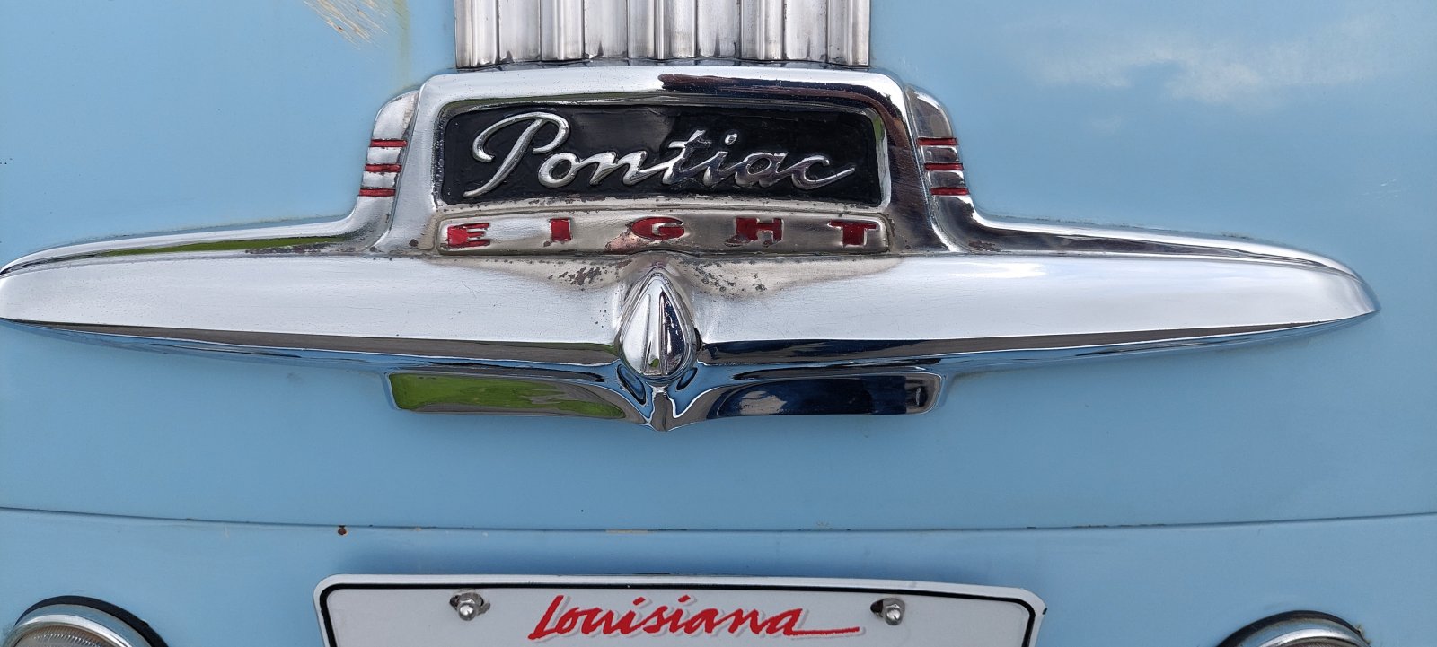

    A few cool minutes this evening before the sun fully went down.
    The chrome is well past its prime, and sitting outside hasn't done it any favors.
    Gentle application of light abrasives sees the large patches of staining gone, which account for most of the rusty look. The pits by themselves are quite small in comparison.
    Couple coats of wax to try seal it up a touch. I'm going to come back to the big bare steel patch tomorrow with something a bit more aggressive.
    Phil

    Nice job on cleaning up the chrome,

  4. Try scrubing the rust with aluminum foil & window cleaner, you will be surprised and you probably all ready have some. Best thing I've found for rust on chrome.
    PhilA likes this.

    I had tried that and found the foil to leave scratchy marks? Possibly the chrome is a bit thin (I know it is).
    I have a light felt tool on my Dremel that allows me to carefully work with small areas with good control.
    Did a little more tonight, finished when the Dremel got too hot.
    Steady and slow, bit like the car.
    Phil

    Times 2 on "the glad you're back home"........and man that's some nice looking chrome :)
    PhilA likes this.

    Only because I took the picture from 15 feet away...!
