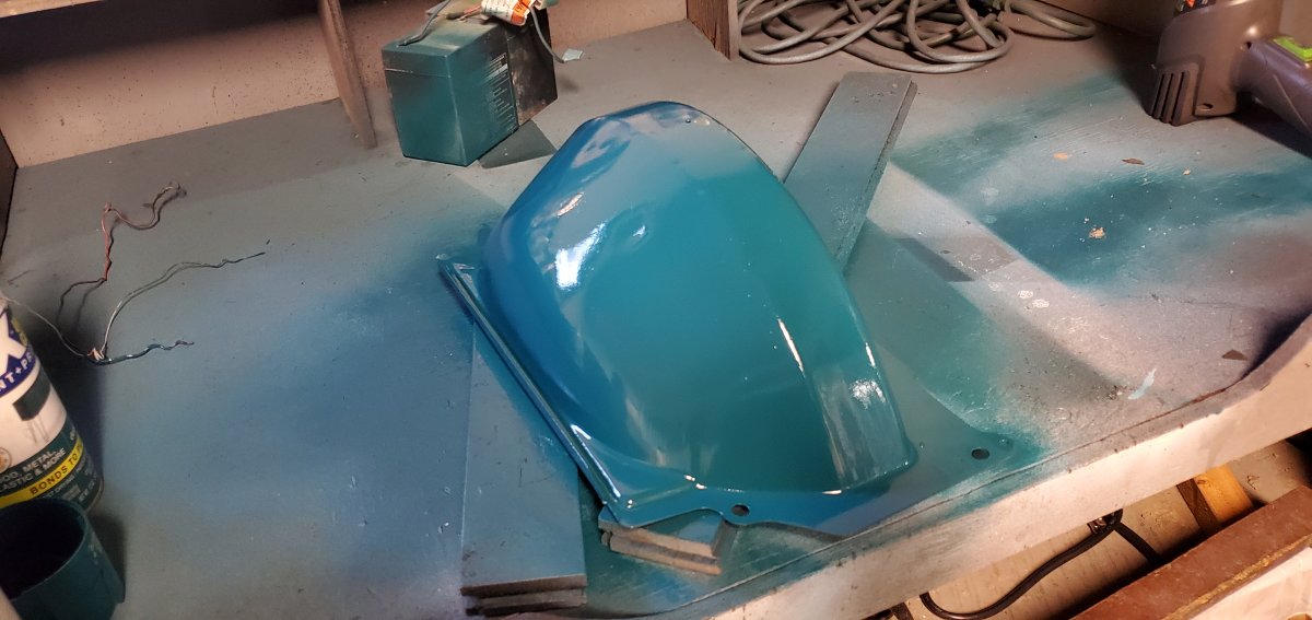

    I now have the correct sheet metal to go at the back of the engine, to protect the flywheel and fluid coupling housing from road debris.
    Going to clean it, paint it and get it fitted.

    1. Hydro Tech
    Before...
    After...
    Clean and drying now.

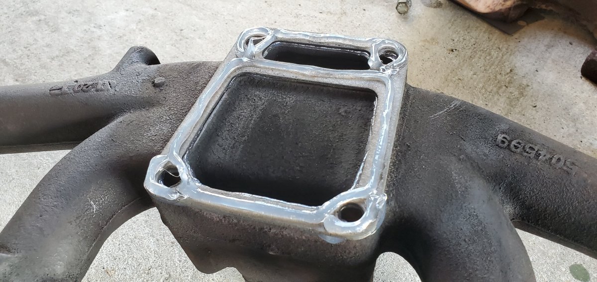

    Today, upon advice of some friends who build racing engines I split my manifolds. Reason? The join between the two isn't 100% flat and wasn't sealing well all the way round.
    Choice of sealant, racing engines? Clear silicone sealant. Yes, I didn't think so either.
    Added it to the gasket, tightened it all down again and refitted it.

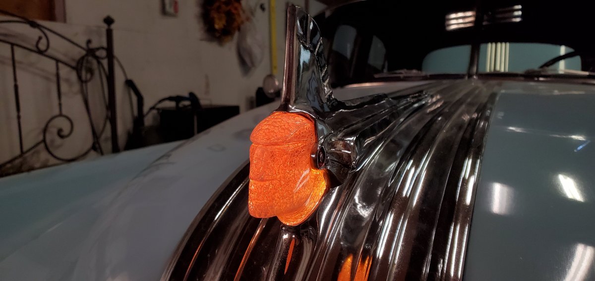

    Bald nose! I removed the Chief from the hood. Looks all bare and strange.
    Beheaded. You can see he's rather sun-crazed.
    Carefully sanded him as smooth as I dared. Added a few layers of clear coat.
    Refitted- now you can almost see through him.
    Illuminated he's a little better. That'll do until I can get a new insert.
    Phil
