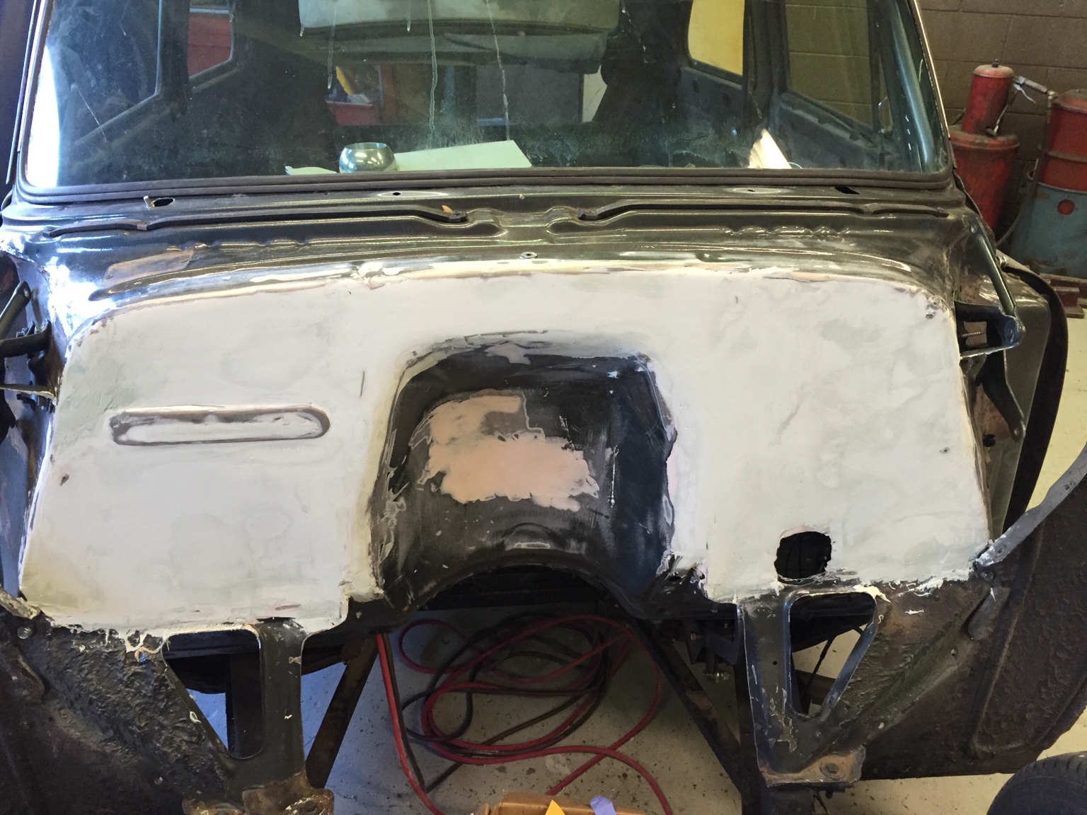

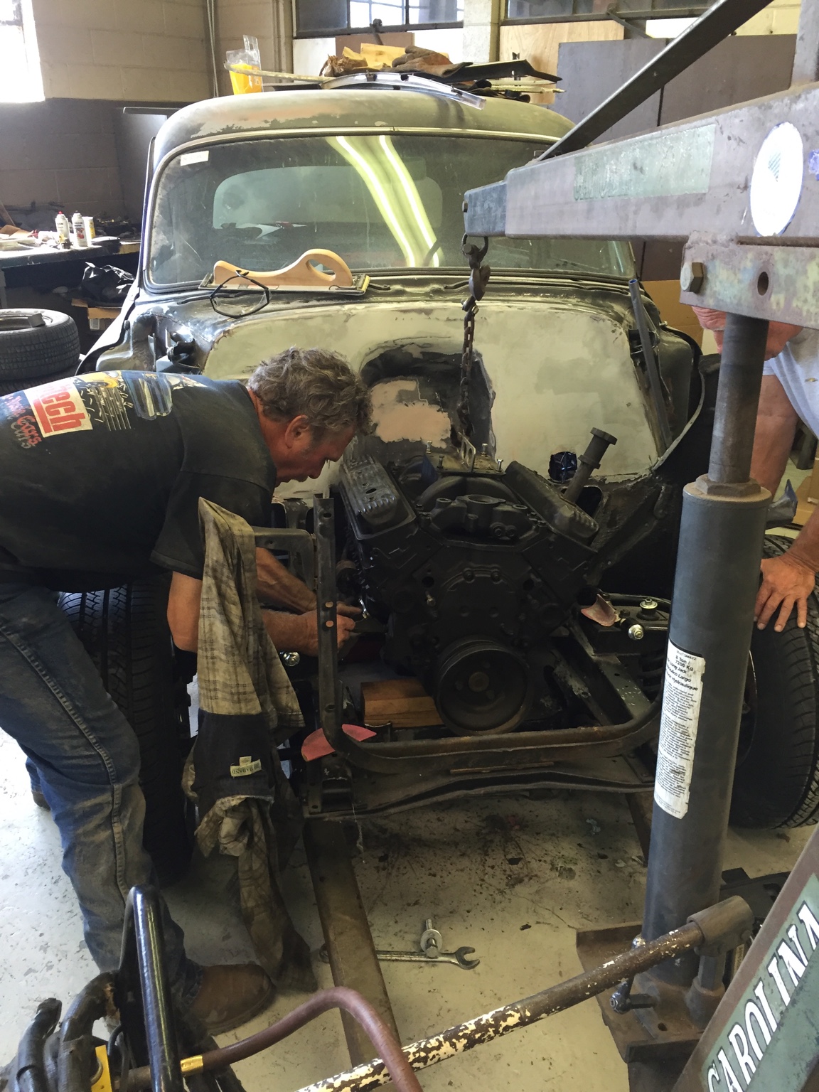

    The plan is to shave and deck the car. I will maintain the belt line, rocker and front and back glass trim. The firewall is smoothed and the car will be powered by a 305 vortec out of a 96 Tahoe and 700r4 transmission. The engine was sold to me as a 350 but a running of the casting numbers revealed it was a 305... It will work for now and I got a great deal on it so I'm trying not to be too upset about it. The vortec intake has been removed and will be replaced by a custom TBI set up. The motor and transmission are hopefully getting their first fitting next weekend. Updates to come

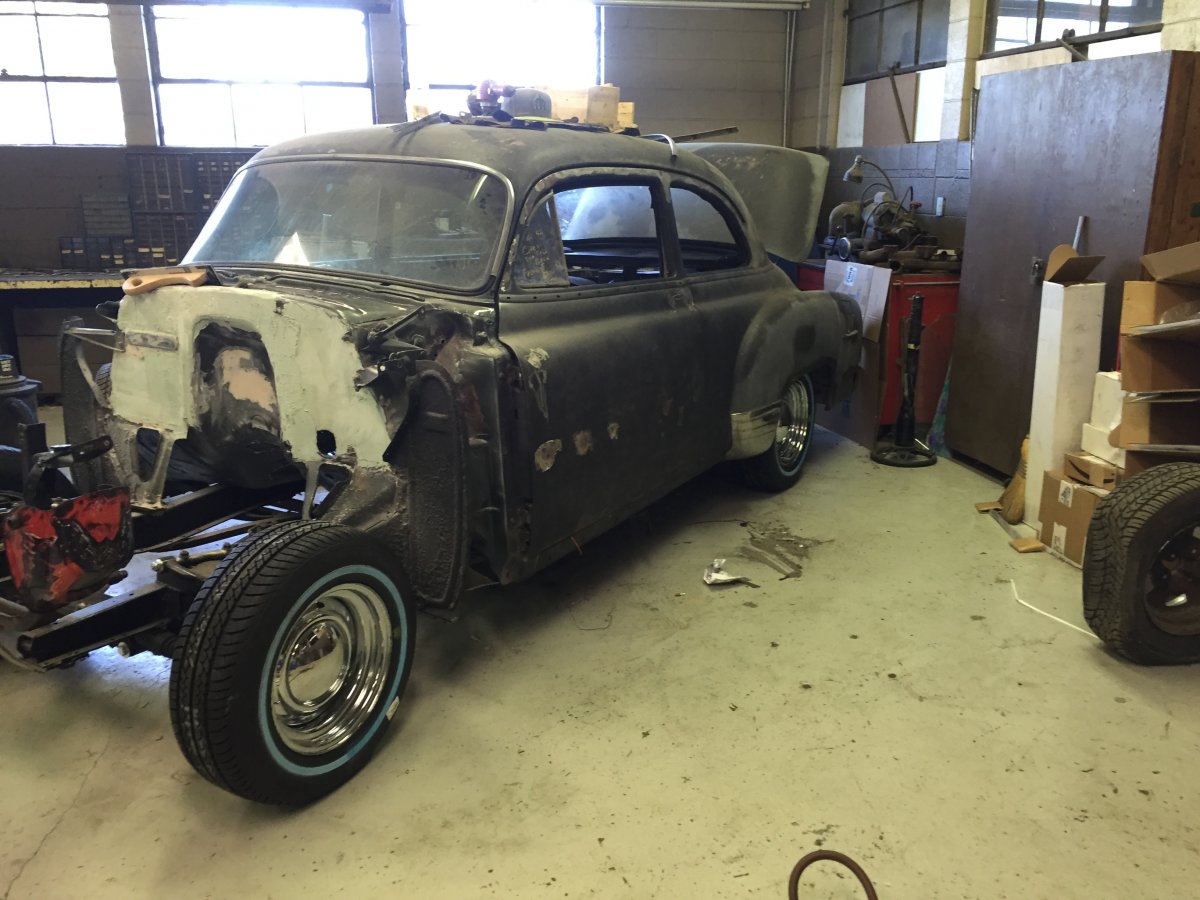

    Here it is prior to being torn down
    The seats had just been recovered prior to purchase as well as a new headliner installed and a new carpet kit. The seats will get the inserts redone prior to install as I'm not s big fan of the bow tie print.
    Everything from this post on should be in order.

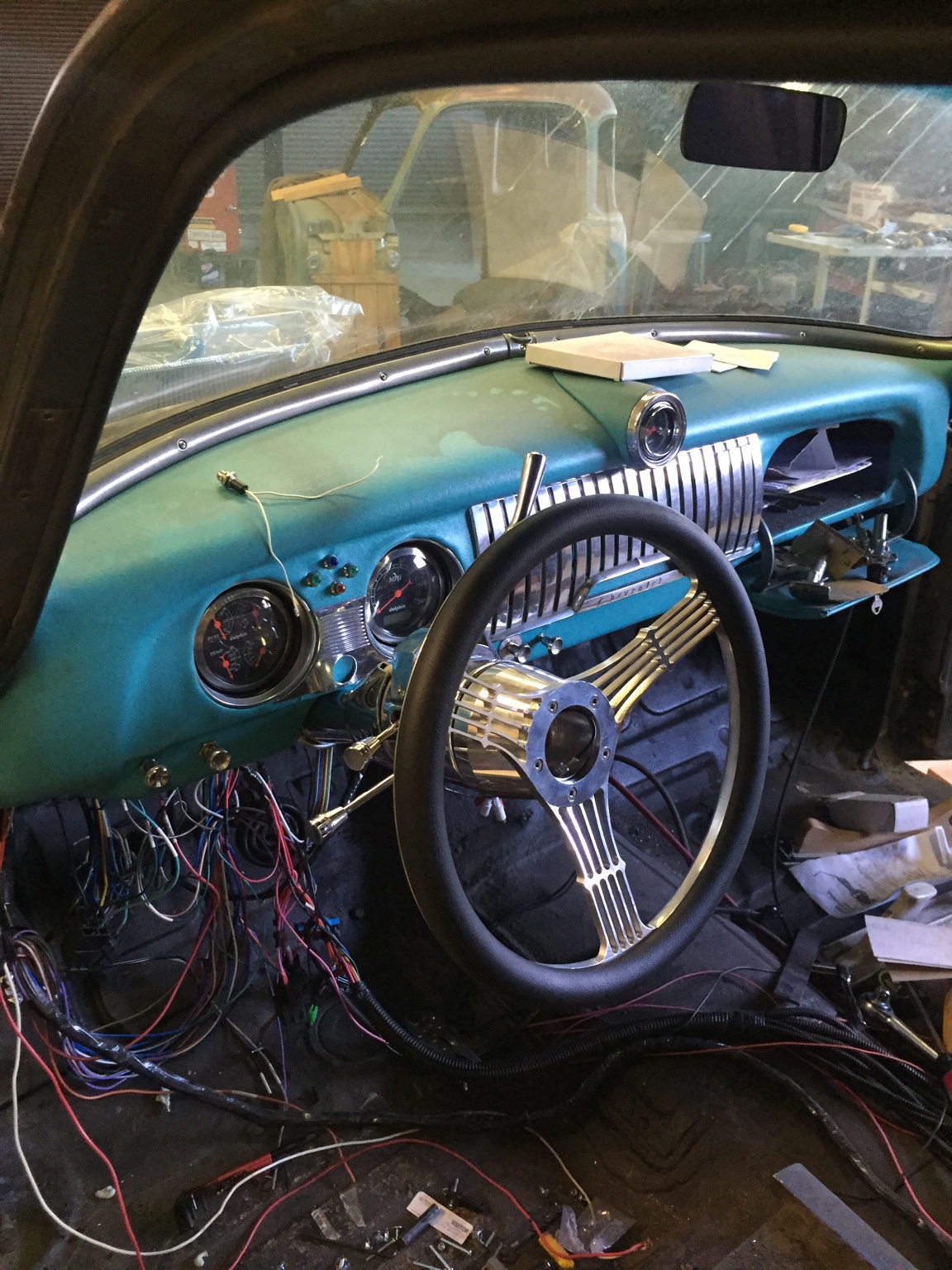

    Awesome, that is a very fair stance. A coat of paint is always an option down the road for the column. My end game is to have a car that looks like it could have been done in the 60s. The center console I built has an iPad that will be the stereo, but will be able to be hidden away when needed/wanted. Thank you for the input! I'd much rather hear these type of comments now rather than when the car is complete. Some might consider the gauges street rodish, but I like those and trust them over the 65 year old ones that were in there. Cheers!

    Little more work on the firewall
    Test fit of the motor and trans after fabbing up the brackets. [​IMG]

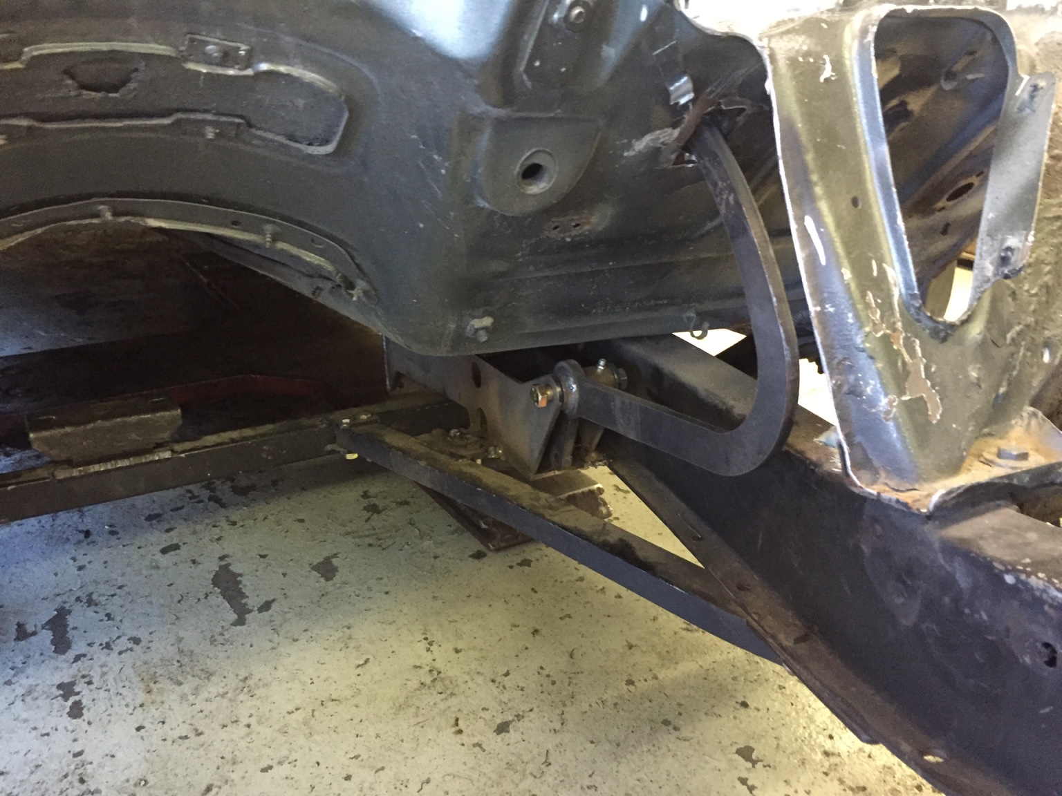

    Steering connected
    Column and wheel fit in. I know there are haters on these parts, I will likely get a different wheel down the line..

    Exhaust going to fit with the steering linkage in there? Tyler.... put a big block in my 53 so three u-joints a pillow block and cut a piece of pipe into the frame for clearance it fit... sweet ride man keep it up

    I am hoping it will fit, I have the frame mount master cylinder to contend with too. I ordered a set of hugger headers that come highly recommended for this application, so we'll see how it all comes out. This set up has a double u-joint at the spline and a single at the column. I'll get the big sockets and hammer ready in case the headers are going to bump the linkage. Thanks for the kind words! I'll have to track down some pictures of that big block you put in!
  24. Mate, I'm in a similar situation as yourself, and I get nothin' done. So billet's better than nothing. If it gets it to the road, go for it. I think that wheel and guages look OK, not mad on the column, but hey, if it works.. Times are changin' with me, I'm 50+, I aint so fussy no more on a few minor aesthetic details. Outside bodywork/ wheels, maybe more so.

    I can't even see the column, the wheel though.......you know, if they just rounded off the edges.....

    Yeah, the wheel is terrible. Do you know if a 50's Chevy wheel is a direct fit on an aftermarket column? I'm liking the 15" versions of the 55-56 or 57 wheels. That said, this one will have to work until the car is going and stopping under its own power.
