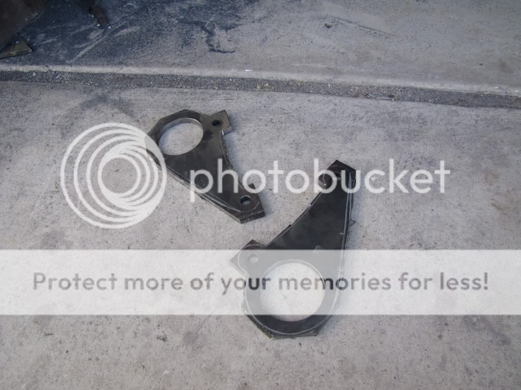

    After figuring out what kind of stance he wanted and getting the motor tacked in its proper place I commenced on making the motor mounts. Mike wanted something simple and this is what I came up with. Here is one side in progress.
    http://i1231.photobucket.com/albums/ee520/bryantcustomcycle/DeSorta Modified/IMG_3008.jpg
    And here they are all done. The left side mount took a little more time to make due to the offset mounts on the motor.

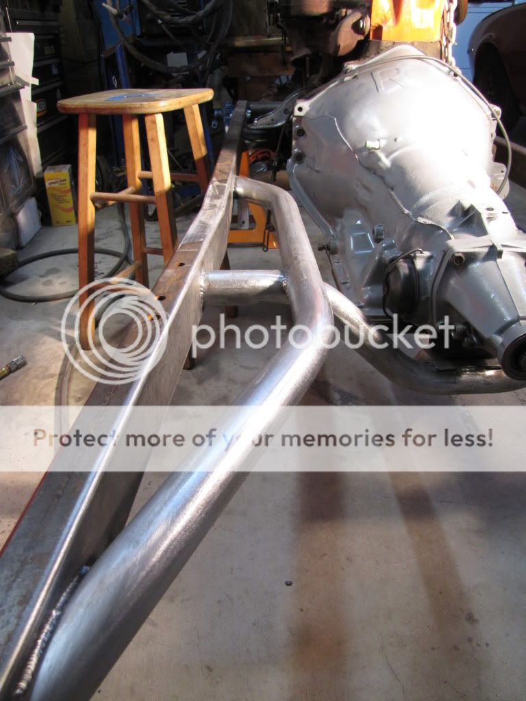

    Next up is the tranny crossmember

  10. Not a huge update but I have been making some progress on the DeSorta Modified after taking a break to visit family in Oregon for Christmas. I have been working on the tranny crossmember and tying in the rear suspension. Mike and I opted to use a crossmember from Speedway with a 6" drop. Once that was cut, positioned, and welded in I bent up some 1.75" tubing that I tied into it. We will then mount the rear ladder bars to these tubes plus it sure strengthens up the frame. It is always fun working with tubing. A lot of different angles going on here. I didn't take any "in progress" photos but here is how it came out.
    http://i1231.photobucket.com/albums/ee520/bryantcustomcycle/DeSorta Modified/IMG_3356.jpg
    http://i1231.photobucket.com/albums/ee520/bryantcustomcycle/DeSorta Modified/IMG_3353.jpg
    http://i1231.photobucket.com/albums/ee520/bryantcustomcycle/DeSorta Modified/IMG_3352.jpg
    http://i1231.photobucket.com/albums/ee520/bryantcustomcycle/DeSorta Modified/IMG_3357.jpg
    http://i1231.photobucket.com/albums/ee520/bryantcustomcycle/DeSorta Modified/IMG_3365.jpg

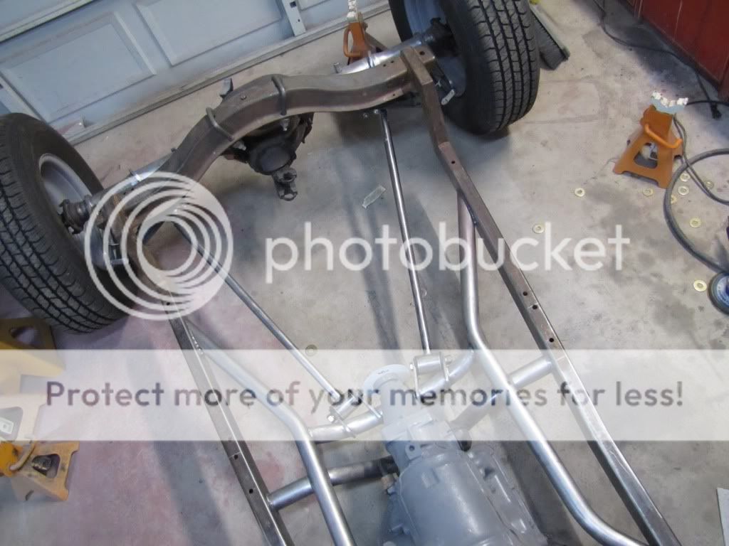

  11. Well it has been a busy last few months here on the ranch. We have been busy buying our first house and then I have been tied up working on a few off topic cars. Just recently I got back on Mike's modified. The next step in the build was bringing up the rear suspension. The plan was to mount a Model A style spring in front of the rear end. So I started by making the mounts for the rear spring. I started with some 3/8" steel flat bar.

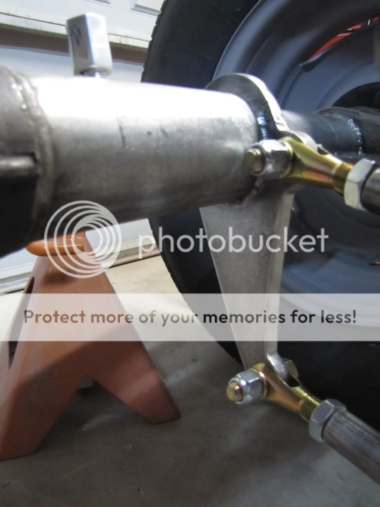

    Then I started building the mounts for the rear ladder bars. Still to be smoothed out at this point.
    http://i1231.photobucket.com/albums/ee520/bryantcustomcycle/DeSorta Modified/IMG_3700.jpg
    The rear ladder bars tacked together. We used 7/8" .156" wall DOM steel tubing. I had a local machine shop tap one end of each of the tubes for the clevises we would use to mount them to the ladder bar mounts. You can see I am using the ol' drill bit trick to make sure I have the gussets centered.

    Welding up the front mounts for the ladder bars. Sorry about the mess everything is getting packed up for the move.
    http://i1231.photobucket.com/albums/ee520/bryantcustomcycle/DeSorta Modified/IMG_3750.jpg
    Rear mounts all smoothed up and welded in.

    The front mounts along with my fancy homemade slip joint yoke.
    http://i1231.photobucket.com/albums/ee520/bryantcustomcycle/DeSorta Modified/IMG_3747.jpg
    http://i1231.photobucket.com/albums/ee520/bryantcustomcycle/DeSorta Modified/IMG_3744.jpg
    http://i1231.photobucket.com/albums/ee520/bryantcustomcycle/DeSorta Modified/IMG_3749.jpg
    More to come...
