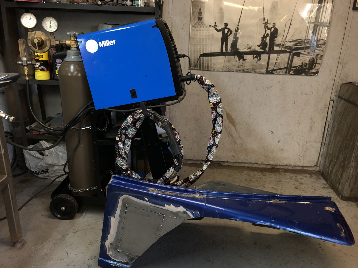

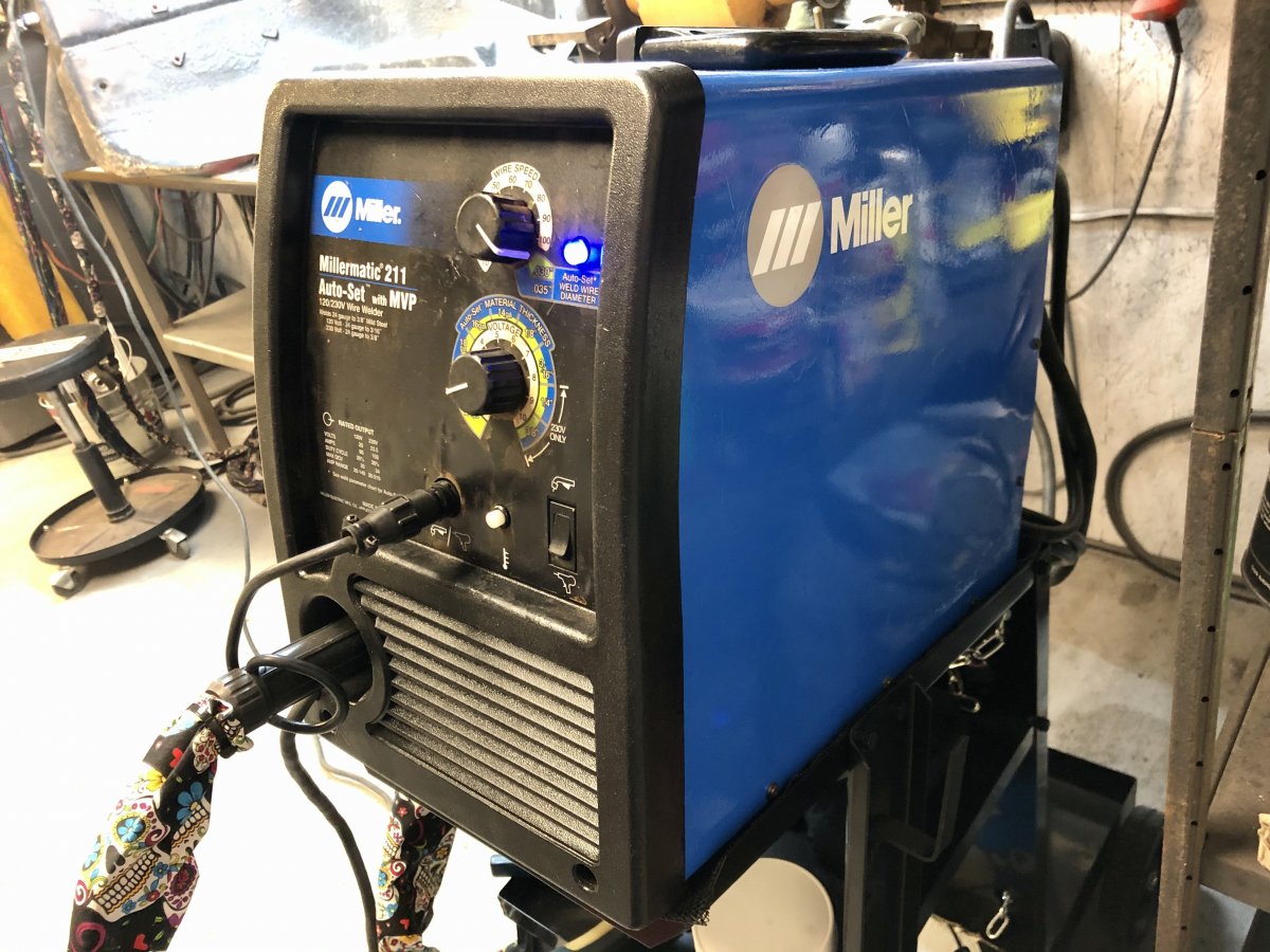

  27. Midnight 50
    Joined: Jul 27, 2008
    Posts: 567
    Midnight 50
    The old Miller 211 loves that 030 wire, which isn’t an option in the poll. It’ll do anything. Currently working on my Jeep CJ doing panel patches.
