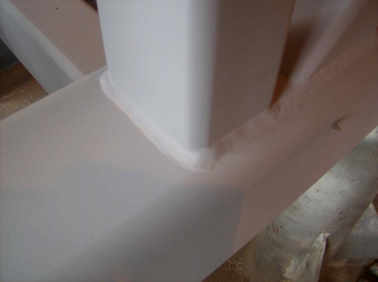

    A photo showing a good GMAW (MIG) weld, sorry about the primer.
    And a photo showing a large crack that resulted from whipping and no it wasn't welded in Mexico.
