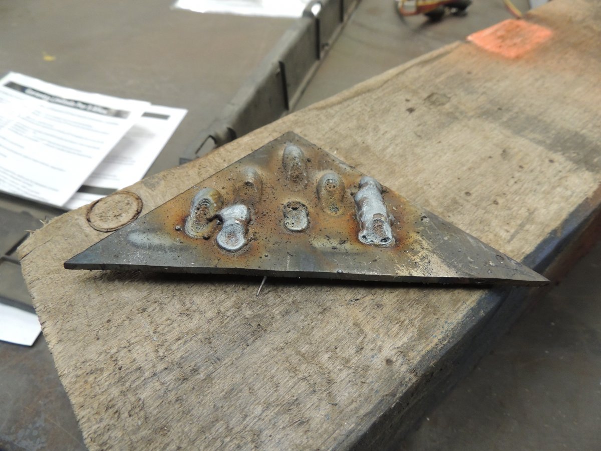

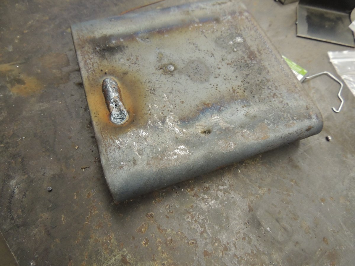

    I have been out in the shop earlier and took a cursory look at the welder. Got the manual out and went thru the set up steps to make sure I hadn't inadvertantly changed something. Tried welding again and had the same problem. Lots of info and suggestions here and I appreciate all the help. I'm tired and don't feel like going back out to the shop to experiment some more today, so I'll try to address the more common suggestions and then work on some of the others tommorrow.
    I don't use flux core wire. There isn't a problem with wind as I'm indoors and not using a fan. I have one of the little round things that you put a special lube on and slip it around the wire. I am not using any magnets. The steel is just common cold roll plate and is clean.Its not a spatter problem as I changed the tip. I wondered if the wire might not be bad ? Something I did notice is that the voltage meter jumps up and down while welding. Usually you have the mask on and don't see what the welder is doing cause you are looking only at the weld. I left my mask off and just held the gun down against the metal and the meter went crazy. Here is what the "welds" look like.

    I don't know what metal you're welding but that stuff looks dirty, something mig welders hate, Take a grinder to that, clean up a nice clean shiny spot and try again. The porosity is gases trying to escape the hot weld, meaning its dirty under the weld. Mig welders love clean freshly ground material.
    49ratfink and doug j like this.
  23. 6sally6
    Joined: Feb 16, 2014
    Posts: 2,467
    6sally6
    Diaphram in the regulator could be bad. Looks to me like you're NOT getting good gas coverage. IF there is paint/rust/oil/do-do/whatever on the metal you won't get a nice weld.
    Looks like the heats good....wire feed good(maybe a little fast)...
    Wipe the metal with acetone or Laquer thinner (NOT/NOT Brakleen!) and try it. If still no joy.....I'm bett'in on a busted gas regulator. (sometimes the chinese prisoners/children do a crumby job of building)

  25. that last bead looks like no shielding gas.

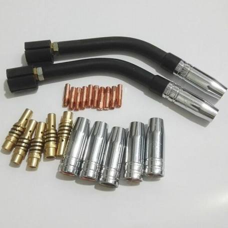

  28. See these brass parts?
    See the little holes in them?
    That’s where your gas comes out into the nozzle cup.
    chryslerfan55 and KJSR like this.
