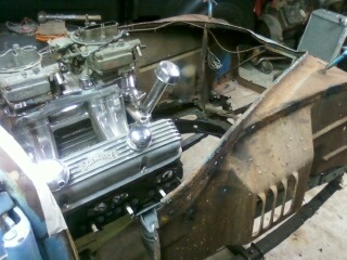

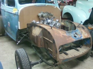

    Today got the old torches out and cut the bolts holding the front clip together, all 15 of them:cool:
    It came off a lot easier than I expected, seeing its been on there for 70 yrs.
    Igot the center section off and set it on the gasser to mock it up and the cool thing is that the bolt holes are all still on the frame, so i threw a few bolts in and here we go!!
    It fits really good, a little tweaking here and there we will be good to go, I will keep most of the inner fender wells, but will have to trim them up for the headers.

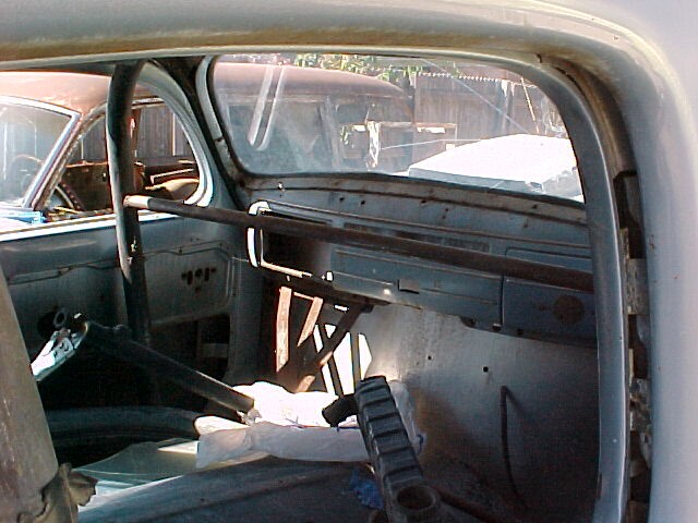

    Question?? ""Willys guys"" I need to remove the dash in the parts car,i see the welds on the sides and the braces but it looks like its one piece with the front window seam, ive never removed one and i dont want to hack it up??

    Hey Vince, your car is coming along great. On the dash where it curves into the top door hinge there are 5-6 welds, and then the braces, but on the top you have to drill out the spot welds if you want to save both peices.
    Good luck, Walt

    thanks Walt, I am going out there today to blaze the torches,I could not see the spot welds, I will have to wire wheel it to see better.

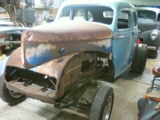

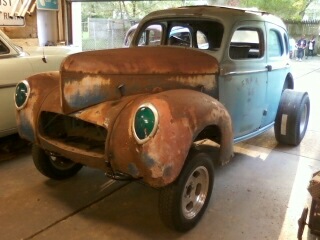

    heres a few pics from today, bolted the fenders on today to see how it would all fit.

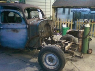

    short update, haven't done to much in the last couple months, working 6 days a week and raising two young ones.
    So heres were im at, I was having a problem with my welder, and was not happy with the way the welds turned out, so i cut out the roll bar :eek:
    Now plan "b" a local friend with a shop is going to do it, i talked to him today, he wont be able to start to after the new year so, now i have time to finally pull the rear end out install the new 3rd member, put new seals and axle bearings.
    Ive been collecting alot of parts and have just about everything for the car, so i will be posting more pics as i go soon.

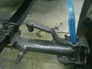

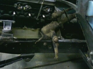

    started messing around with the steering today, its going to need a total make over.
    I don't even know how they ran this thing at the track, the gear box is mounted a foot back from the org. mounting holes were the frame starts to kick out so its on an angle.
    The spindle was heated and bent up to deal with the 15 degree caster, im trying to save as much of the old stuff as possible, but might change the whole setup and put a stock willys axle under it????:confused:

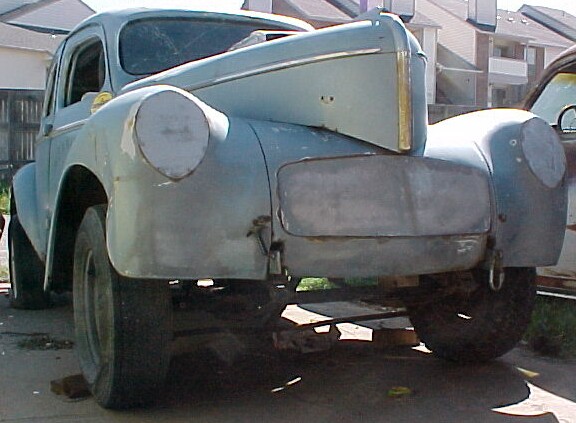

    Went back and read your updates. Interesting that you say you found dark green paint somewhere. I never had sanded any of the blue down to see what was under there. I'm going to post a photo, not sure where online I found it but I marked it as 1970 Souix City.
    The roll bar either isn't there or isn't mounted as far back in the picture and the steering looks like it is in the stock location. It COULD have been our car before an engine setback and the flat aluminum firewall. Don't know if you got the one I took out. Boy was it flimsy.

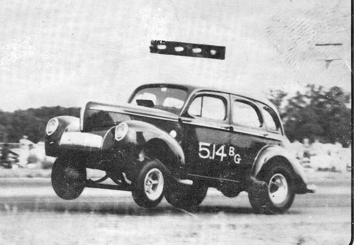

    g-willys heres the gasser gossip pic you were talking about, this car is what got me into the 41-42 sedans!
  25. 37 Willysgasser,
    That's the one!!! Maybe someone can find the yellow version that was on a cover of Street Scene about 20-25 years back! I thought I had it, but can't find it. I did put your picture and the one Cougar Dan posted in side by side tabs, and something showed up that makes me think they are the same. If you look at both you will see that they both have that chrome-like fender welting that has been around through the years...coincidental ??? perhaps, but they do look like the same car .
