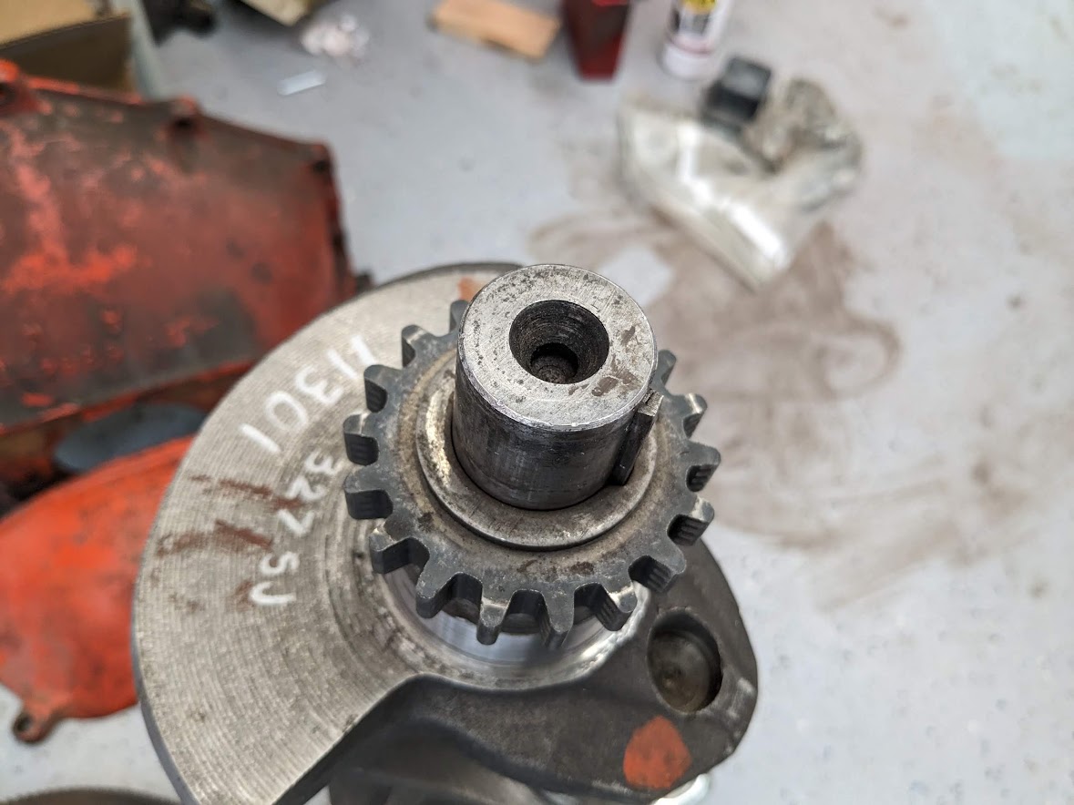

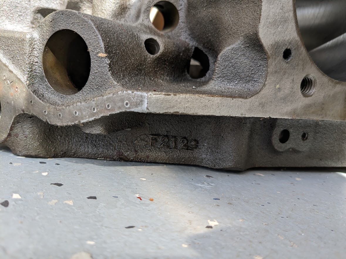

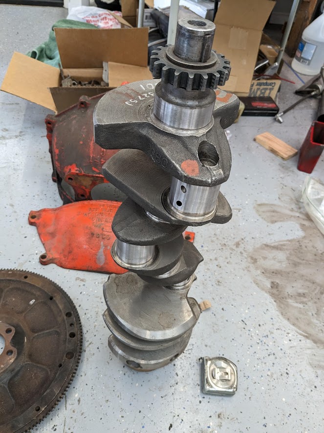

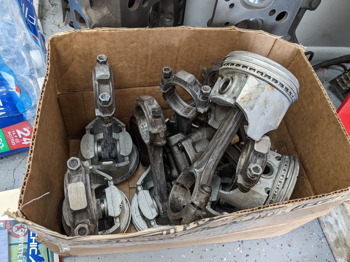

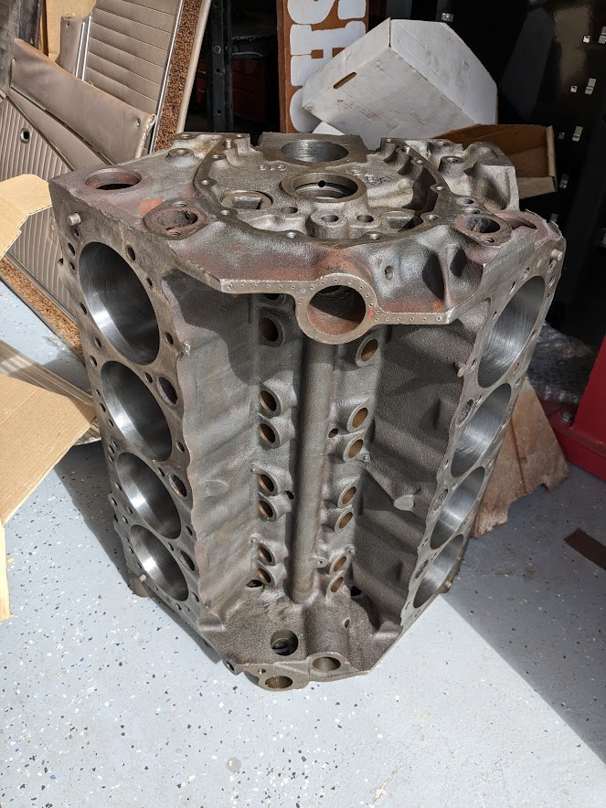

    The engine. Looks like it had been rebuilt before, with .030" pistons and .010 under crank. The block was bored and honed to .040, and includes a new set of cast flat top pistons. I still need to clean it and install cam bearings and freeze plugs and oil plugs. It has the right date and stampings to be in a different 62 low perf Corvette, but one with a 4 speed. The partial VIN is from very late in the production run, July 1962, while my car is early in the production run, Sept 61. Which is interesting, but doesn't make any difference in how it drives, I don't expect.
    The heads were done, new valves, springs, and PC seals, along with screw in studs (which I like). The valves sure are small! since they're power pack 1.72 heads.
    Crank was polished, still .010" under. No tapped damper bolt hole in the early 327s apparently!
    I think I want some new rod bolts, and resize the big ends.

    Yeah, that block is from a very late car. About 215 from the end of '62 production. Started life as 250 horse with manual trans. FWIW the solid lifter engines were drilled and tapped for a damper bolt.

    Interesting, the cars build date is likely July 25. Yet the dif build date is a month after the build of the car August 25. The CA build prefix is appropriate as Detroit axle open 3:36 installed in a Corvette. The 3:36 ratio tag agrees. There is a casting date on the drivers side face below the tag.

    The car build date is late September 61. The engine number is not the serial number of the car, it's a different engine than came in the car originally.
