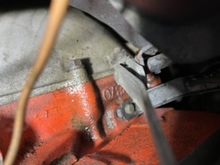

    Jim are you up for looking at some more engine stamps on a C1 62?
    I will post them on the C F it is easier to down load
    Thanks

  16. 427 sleeper
    Joined: Mar 8, 2017
    Posts: 2,689
    427 sleeper
    You have a highly desireable block! Fuelie with a high lift cam!!! That's if it has a '62 casting date, or even a late '61casting date!
    Built at the Flint plant on January 12, 1962! RF suffix is a 360 hp, M/T, high lift designation.

    Based on the front motor mount and bolt seems probable from the photo that this engine is in a first generation Corvette. Likely not an orphan. Is it in the car it was born with?

    The last F looks kind of suspicious....like it might have been messed with. If it has been redone, it's a pretty decent restamp. If it's real, then it's the 360 HP engine, and if the partial VIN matches the car it's in, makes the car worth a lot more. So you have to be pretty careful...there are guys who are pretty good at figuring out if it's an original stamp or not, but beware there is a lot of fakery going on. I'm not good enough to tell if it's real or fake.

    It looks to me like it has the original deck machining lines, but after looking close at that last F you're right it's not only slightly different but also sits higher. Could someone along the line have added the F to an R suffix? It would still be a 1962 327.

    Yup, I agree, the deck broaching looks legit but that last F is sure a phoney, shaped differently than the first one and the lines on it are wider....

    GOOD EYE'S, Gentelmen!!! If the last "F" is fake, and added, that would make it a 250 hp, M/T passenger car engine

    Upon further review, that last "F" looks fake. Starting to look more like a 250/327 w-M/T. Oop's... My Bad...

    These characters aren't stamped with the same stamps, like a typewriter. In my somewhat limited experience in production machining, we loaded a stamp holder with the part number we were making and stamped them all at once by hitting the stamp holder with a big lead hammer. All the individual stamps did not necessarily match exactly and some were duller than others. I'm not saying if this one is legit or not, just passing along some info.

    Yeah, they're not perfect, but an original stamp is pretty darn consistent from one end to the other. This is the stamp on mine, it's the low perf engine, so it's not one that anyone would bother forging.
    The last letter has the same depth and size as the rest of the characters.
