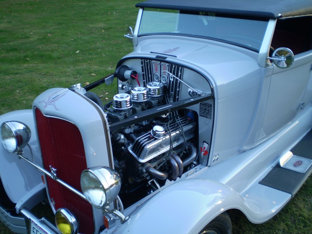

  1. The only pic's I have on my roadster but the hood is held on by the lip which fits under the bars that run from grill shell to cowl and then pinned with a small hitch pin from the inside. Solid as a rock at 70 M.P.H.!!
  2. Here's a pic of the hood closed , the straps were just for looks. done in new paint 005.jpg
