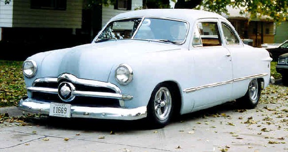

  15. I know guys have used the Mustang tank but it has a filler at the back of the tank...gotta open the trunk to fill it. The Fairlanes and comets also used a drop-in tank with the punched flange around the outside edges, like a mustang but had a side-inlet filler.....you can re-use your original '50 filler if you want.
    I used a 66-67 Comet tank in my 49 coupe but hated the original 49 filler...I ended up filling my tank from the trunk.. and filling the hole in the driver's quarter panel for the original oogly 49 filler.

    kursed56
    Rocky, mind filling me in on what you did to get your box to sit down nice and low like it is?
