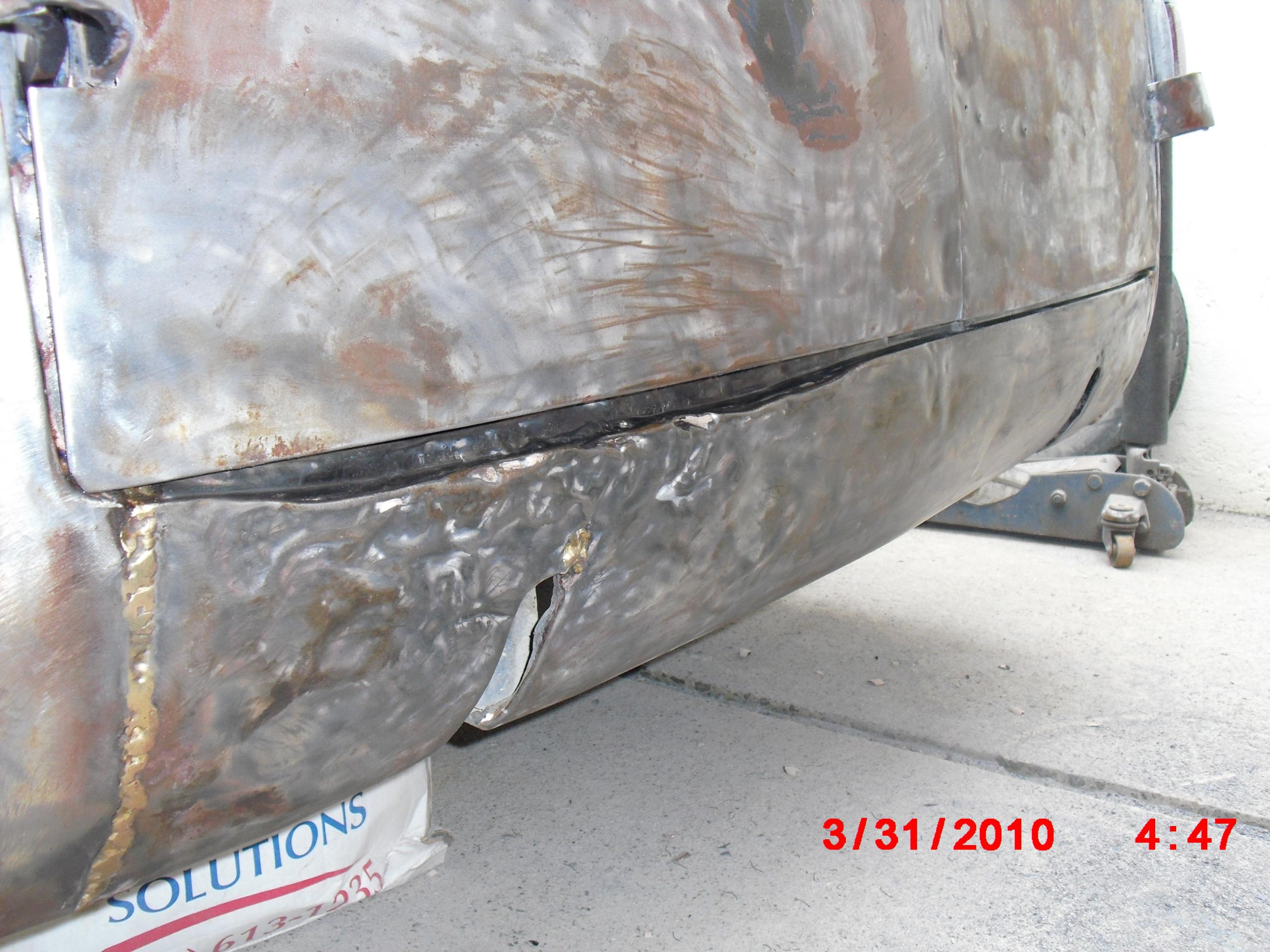

    There are plenty of threads already covering this, so a search and learn a bit. Metalmeet and a few others also have detailed threads on how and what your going to need to do.
    Techniques vary according to how you put the patch in and where the welds are in relationship to the inner structure.
    Post up a couple pics from inside and out of what you've done and we would be glad to help you make it worse.... :D

    I think I have the skills needed to make it worse on my own! I just had to jump into it knowing that there is a steep learning curve with this art form. I am not looking for perfection (well, I am really) ,but know I cannot attain it. I will not post pictures of my attempts because of my pride! I will post some photos of the next section I have to repair and ask for advice on this area before I start it. Hows that?
  30. sr
    Joined: Feb 12, 2007
    Posts: 387
    sr
    from Monterey
    The rear lower panel area will be my next area to repair or destroy with different techniques. This was filled with bondo and shaped very well. You would not know it was injured unless you looked underneath. This is going to be my bonneville tow rig, so bondo and salt and water would make this area bad in no time.
    The photo of the side panel with the window cut out is before I did a patch. You can see how they stretched and banged the sheet metal all around it. Compound curves around and much damage. I trimmed out the hole into better metal and used sections from a 56 ford hood for the patch. Maybe I will get the nerve to send those photos. I will take photos of the before and after I do some stretching and shrinking of the patch.......maybe.
    You can see the before photos. Then I removed 300lbs of bondo! I have learned to never trust a seller UNLESS you have touched and felt the vehicle you are buying or trading. Ouch.
