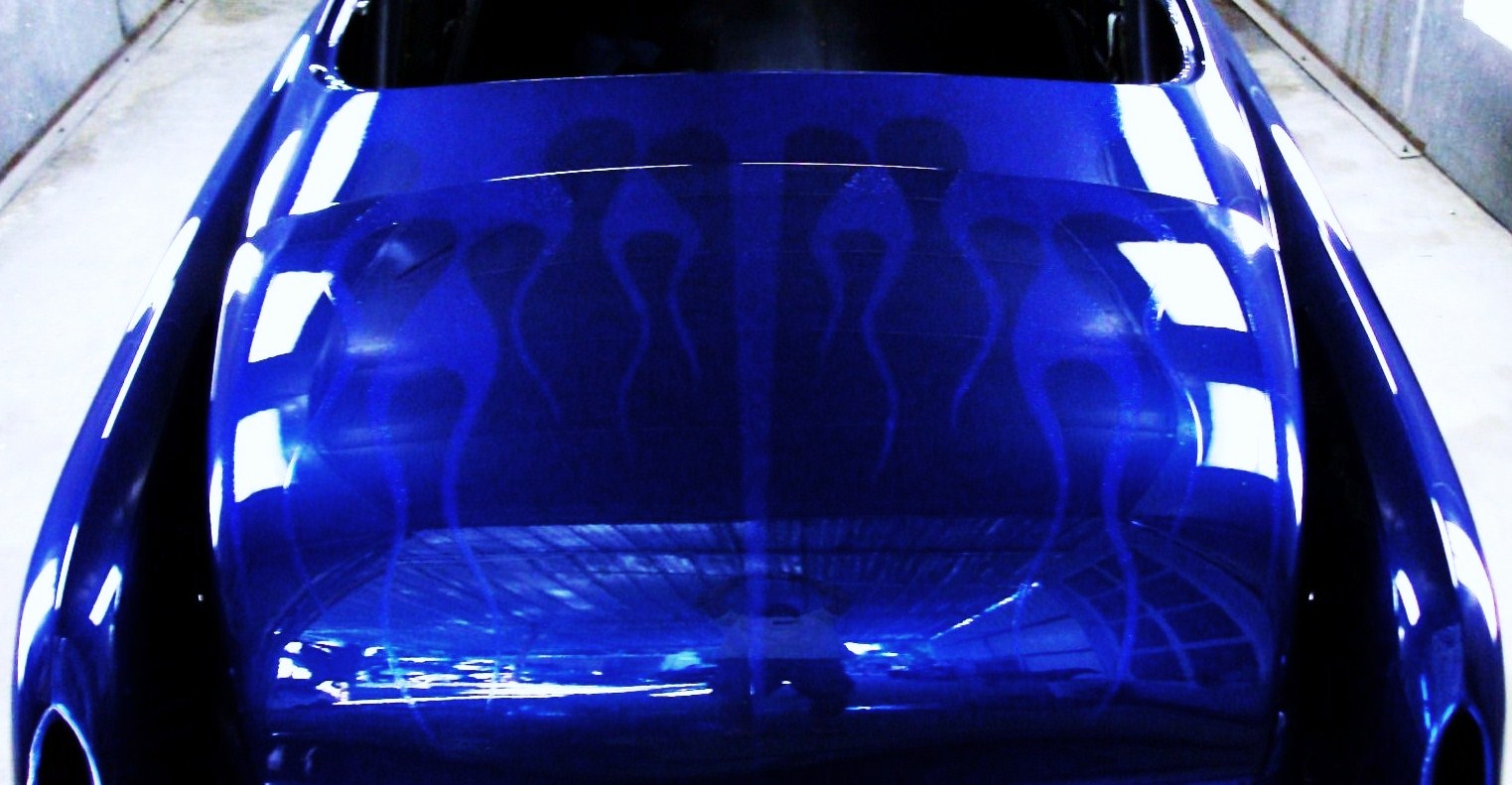

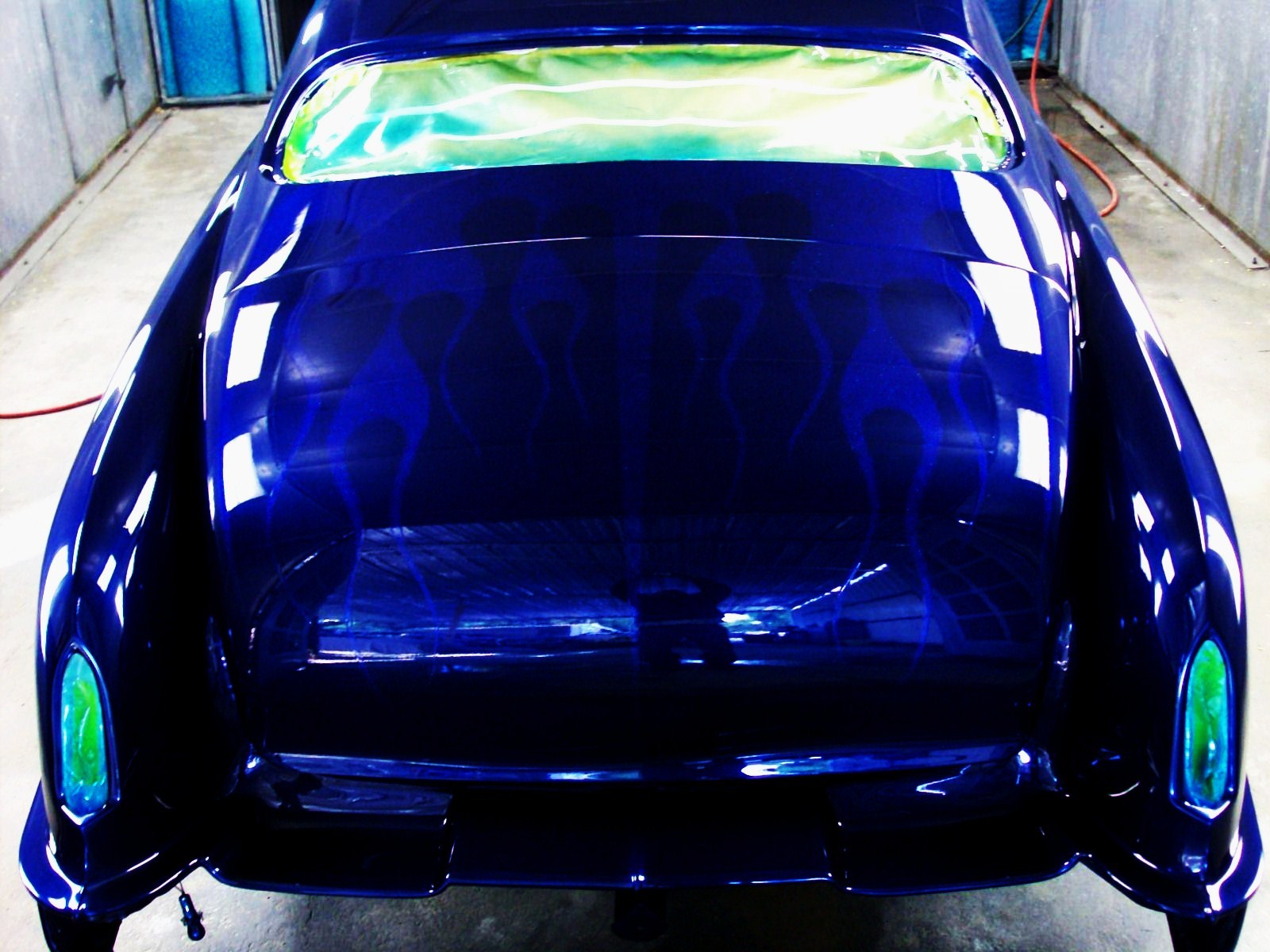

  1. Here is a sneek peek of the paint work on Tim's 51 Merc. He orginally wanted us to paint it boring black :( but the kustom bug has bitten him and he has changed his mind :D:D. We based it all in gun metal black then coated that with a mix of blue, green and purpel pearls that will be top off with a few coats of blue candy but before we do the candy we needed to do the flame lay out. We painted the flames in metal flake with a mix of colors gun metal, blue and purpel & sizes sm and med. The flames will be a mild gost but they will just out at you in the sun light.

  7. Got a few coats of inner candy and one coat of shinney candy to check for color evenness (dark or light spots. It came out great so we can now due a few more shinney candy top coats to add a little more depth to the candy affect.

  26. Heres a little up date. Just layed down 2 coats of the outter shinney blue candy and one coat of clear. As you can see the flames are not a true ghost. You can definitly see them even in low light but i bet you will see them big time in direct sunlight
