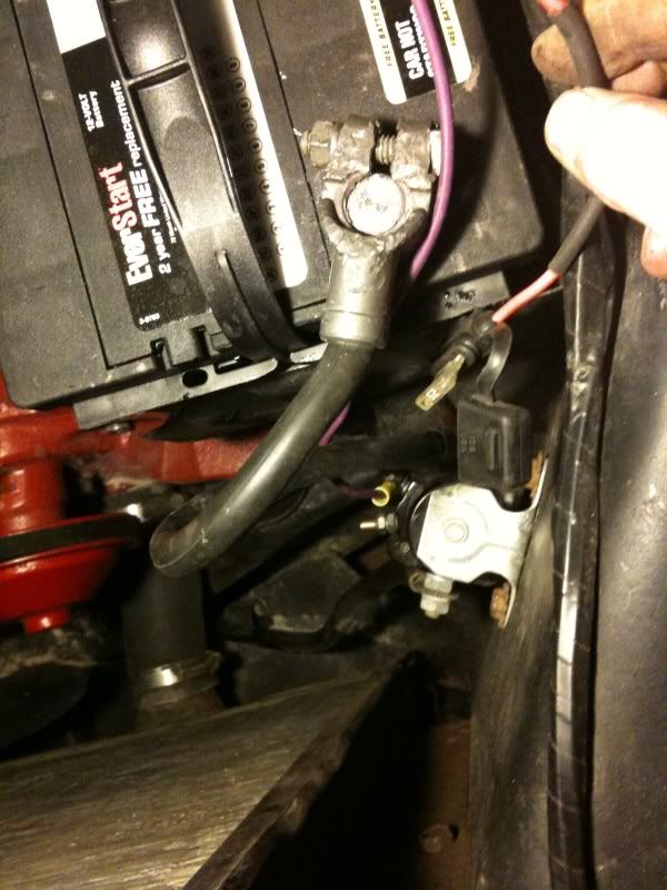

    okay guys thanks again for all your help. yesterday I got the new spring installed on the starter, I put back original carb and she started right up:) idled and ran. Then another issue!!! can you believe my luck :( my fuse link popped. So now I'm at a loss for words. I had a 30 amp fuse in line on the wire from starter button to solenoid as the orignal wiring harness' fusable link burned up. It only pops the fuse when you rev the motor as you rev the motor it pops. It was running fine on the 30 amp fuse before. Do I need a bigger fuse?

    You got a Gen or Alt? If that fuse is in the output of the Alt/Gen to the battery it WILL blow when you rev it up if the battery is the least bit low. A fuse and a fuseable link are NOT the same thing . You will need a 50-60 amp fuse there if you are running a Alt. , better a piece of 14 Ga true fuseable link wire. Even back in Gen. days when they had a fuse mounted on the volt reg they were 40-50 amp rated.

    JohnEvans: I have a ALT. I converted the car to 12volt, new wiring harness, and so I used an alternator.. Originally where that fuse holder was there was a 14Ga fuseable link. It smoked and burned up and thats why I installed a inline fuse holder. So could it be that the alternator that I'm running is pushing too many Amps? I can't find a short anywhere. It only blows when you rev the motor and the 30 amp lasted till last night. Wonder if I should install another 30amp or go higher. Recommendations?

    Sorry to sound so dense, but if I'm reading correctly, you stated that the fuse was in the line from the starter button, to the solenoid.:confused: If that's the case, the only time there is power on that line is when you push the button. After it's started, reving it up wouldn't make any difference, as that line has no power on it. The rest of the explanations, and thoughts sound right on the money, just not on that line.:) (Looking at your pics, it looks like the big red line with the fuse holder is the charge line from the alternator, or the main electrical supply to the fuse box. The purple wire looks like the starter button to solenoid.) Being confused:confused: makes me crazy. Please straighten me out here!!!!

    You need to know what the output of the Alt is to properly size a fuse/fuseable link . Fuseable links are a bit like slow-blow fuses ,will take a bit of overload for a short time. I would try a 12 Ga fuseable link if you blew a 14 Ga one. The regular fuse is not a good thing to use for this app., taking full output of the Alt. through it.

    32 Your right the wire in question here is the supply from the alt. JohnEvans got it right on the money! The fuseablelink that came on the harness was burned out probably from the fact the Alt. Is putting too much for it to handle, I'm gonna try and see how many amps this Alt is pushing and then remove the INLINE 30amp fuse and solder in a 12gauge wire like suggested. I just drove the car about 20 mile round trip and it ran great no issues, this is after recharging the battery and a new 30amp fuse installed... Thanks again for Everyone's help!! Much Much appreciated !
