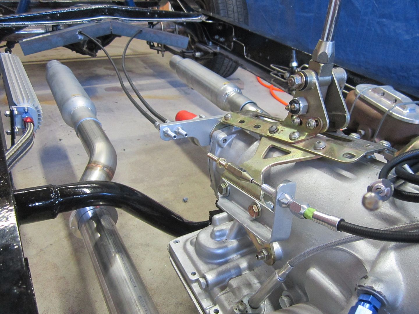

Just bought a set of 17's (steel packed) for my worked over 292. The gal I spoke with recommended longer ones as she told me these would be pretty loud. [/URL] [/URL]
Looks like a nice build there Paintman. What is the difference between the Glass and Steel packs...is one louder than the other?
