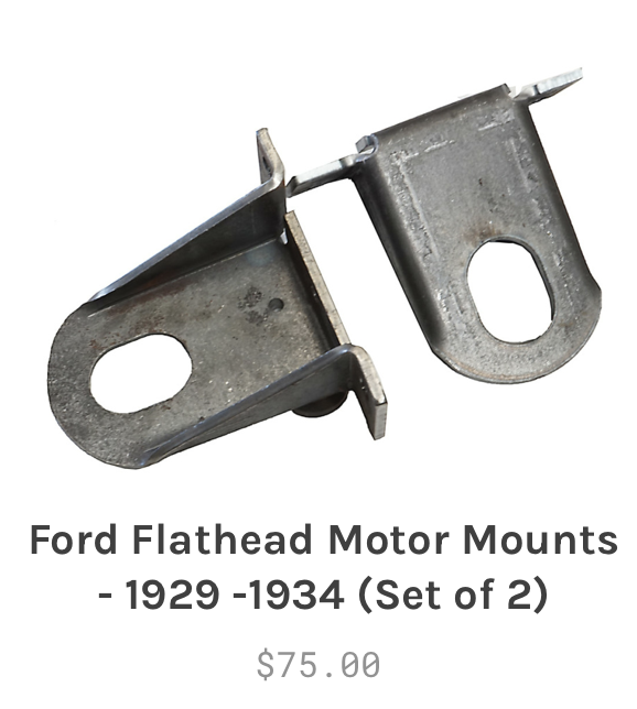

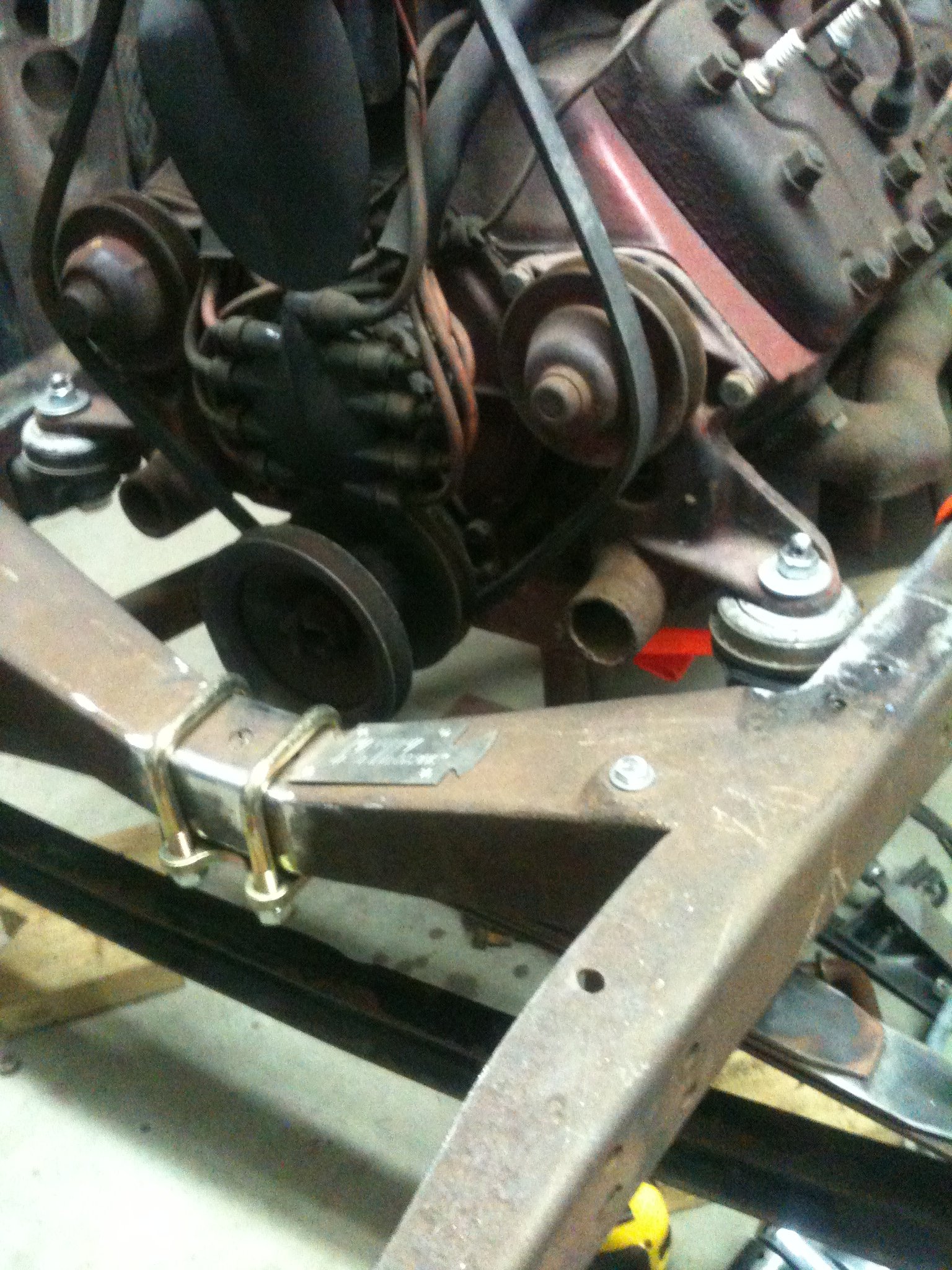

  8. I am beginning to think that I just dreamed I saw a repro front crossmember that was designed for the stock '32 motor mounts. Getting old will cause that. I sold the last V8 flathead powered Model A I owned in about 1965. Having said that, I believe most of the guys are using a mount that attaches to the frame (I think using the shock mount bolt holes) like in the attached photos. These should work with your 59A water pumps. The ones I show are from Vern Tardel but I believe there are a lot of choices out there.

    something like these were the plan. I saw on another thread that they should be also supported/welded to the front crossmember to distribute the weight and lessen any flex on the frame.

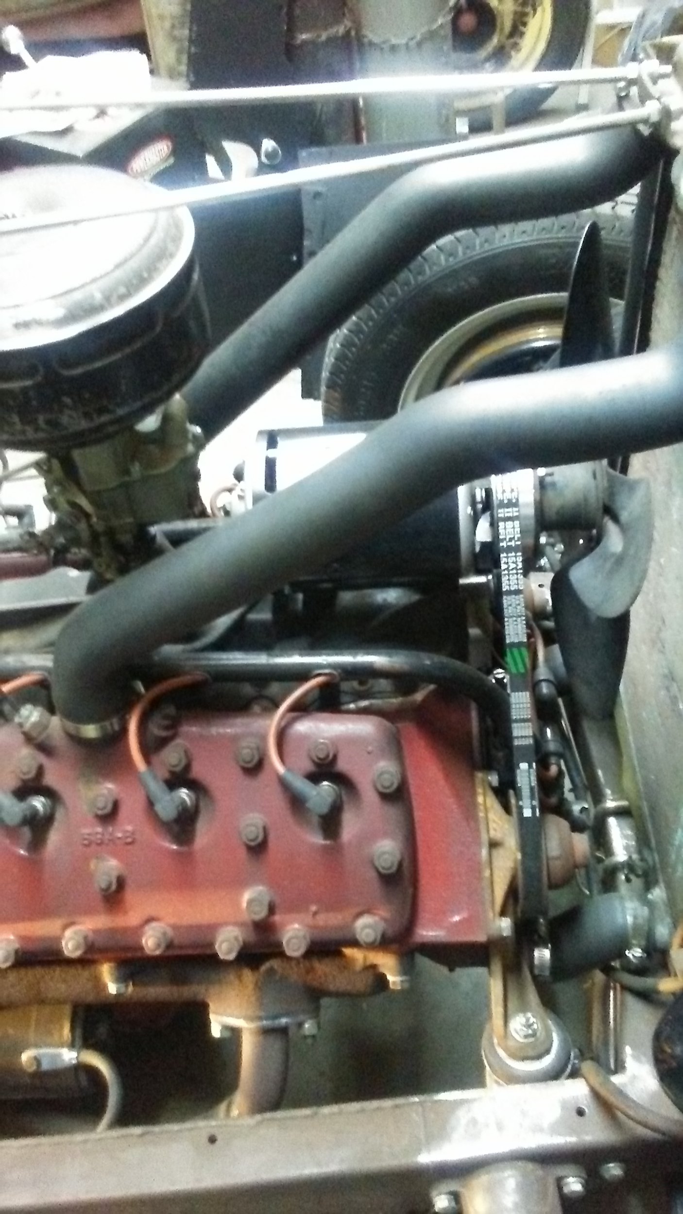

  10. Here is mine, FWIW.
    59AB, frame motor mounts because of PO’s repro front crossmember, stock pumps, stock fan with adapter, but PowerGen faux generator. Stock, but boiled out 32 radiator. Runs cool.

  11. alchemy
    Joined: Sep 27, 2002
    Posts: 22,246
    alchemy
    Mine looks basically like that ^^^, but I didn’t have a 32 fan so I needed to make a spacer to get it closer to the radiator.

    nice setup. ill do mine the same. thanks for sharing the pics!
