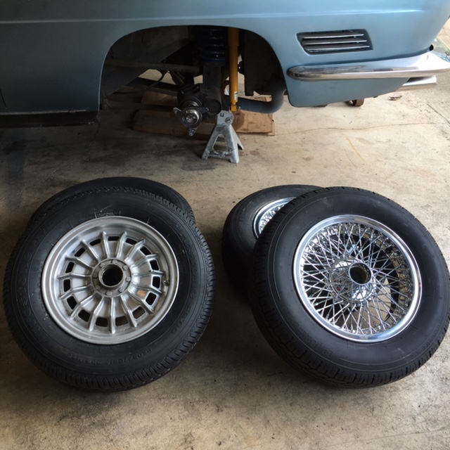

  4. I used tubes and some wheel liner (Rubber-bands) on my Borranis when I put on the Pirelli radials.
