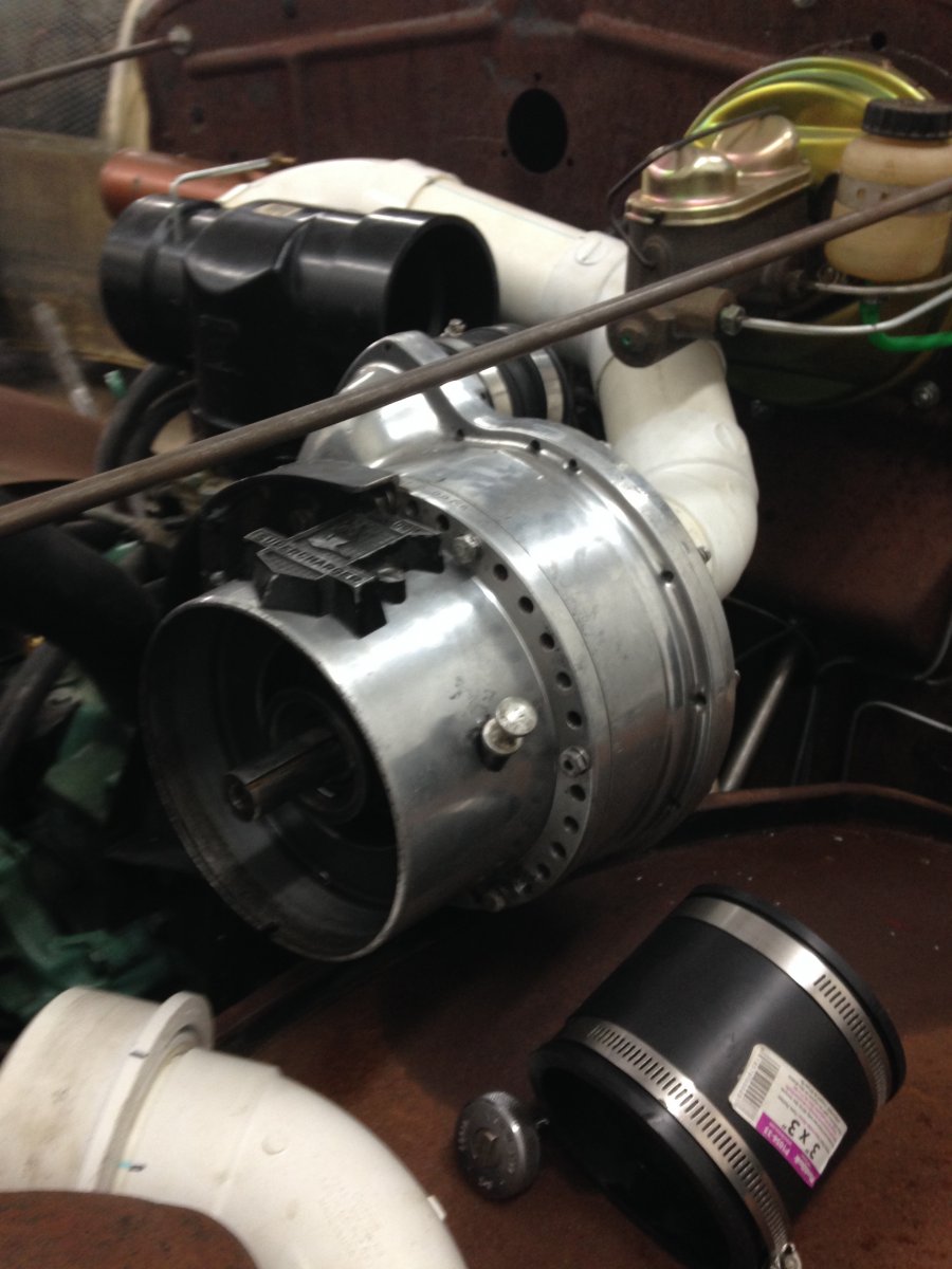

    A friend of mine had one on his 350 rat Rod. He used PVC pipe connected to the carb
  20. RickMur
    Joined: Jul 30, 2017
    Posts: 4
    RickMur
    Hey Dean, don't go giving away my light weight supercharger secrets
