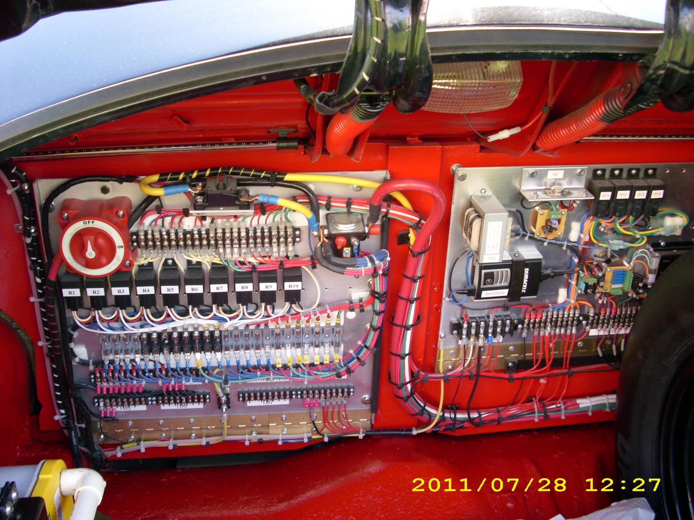

    Ah, my favorite part of a build. Can't help myself, I have to post pixs.
    As one guy said you don’t have to do something just because you can, but it sure is fun! Probably better to keep it simpler.
    First pic is in the rear floor of sedan del project and second pic is my current project, Intrepid seats on Caravan seat base with drawer (not worth the work). :)
    [​IMG],[​IMG]

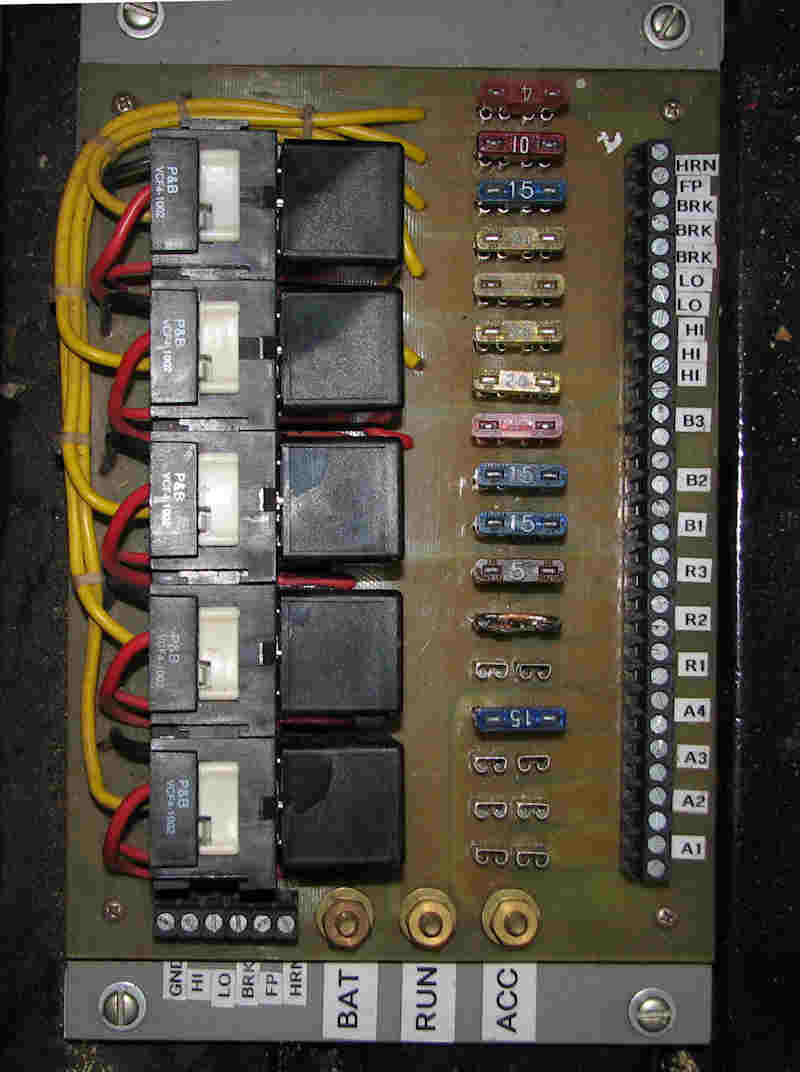

    I did this one because I wanted relays and terminals that would connect directly to wires without separate crimp on terminals. After working in electronics I was familiar with constructing printed circuit boards and knew what I wanted in the way of terminals. Not practical for most but gives you an idea what is possible.
