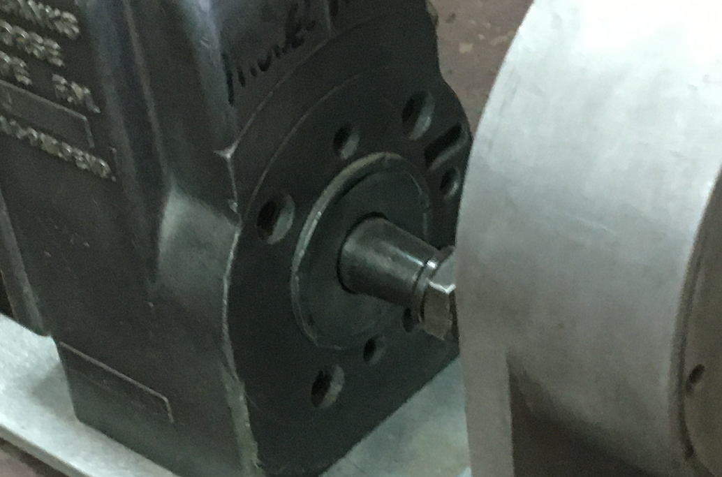

    possibly putting the picture up may help you LOL -i`m old and its late here bibby.PNG

    Have you looked at a Woods or Lovejoy 'Jaw' type coupling? Should do the trick I'd think

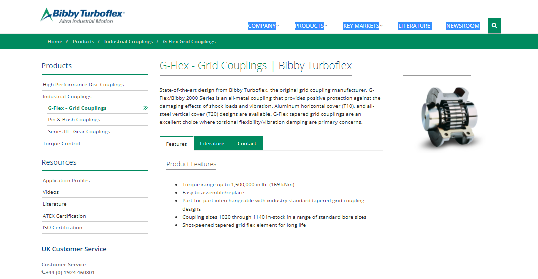

    There is no significant torque being transmitted to drive the magneto. The 1.5 million inch pounds shown above is impressive... but probably a tad bit more than required...?

    It appears to be made out of wood....maybe a cord

  8. I checked out Woods and have previously looked at Lovejoy couplers. McMaster Carr has the lovejoy ones for cheap, but they wouldnt allow for a change in timing right?
  9. Seems those are a bit overkill for my application! Just looking for something simple
  10. winduptoy
    Joined: Feb 19, 2013
    Posts: 3,386
    winduptoy
    Well, I'll admit that there is a lot that I don't know about your application set up or mag you intend to run.
    I would think that the final timing would be set by rotating the mag in relation to the shaft, not the driven shaft in relation to the drive. If I visualize it correctly, you should be able to rotate the coupling 90 degrees for static timing if it is a two ear, 60 degrees if it is a 3 ear....
    The other variable is if you have a flat on the shaft(s) or keyway placed in relation to the drive....and then what terminal you pick for plug wire number one on the mag....
    Seems like there is a lot of flexibility with this style of coupling, like not keying or placing a flat on a shaft and rotating the coupling half for placement prior to tightening the set screws....I would think this is all true to an extent, even for the one you depicted

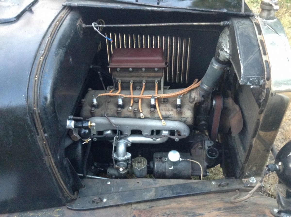

    That’s a typical “Bosch” type mag. Many brands made interchangeable units for many applications, but were all based on standard dimensions. There were even conventional distributor units that were driven off the same base.
    Here is a pic of my ‘ol 27 roadster engine with the Matco mag drive. And yes, I know you can’t see sh*t in this pic. You can just barely see the mag between the oil breather and the fan hub. Drive coupling was 1” radiator hose as stated before

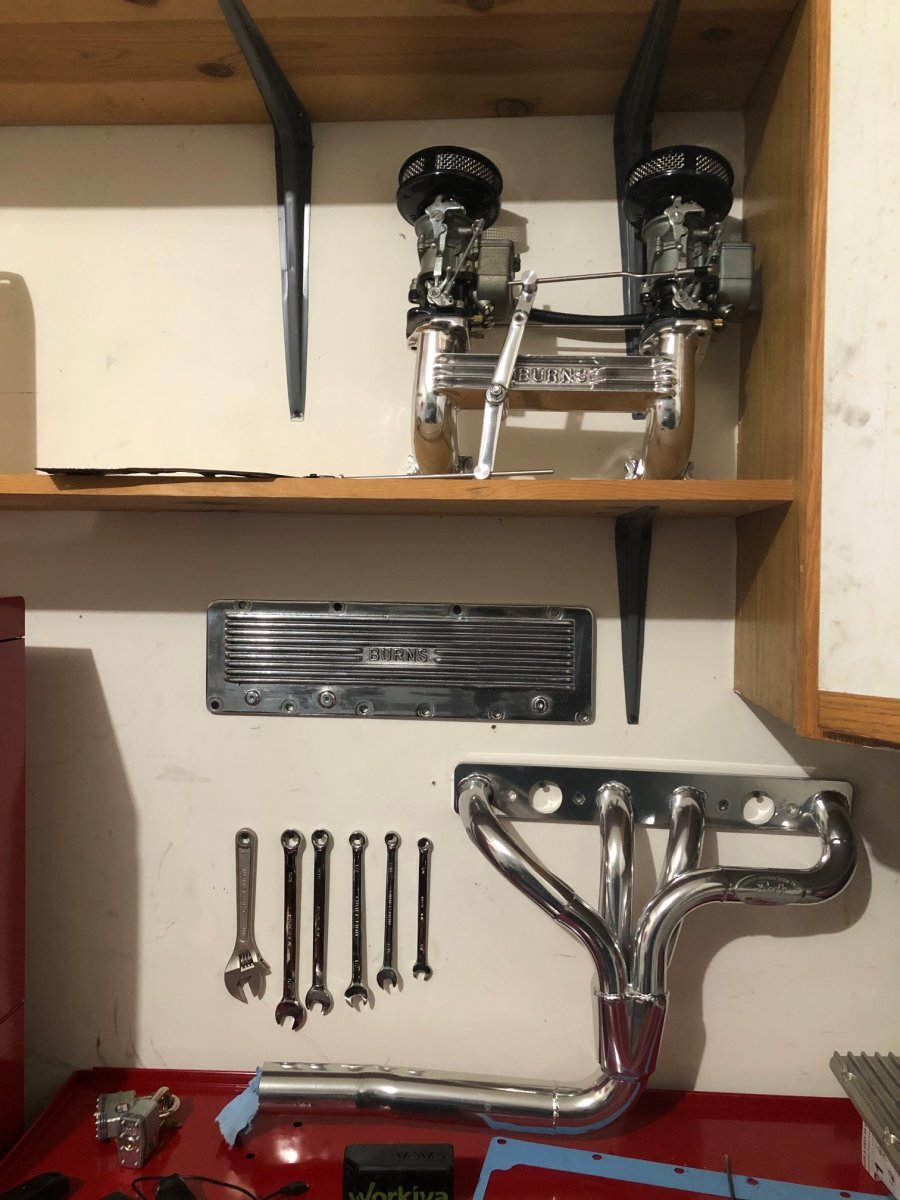

  24. Welp, I've been having fun! If everything works out, I might have a few of these made out of aluminum! untitled.png

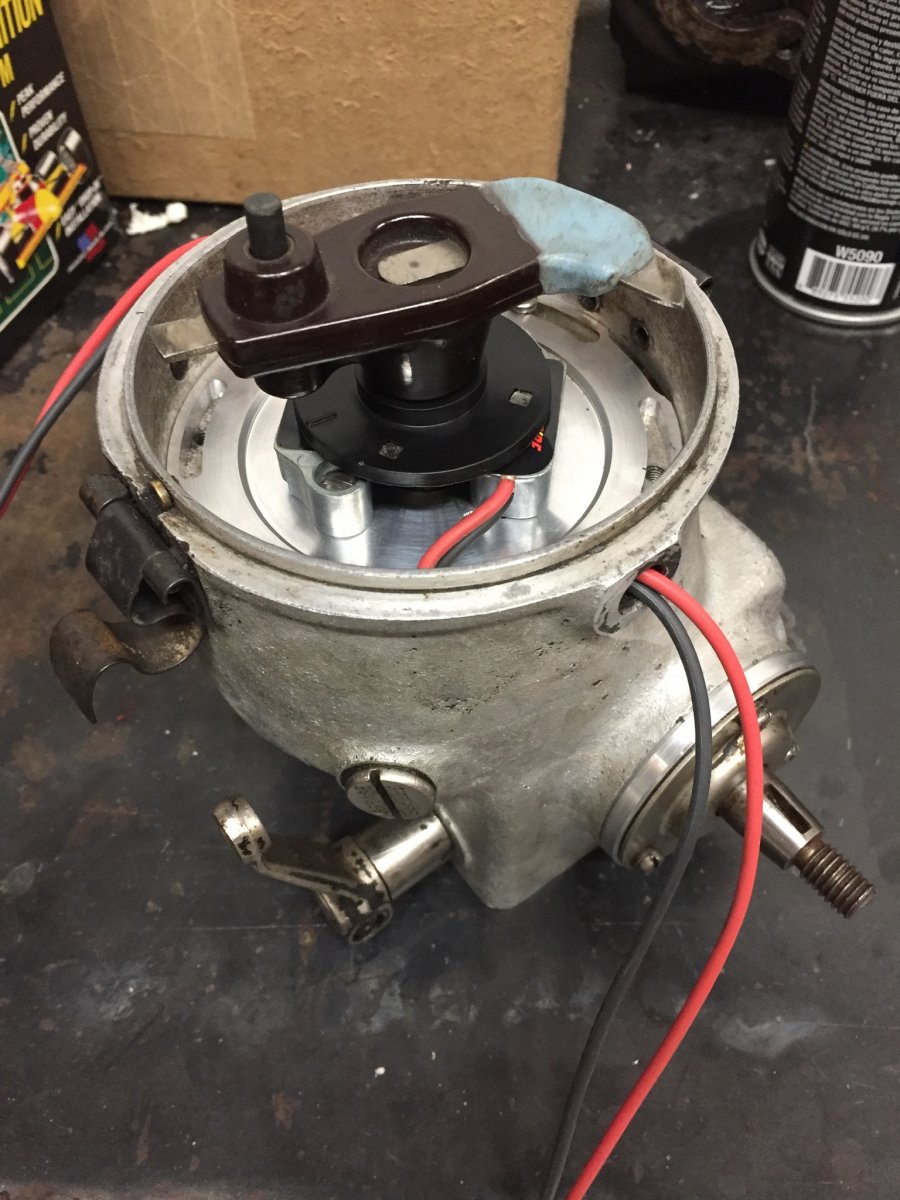

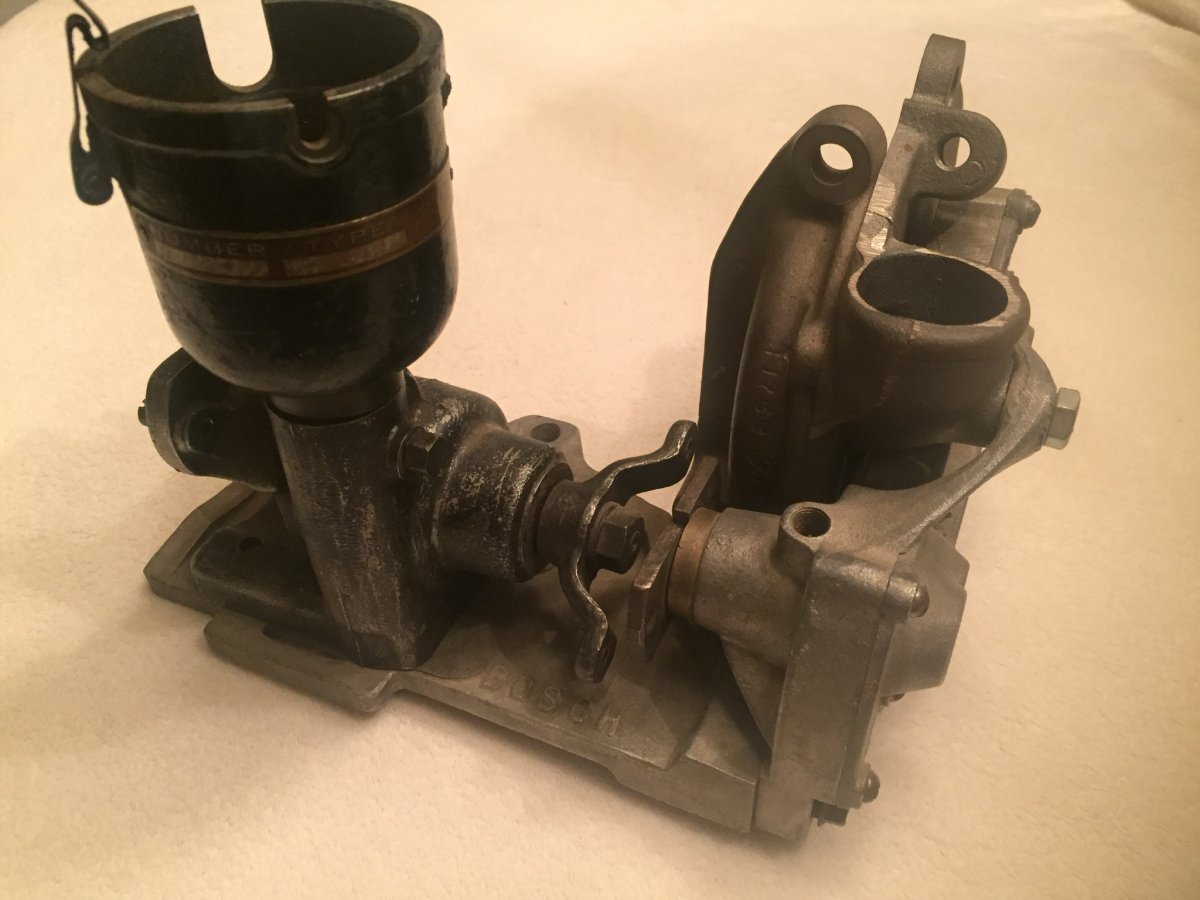

    My dad bought this early, cast iron, manual/centrifugal advance Mallory, Model C 11 some years ago. This is one of the first Mallorys made for the Model A by my understanding, around 1929. My dad rebuilt it, even had a new shaft and bushings made for it, but we could never run it reliably because the unique cap was cracked. My dad looked and never found another. I've looked and didn't find anything...until today. I went to Bert's Model A here in Denver and dug through random distributor parts and found what I thought was hen's teeth. Excited to try it out finally.[​IMG][​IMG][​IMG]

    I have an c 11 and B the c is complete could not get the idle correct. The b is missing parts I worry to send picture ( keep getting errors
