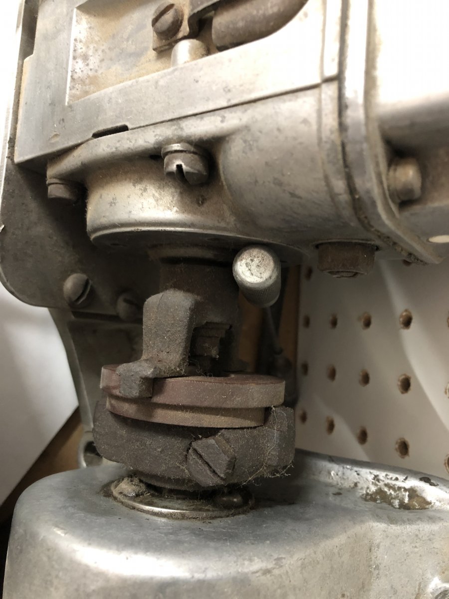

    G_Don

    Joined: May 18, 2005

    Make a tube nut . Bore and tap a piece of solid round bar with a short cap screw welded/locked in the drive end . I wouldn't use a spring washer with a brass nut.
    Old Dawg and Shutter Speed like this.

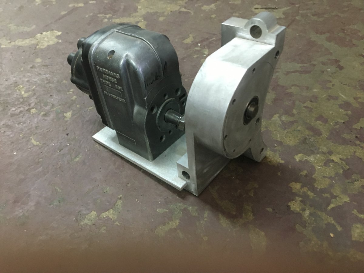

  15. I'll be picking up this magneto drive on Monday. It needs a coupler to join the magneto to the drive. Would something like an "Oldham" coupler work, where it's two hubs and a disk?

    I'm looking at a repop Simms coupler, in UK. Little on the pricey side at £121.87, but I've been told to run something like this for ease of timing. My girlfriends dad is a machinist, I could have him drill the centers to mount on the shafts, but Im trying to figure out how to mount them to the shafts.

    Hi , just at a glance possibly this may work.I worked in the UK oil industry for nearly 40 years and we had couplings of this type that were 30+ years old .If you have a problem with delivery(that is if it is of any use to you) get it sent to me and I will send it on to the USA for you.We had some that were Keyed to the shaft and some that fitted into a dimpled shaft with a grub screw -ran 24/7 for 3 month at a time .
