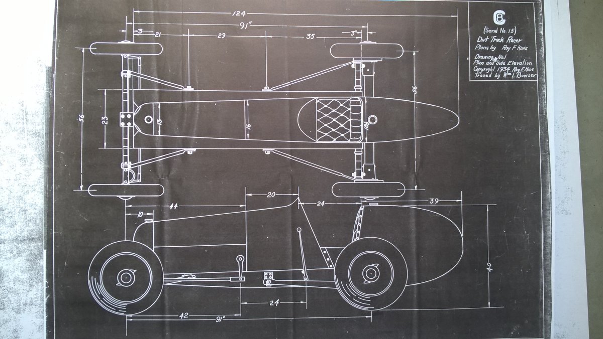

    Here are B/W photos of the blueprints.
    Sorry for the delay
    [​IMG] [​IMG] [​IMG]
    If I were to build this (which is very much like my race car); I'd lengthen the front radius rods back to an attachment near the centerline of the steering pitman arm. I'd also make those front rods "Hairpins" so that the caster is adjustable. If at all possible I'd retain the rear radius rods attachment at the torque tube (at the rear of the transmission). I'd put Houdallie shocks on all four corners, with attachments as far out on the ends of the axles. I'd put brakes (preferably hydraulic on all for corners. newwheels006-1.jpg

    Yes Steve the plans are from Ray ........ JUST LIKE IT SAYS ON THEM. The books came with original blueprints in a folio

    I seem to remember seeing them reprinted in 1001 rod ideas magazine back in the 70s I think.
